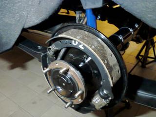

Finished winter cleaning and servicing today with the rear brakes. The '02' was the year the shoes were last replaced, so they have done about 50000 miles - good old asbestos ! The exhaust has been on for about 35 years and is a Langfords. The spring gaiters are leather and have also been on for many years.
