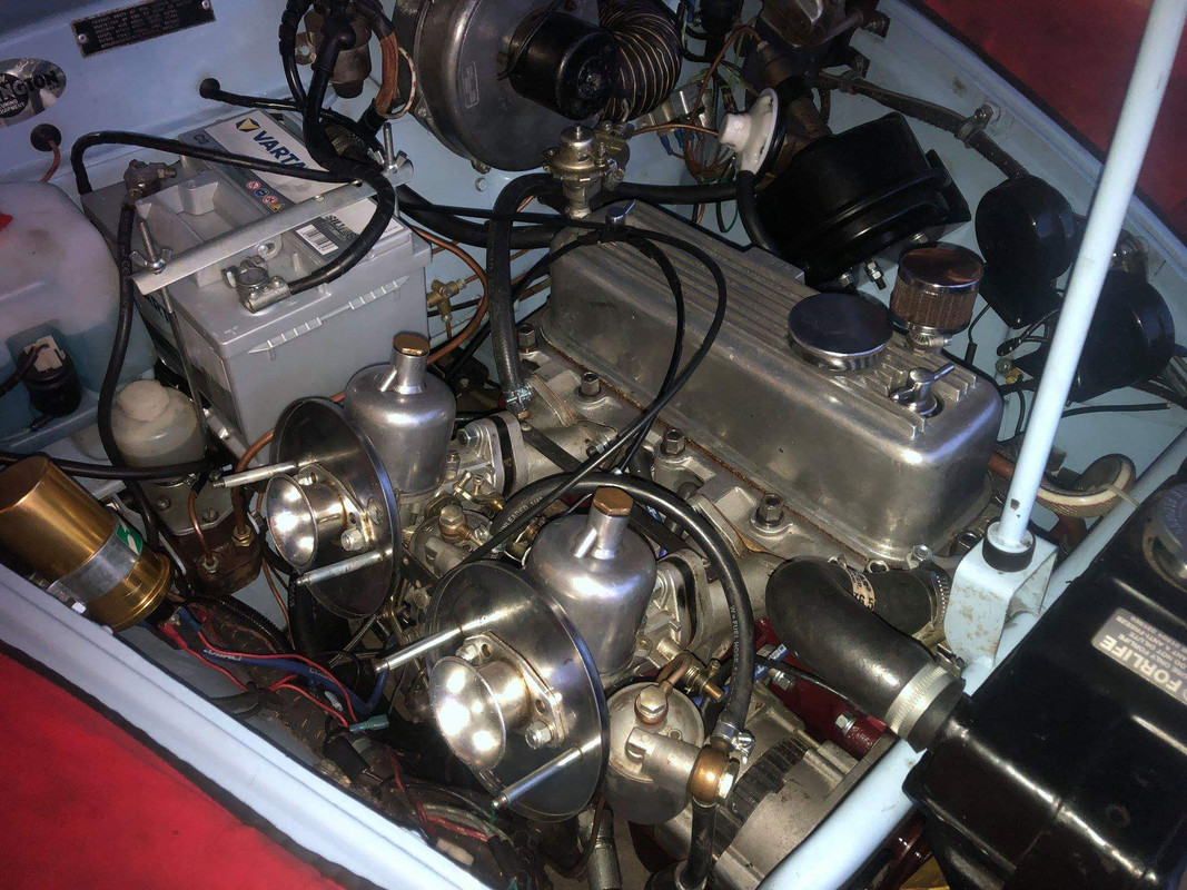

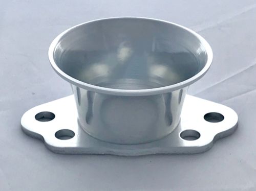

Here's another option if you want to go the pod filter route. This BMC B series engine (fitted with a alloy crossflow head) has 2 ram tubes fitted under foam pod filters. The ram tubes improve air flow into the carb throats. Several versions long and stubby versions are available with/without screens (UK).

Here's another option if you want to go the pod filter route. This BMC B series engine (fitted with a alloy crossflow head) has 2 ram tubes fitted under foam pod filters. The ram tubes improve air flow into the carb throats. Several versions long and stubby versions are available with/without screens (UK). That looks a better option then the current situation. But the distance between the car and inner wing is limited. I am leaning towards an remomte airbox. I'm really wish I could stop tinkering! Electronic dissy, reprofiled Cam, electric water pump, mechanical pump removed, twin electric fans. 20.65 to the gallon on a run. Done 550 m over the weekend. Ran like to Swiss clock.
