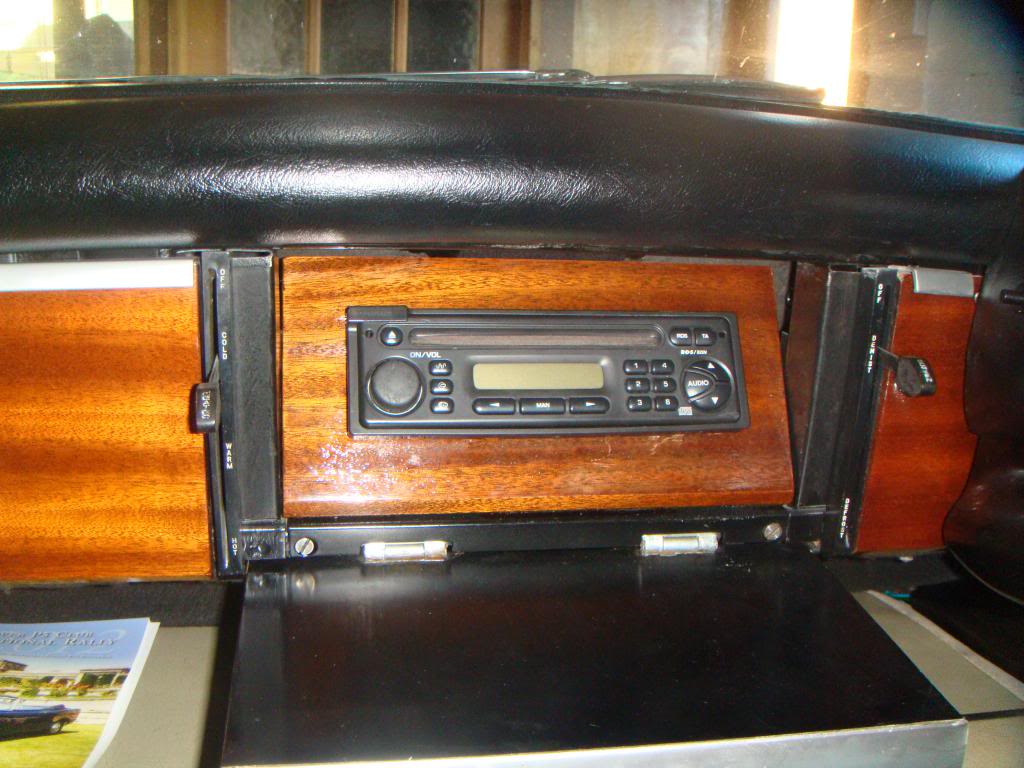

I mounted a period correct AM radio in my 1966 P5 Coupe using the center console piece. I had to make the 2 mounting pieces to screw the radio to the center console.
Post by Ken Nelson on Aug 15, 2019 22:22:22 GMT
Finished product Attachments:

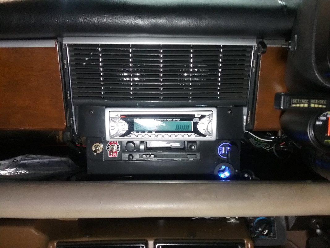

Here's a AM/FM Radio/CD player (in my MK3 Coupe) with a tape deck fitted below and a USB port & 12 volt supply beside it with the blue lights. Rubber caps push into these ports to seal them when not in use. Toggle switches for the Radio/CF player, Tape Deck, USB port, & 12v supply are to the left

I recommend a hidden modern system. You can put the head unit inside the centre glovebox, a pair of slim speakers behind the hardboard at the back of the parcel shelves, another pair of speakers underneath the rear parcel shelf and a subwoofer (again slimline) behind the rear seat back. You can get remote controlled head units so that they can be operated without opening the glovebox.

i think the best place to put the radio is in the centre console, and there is still enough room to put your 2 switches and cigar lighter. You could use a donor panel to do this and keep the original panel spare if you ever wanted to revert back.
