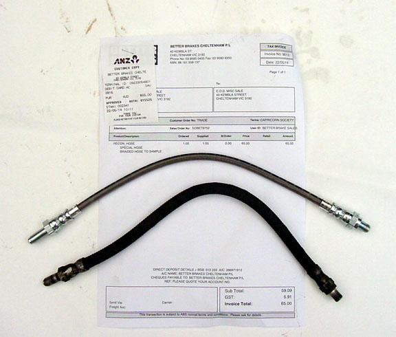

Phil & Jim...I'm currently undertaking a similar brake rebuild on my Z Magnette coupe project car. Both front brake hoses although perfect externally have constricted to the point where both front wheels are locking but not yet locked-up. Rather than replace the faulty hoses with new ones, I decided to have a couple of teflon linered stainless steel braided hoses made up. It cost about $20 AUD extra per hose over the cost of rubber hoses. Similarly my MK3 P5 coupe has all braided hoses fitted. Below is a picture of a braided hose for my P5 Rover beside an original rubber hose. The braided hoses are legal and incorporate an outer clear plastic protective sheath.

Well Jim I don't believe you have to throw the baby out with the bath water! I'm currently doing a brake resto on one of my other classics an MG Magnette. A long period of storage and lack of use has caused several issues that need remediating. Your issue with the locking brakes. All 4 wheels should have locked on a single circuit system if the 'compensating' port within the master cyl was either blocked or covered when the brake pedal was released. If the port was blocked due to maladjustment of the pedal pushrod, swollen cup seals or even dirt/debris within the cyl, pressure will build up increasingly with every application of the brake pedal. If it were mine I'd check individual components one at a time, then after careful investigation remove each one from the list of probable causes. There may be the no need to rebuild the Queen Mary.
