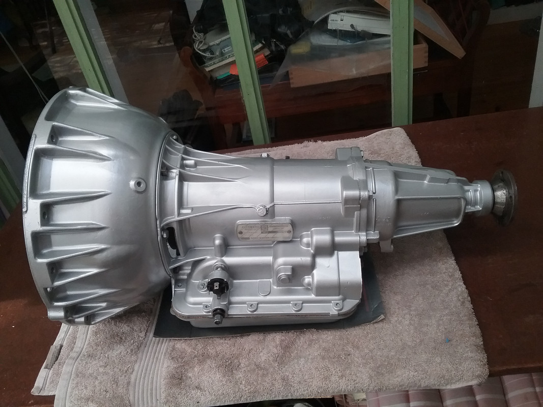

Post by enigmas on Sept 30, 2019 14:04:43 GMT
This is the transmission in my car (also a 1966 MK3). Note the location of the inhibitor switch. It's easier to adjust if you remove the top cover of the trans tunnel...then you can make the required adjustments and also check the various selector detent positions from inside the car....although you can do it from underneath...but it might be quite grotty and oily!
