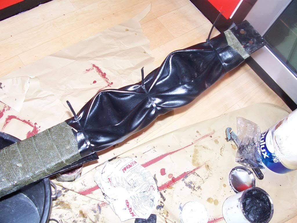

Now the next step is another optional preference.Leaf spring gators.Originally fitted over friction moving parts of leaf spring and packed with grease for obvious reasons.These can be purchased and repacked for original spec.I have fitted “gators” for two reasons,(1),so they “look” original spec and (2) when im under car I don’t get covered in orrible super sticky grease from exposed tape.I cut two pieces of leathercloth vinyl,(I suppose better with leather) 16x 16 inches. Hard to explain next bit,so will let pictures show below.
holding in place ,place cable ties around,just enough to grip gator, I did not fully tighten .l left lose so gator can be pulled into a tidy shape.
once in shape you want ,fully tighten cable ties.i doubled up on ties ,just incase…finished at last
