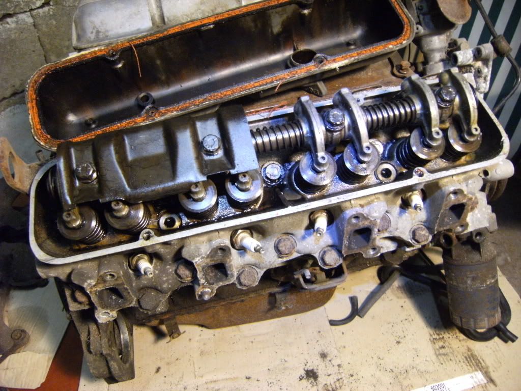

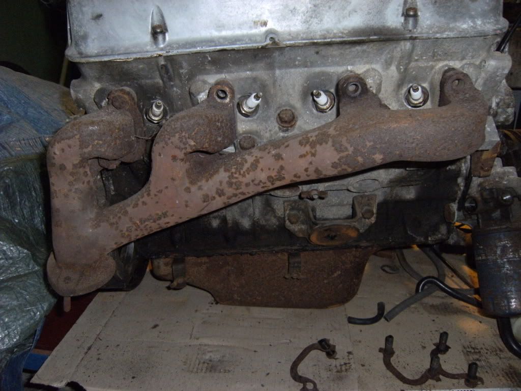

Very valuable comments, thank you. Let's go on with the engine dismantling The exhaust manifold, right hand side The rocker cover and rocker shaft The rocker shaft off
Post by Phil Nottingham on Jan 11, 2012 22:38:42 GMT
Very clean
Post by Warwick on Jan 12, 2012 2:31:09 GMT
Amazingly clean! I wonder if the engine was overhauled not long before the car was "retired" and began its disintegration?

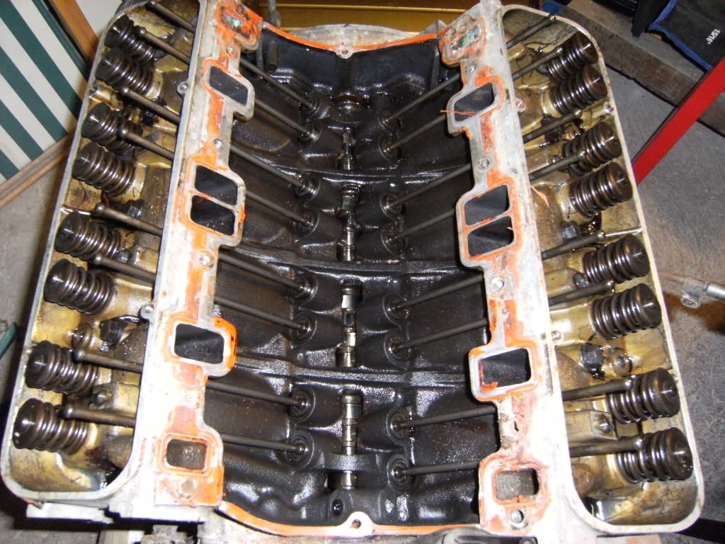

Post by cyf on Jan 12, 2012 22:02:24 GMT
I really don't know Warwick. The clock said 59440 Km. I guess it was not overhauled.
As it's my first engine opening, I didn't realised how clean it is. Ihave to open another one so I will compare
Post by Warwick on Jan 13, 2012 7:53:43 GMT
Cyf,
Internally these engines are generally black and coated in sludge. This one looks like it has been recently reassembled, or it has been running on LPG which, over time, cleans them up. It might be worth investigating further. It might have a really good engine.

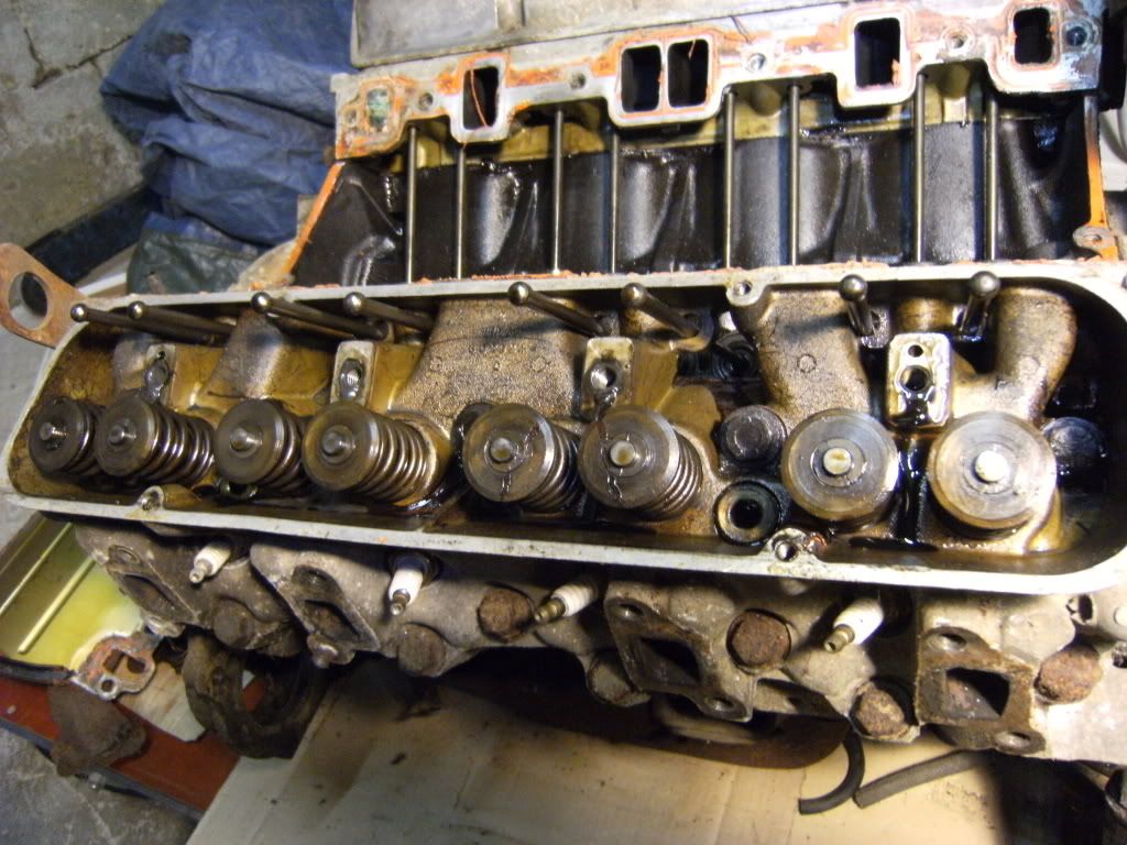

Post by cyf on Jan 25, 2012 14:54:43 GMT
Post by Warwick on Jan 25, 2012 21:19:07 GMT
Thanks Cyf,
The condition of the inside of that water pump adds to my opinion that you have a well cared for engine there. And look at the cleanliness of that timing case. Not at all like the condition of the body.
