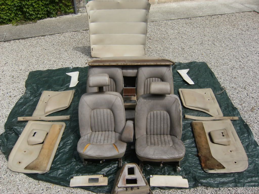

The body shell The trim

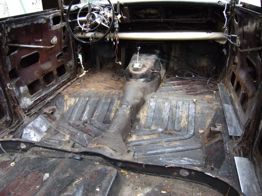

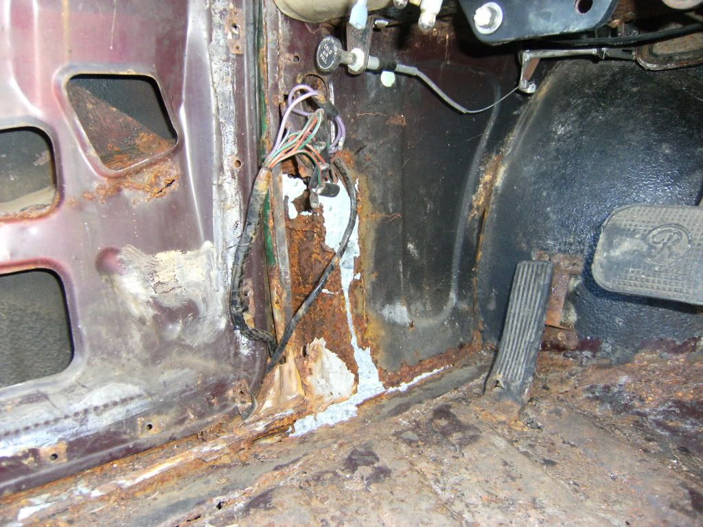

Any photos showing how the wiring loom sits along the cills, especially how it routes around the base of the A and B pillars, under the stainless steel kick plates?

Any photos showing how the wiring loom sits along the cills, especially how it routes around the base of the A and B pillars, under the stainless steel kick plates? the wiring loom goes through the pillar
Post by cyf on Oct 27, 2011 19:41:24 GMT
That's right. On the pictures below, you can see the wiring loom with the stainless steel plates left in place on one side

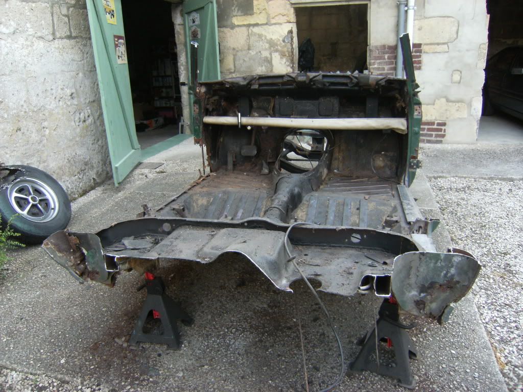

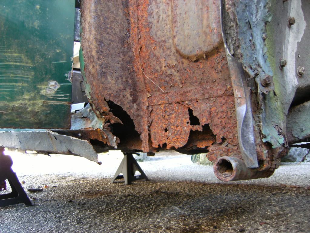

Thanks fortnum 1977. What do you mean by chassis legs? For the rear suspension, I have this: The leafs front fixing The leafs rear fixing, Y bush The rear shock absorbers lower fixing The body without the axle Cheers, great photos, I think the chassis legs are what the leaf spring hinges mount on to. And they are of great concern to me as I should imagine rotten ones could see you losing your rear axle on the motor way.

The chassis legs are the sections running from the "Y" bushes to the rear and they also carry the brackets for the bumper. Although supplied with generous drain holes, they do seem to be a problem on some cars. In really bad cases, the whole lot could collapse but the gauge of metal used should prevent that stage ever being reached. Pumping them full of waxoyl over the years has preserved mine. The business end is the front as that takes all the thrust and stress of the spring etc but seems to last much better especially on the exhaust side due to the heat. The spring mountings and the reinforcements at the front end of the spring are very strong and built like an outside khazi

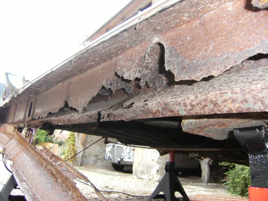

ok thanks that's reassuring. But do they sprout from the sills? In which case i'm worried because my sills are rotten.
I did have my chassis legs welded after it failed an MOT because of them. So i hope the welding will hold, I haven't actually seen what was done.

No, they are not part of the sill construction. If you study the image posted of the rear underside, you can see that the rear chassis legs are just the end of a "U" shaped channel running from the end of the car and then turning inwards at the point where the spring is attached. It's like a mini chassis and not prone to much trouble except in the area of the rear spring mounting. It's quite possible to have thoroughly rotten sills but the "mini chassis" is well inboard at the front and made of good gauge steel.

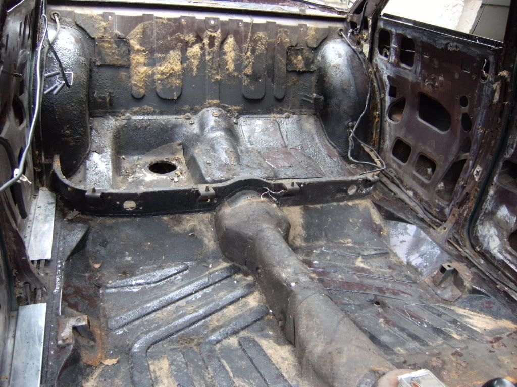

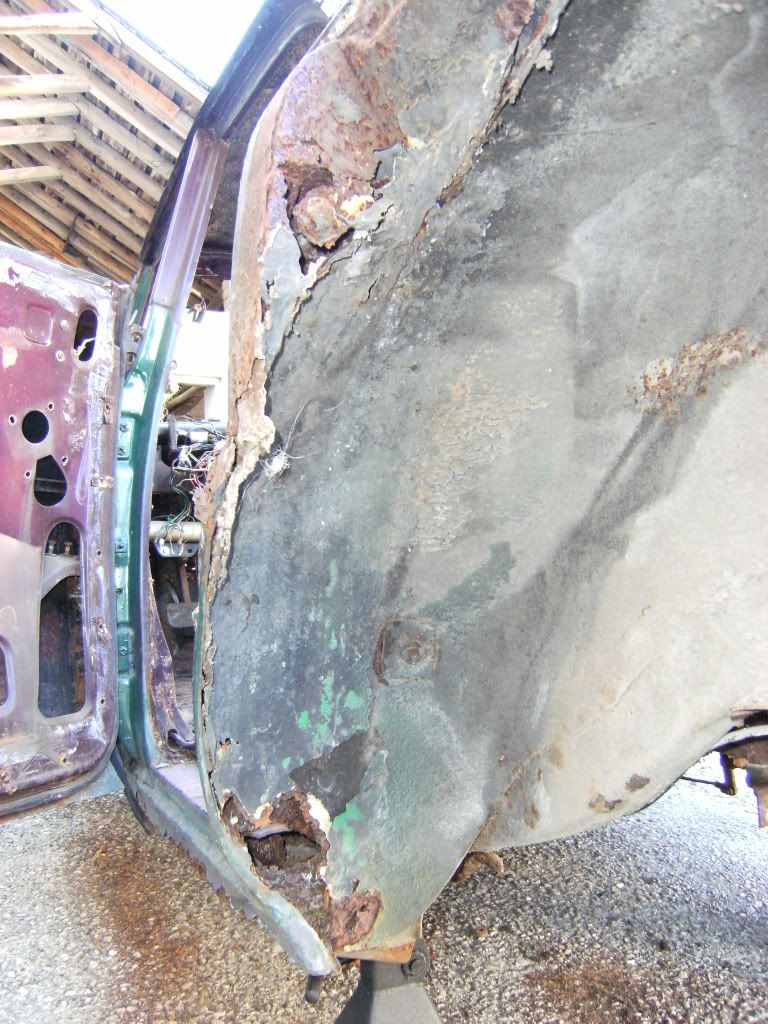

This to illustrate what crossplies said about the "mini chassis". You can see it cut On the following picture, you see the "minichassis" on the left, inward of the wheel arch And the front mounting

That is brilliant, now I understand the structure, thank you. Your P5 is definitely a gonna, will you scatter its remains?

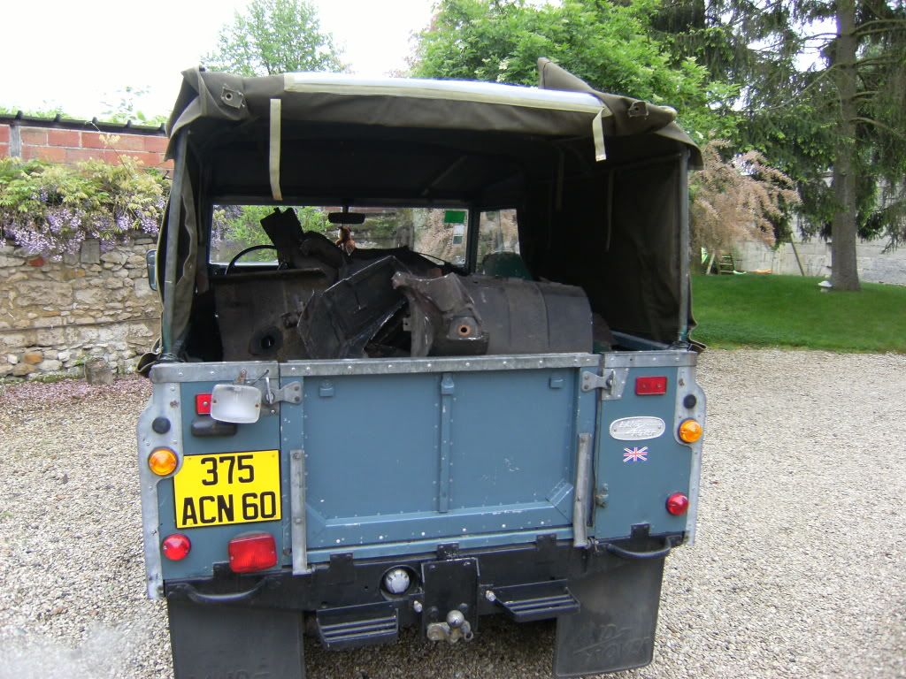

I did it with my Landy

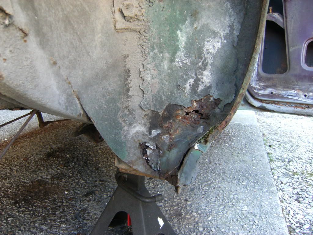

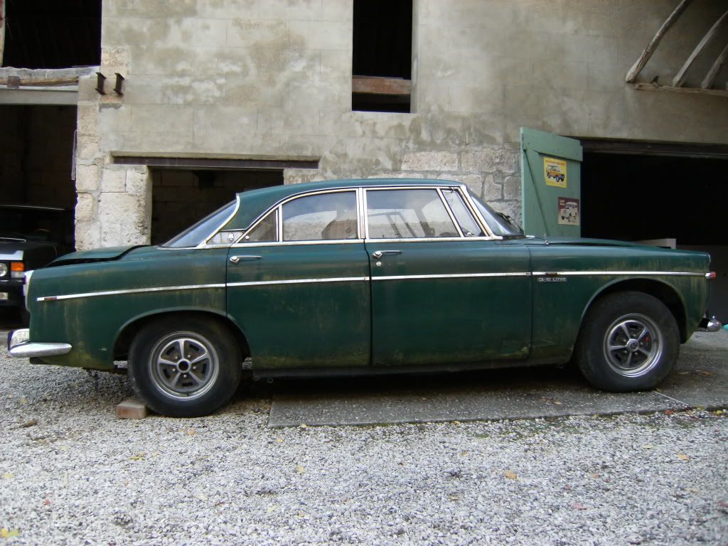

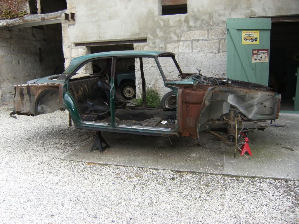

Well, when I bought the car I thought it was possible to put it back on the road but as the dismantling goes, it seems that it would have been very very costy to retore it: the complete interior, the engine, gearbox, drive train and the rusted body...... Here's the car the day I bought it: "not so bad" But the rust were everywhere the good point is that it left parts for my others P5

Truly horrendous corrosion and well beyond economical or practical repair. I don't know how it didn't collapse in the middle! It actually looked quite decent side on.
But by leaving its body to mechanical science we've all learned a lot.
The white one looks far healthier!
