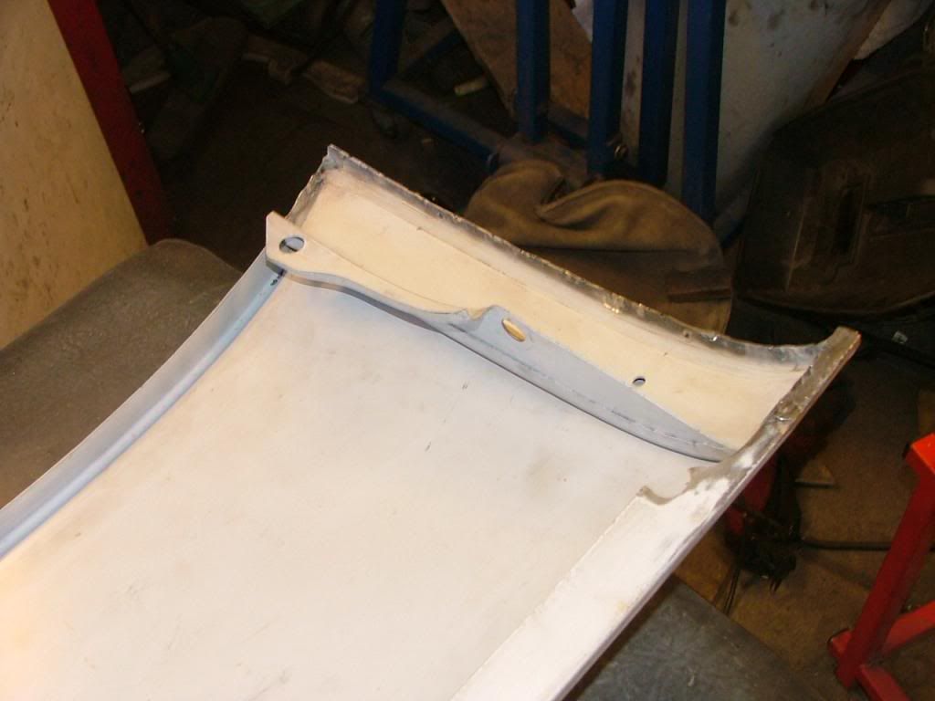

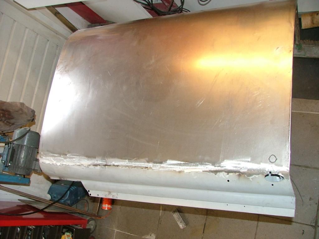

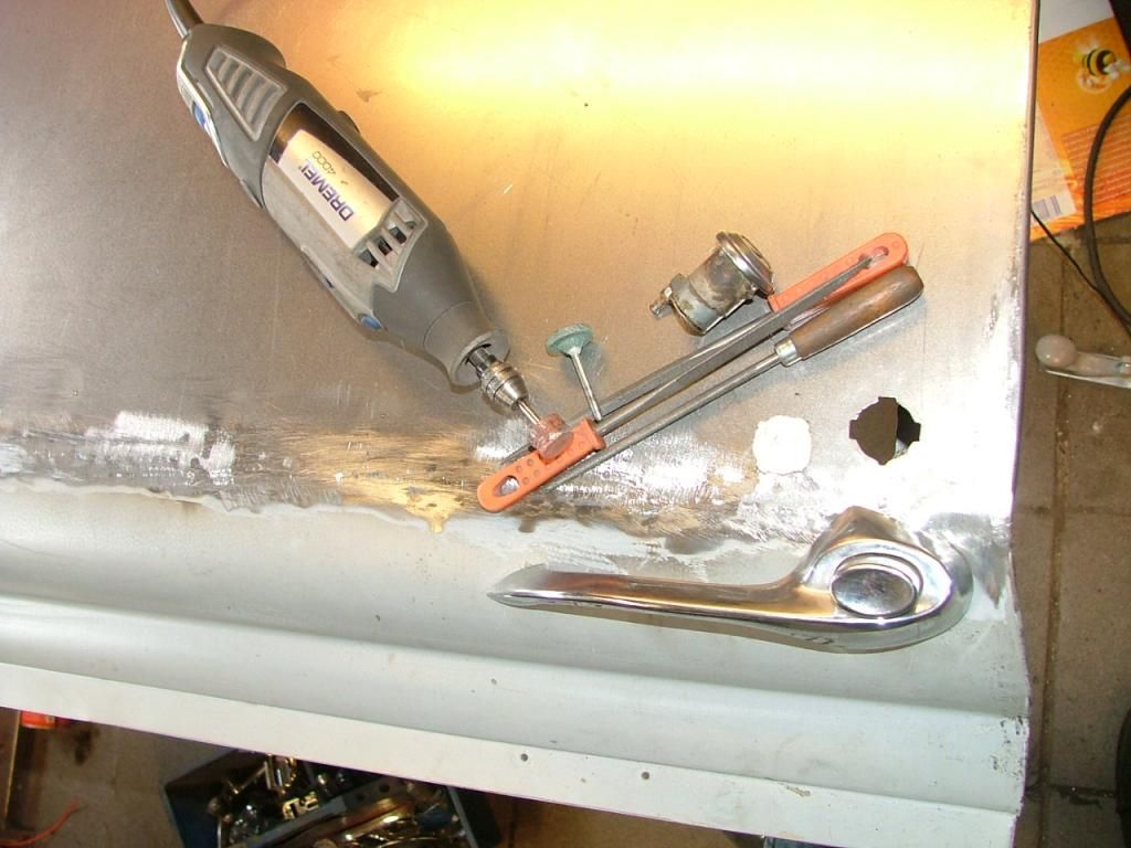

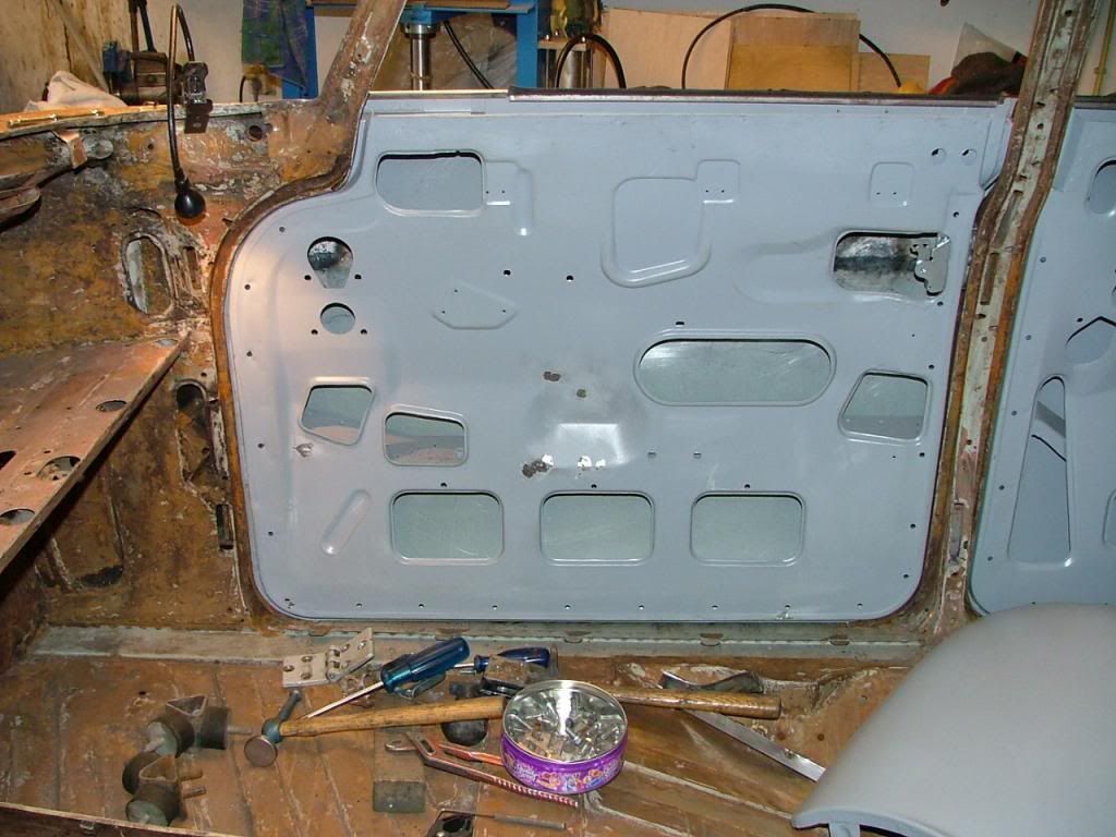

Steve,
I have spend some hours on the RH door skin. I was able to clean up the weld so there were no pin holes anymore. Then i tried to straighten the panel but this was no successful, partly due to the fact that the repair panel doesn't have much stability because the center is not raised slightly(like you already stated)
I have thought about buying an Englisch wheel before but i don't have the space to store and i cannot justify it for just one door skin. The door is the last panel which needs serious sorting. If i would make, i would not choose aluminum. I cannot weld aluminum so welding up the gaps would not be possible. I searched for an old school panel beater with a decent rate to repair my door. I found one who could repair the door for 200-300 Euro's but good old school panel beaters with a decent rate have lots of work.... He was working on a Delhaye. He gave me another name and this week i will try the other panel beater.

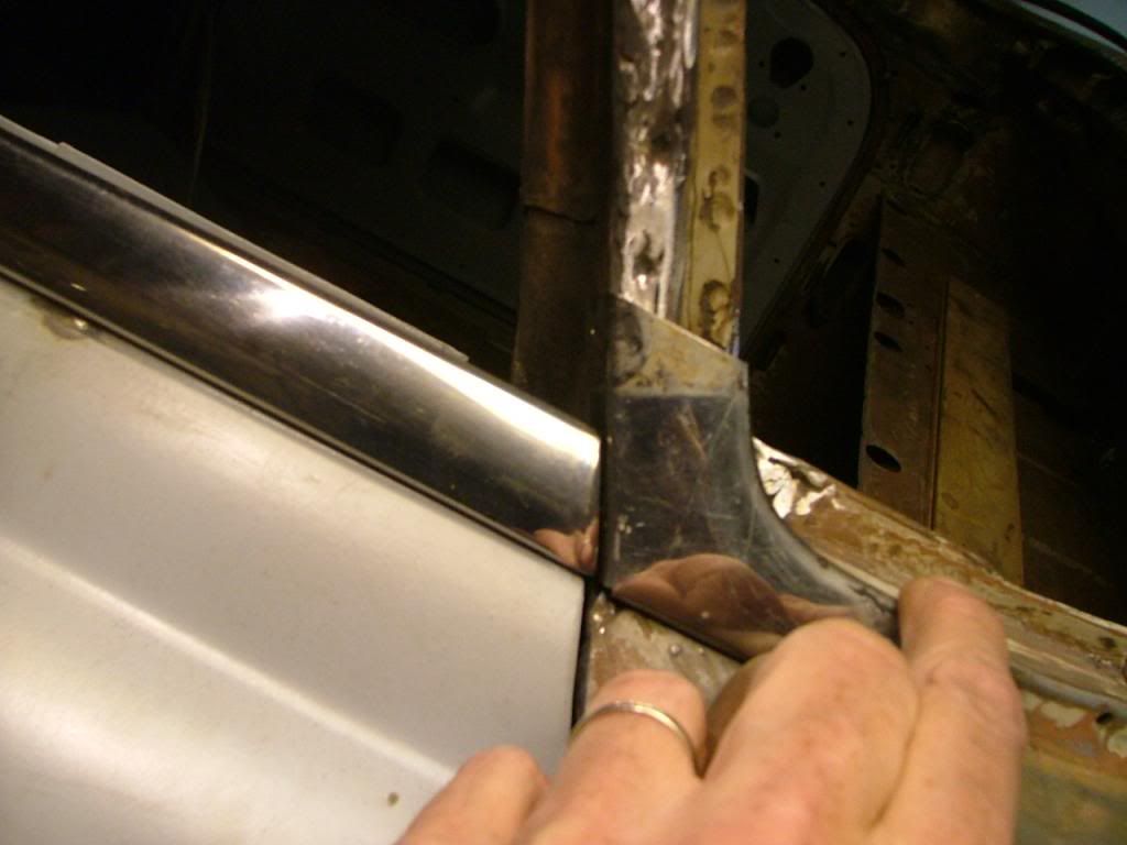

Post by petervdvelde on Apr 18, 2014 22:53:35 GMT

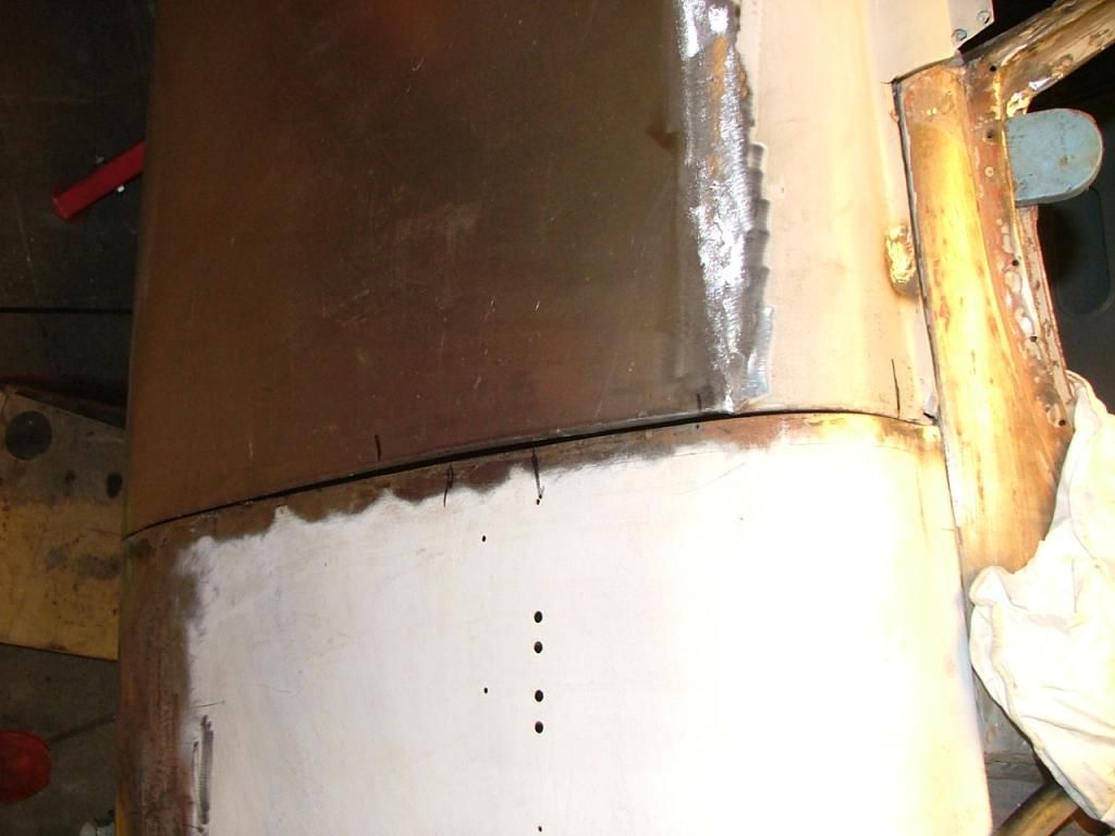

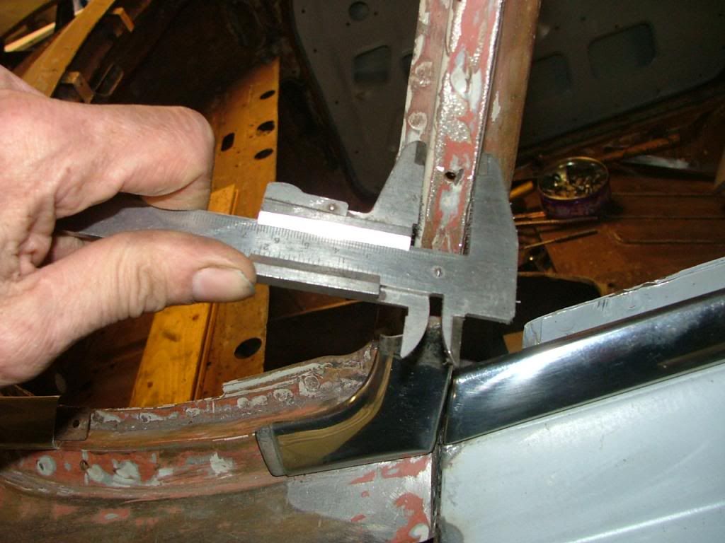

Have been adjusting the RH front door. Also checked the inner gaps. On the lower end of the D-post there was minimal clearance so removed a shimed beteen body and hinges. The gap between door and roof post was too small to fit the stainless door trim. After a lot of checking and re adjusting i found that the roof post on the RH side was 20 mm thick and on the LH side it was only 17 mm On the LH side the trim fitted good After a lot of considering, i decided to make a cut in the RH roof post and with heat it up with an acetylene torch and closed the gap and welded the post up so that the thickness is now 17mm on the RH side. It is l a tight fit but it works. The door frame is not the one which was originally fitted to the car. I wonder how they made it fit at the factory That's it for now Peter

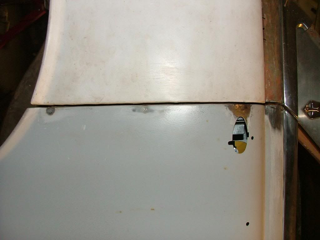

Post by petervdvelde on Apr 27, 2014 18:56:06 GMT

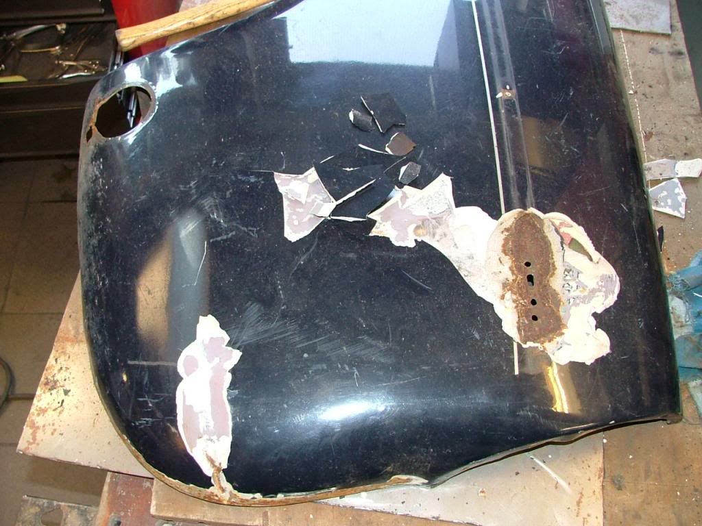

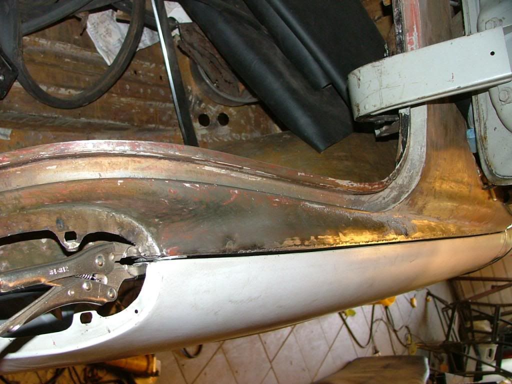

After finishing work on the RH rear door, today i work on the RH rear wing. Under the rear lights the rear wing fitted well. The gap with the rear door was not too bad but was only 2,5- 3 mm and i want it approx 5mm like most of the other gaps. Because the wing is curved on top, i didn't feel confident to widen the gap with hammer and dolly. I cut 6 pieces of 35mm wide and 2 mm thick sheet metal out of a plate and made an inner and outer kind of jig. First i used the rear door to make the outer jig. I clamped 2 strips on the door and made holes in the outer strips and filler welder the holes so the 2 strips were connected. Then added a third strips with the same method. After that i used the outer jig to make the inner jig (i put a strip of 1 mm thick between the jigs being a substitute for the door skin. After connecting the 3 strips of the inner jig, i out some welds on the outer sides to give the jigs additional strength. Then clamped the 2 jigs to the wing and hammered the side of the wing to increase the gap. Itl resulted in a nice gap of 5mm width. The wing need a little cleaning up It is a lot of work to make the jigs but now i have an even gap and the contours of door and wing are equal. I believe it can be done with hammer and dolly but i was afraid it would ruin the contour of the rear wing especially on the top end where it is curved. I compared the contours of some rear wings i have and especially underneath the rear light, all 3 wings had a different contour. Here is a picture of a scrap wing. I believe it was twice as heavy as the other wings due to the huge amount of filler on it. On one pint it was 8mm thick. That's it for now. Peter

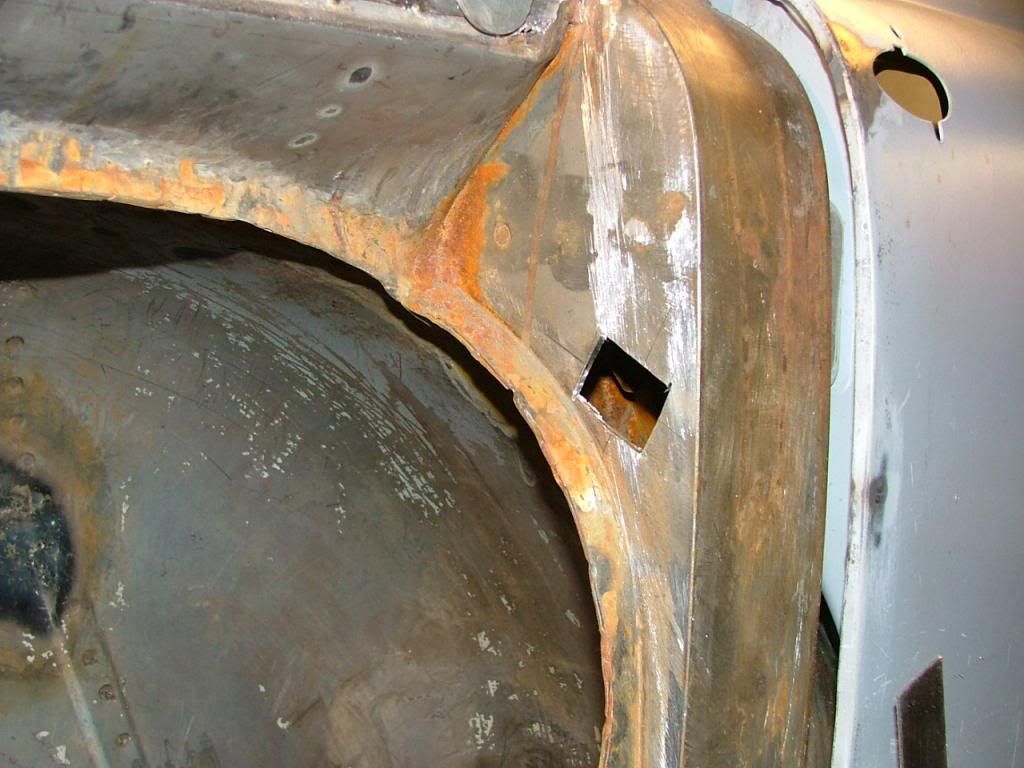

Post by petervdvelde on May 22, 2014 17:15:43 GMT
A fair amount of time was spend to make the gap on the topside equal so that the wing could be fitted free of stress.

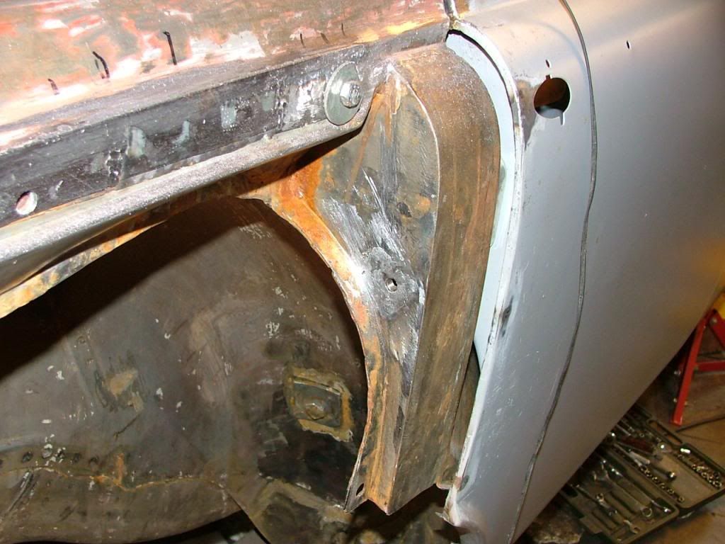

Post by petervdvelde on May 22, 2014 17:28:02 GMT
Used the "create post" button to early Then welded the bracket on to the wing. The hole with the nut on the backside didn't match with the hole in the wing bracket so a piece of the plate with the nut on the backside was cut out. The length of the cut out piece was chosen so that when turned around it would be on the correct position and was then welded into position. After some fiddling, the bracket on the wing fitted now well with the counterpart on the body. The gap between rear wing and rear door is now even and the height of the rear wing matches with the height of the door. That's it for now Peter

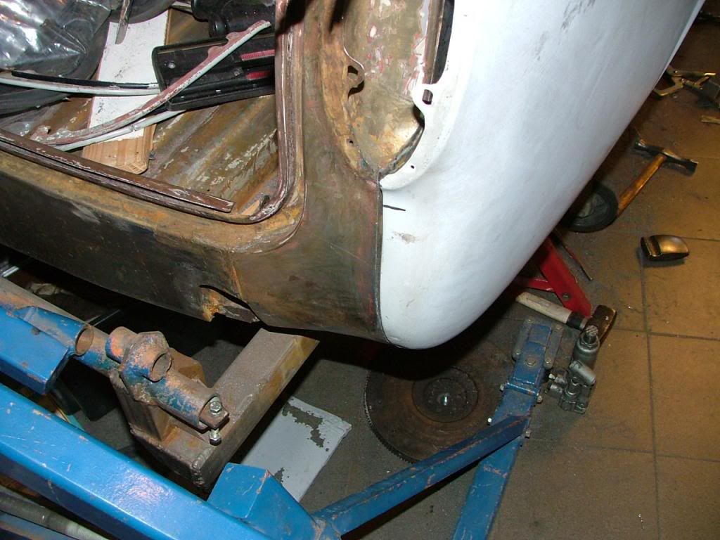

Post by petervdvelde on May 22, 2014 17:47:02 GMT
Here is another picture of the endresult

In the meantime i brought the RH front door to the old school panel beater who was working on the Delhaye. He will fit (partly) a new skin with a raised center. The panel beater recently bought an MGB V8 conversion and i will assist him with some engine overhaul work so it is not gonna cost me a lot of money.

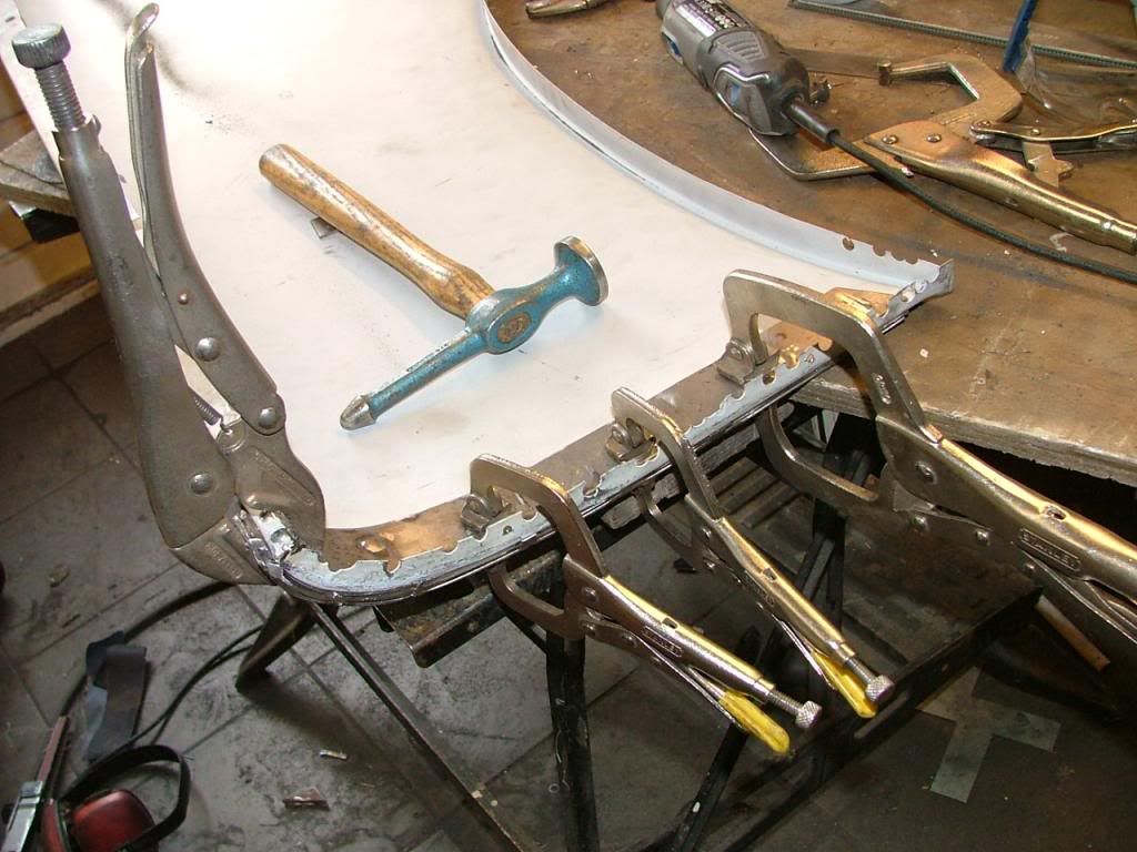

Started working again on the body of my other P5B which had only gathering dust to the purchase of and work done on the project P5B. Here a picture of the partly re skinned front RH door which was done by an old school metal man who has all kind of special tools and an English wheel which he used to create a raised center in the skin. He TIG welded the connection between the upper and lower skin part. He stated that TIG welding put less heat in the panel so less distortion and the weld is not so hard as a MIG weld. He welded approx 3-4 cm and then with hammer and dolly hammered the weld to remove the shrink and the went on welding and hammering again. After that he removed small deformation with the English wheel. First job for me was to make a hole for the door lock and trial fit the door handle Trial fitting the door showed that the gap with the rear door only needs minor work where the skin parts are joined The gap with the front wing needs some more work The gap with the sill is perfect (didn't make a picture). i asked the metal man to make it a little bigger and it fits perfect. Thats it for now Peter
