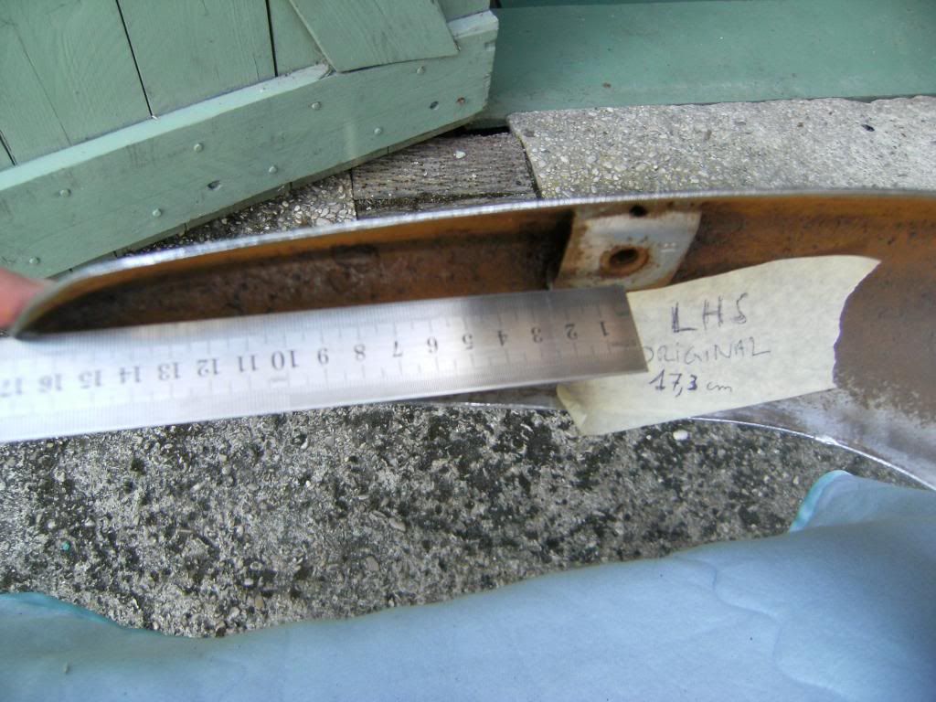

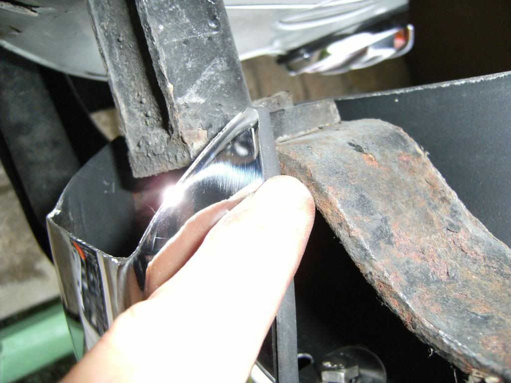

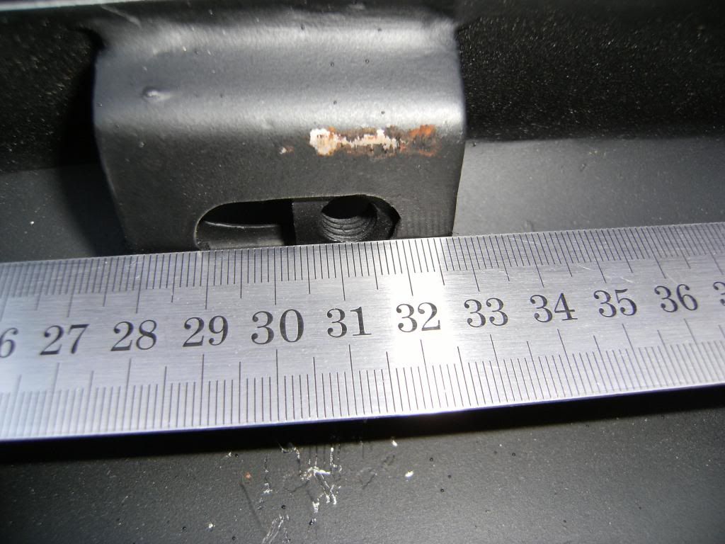

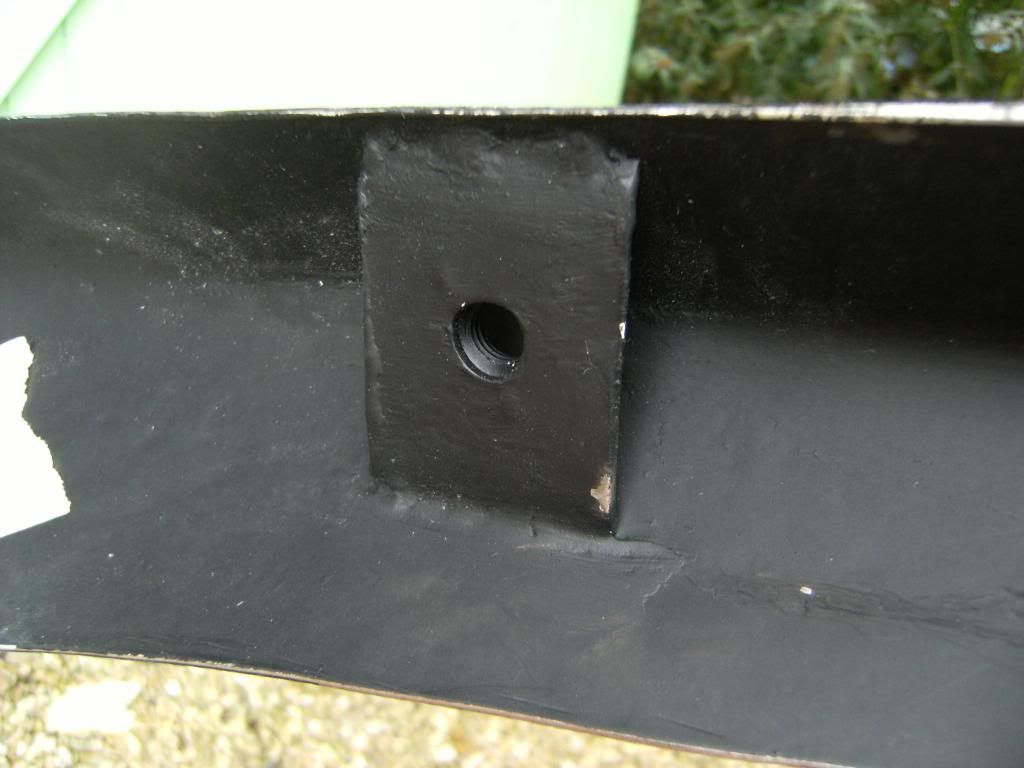

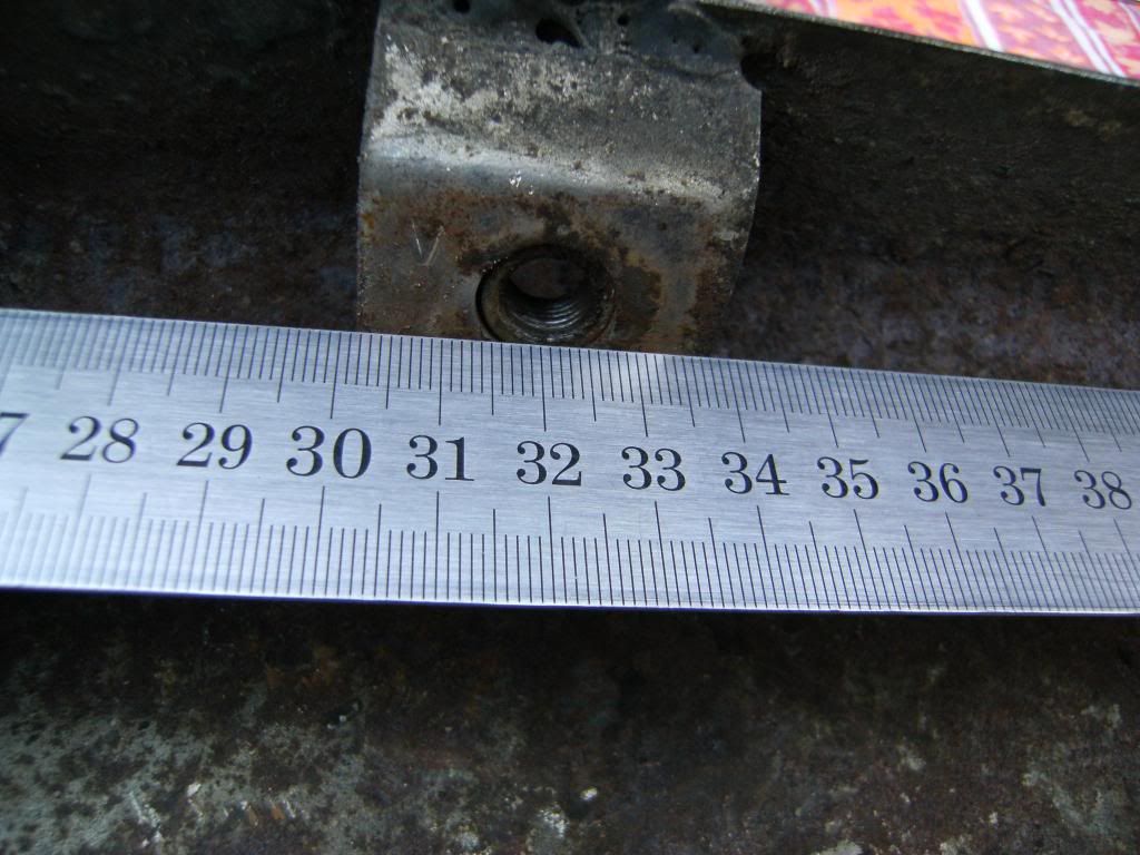

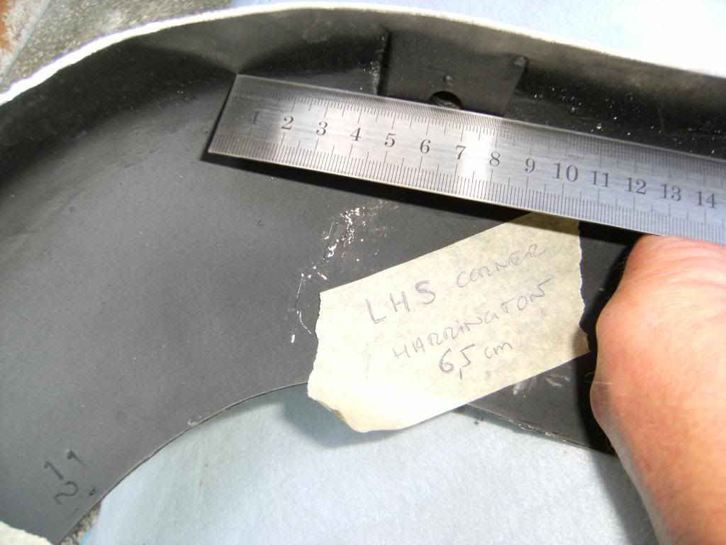

Post by cyf on Oct 18, 2013 14:34:49 GMT

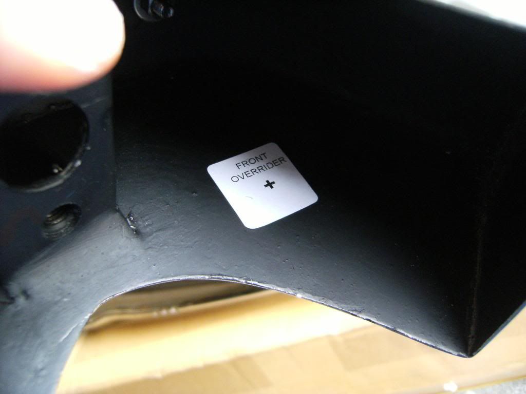

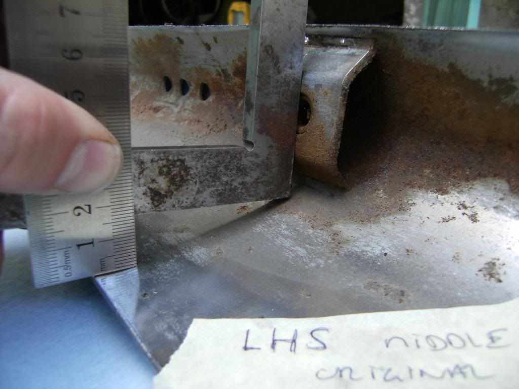

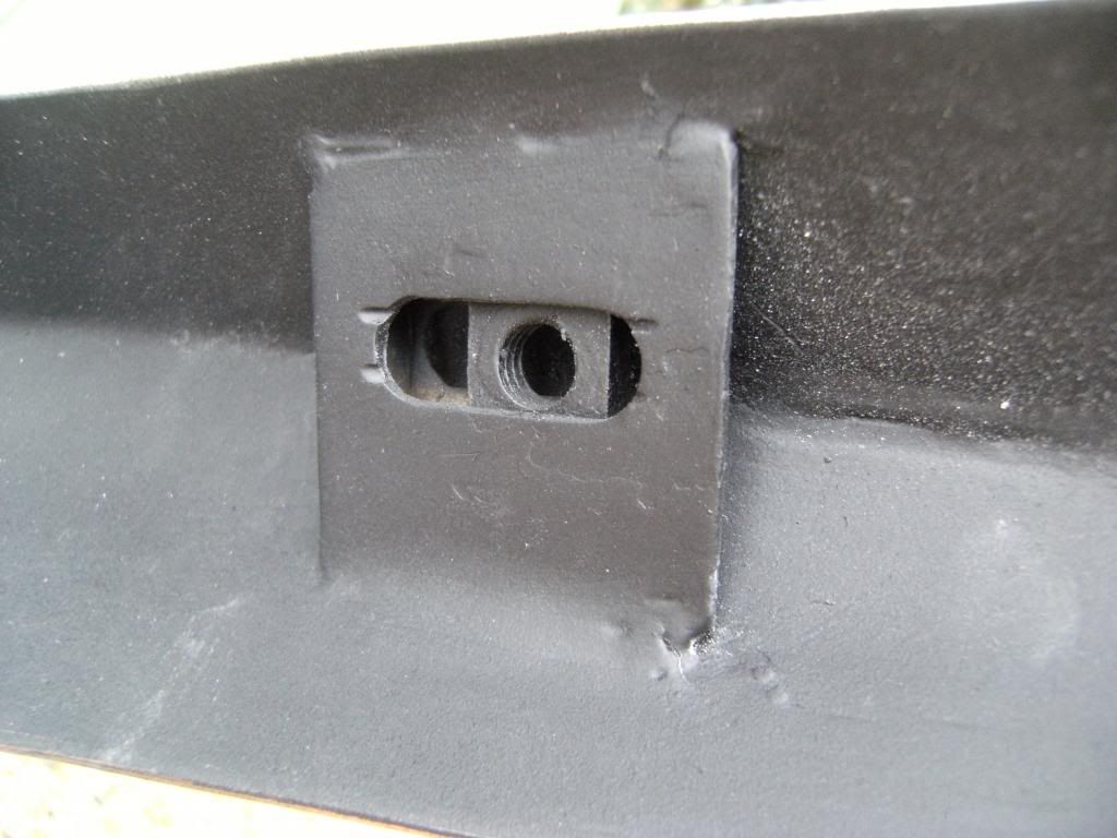

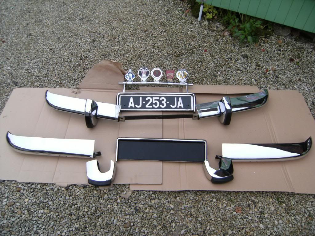

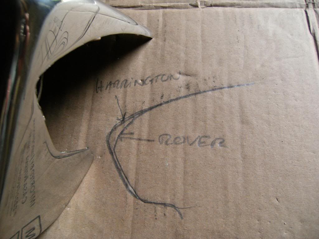

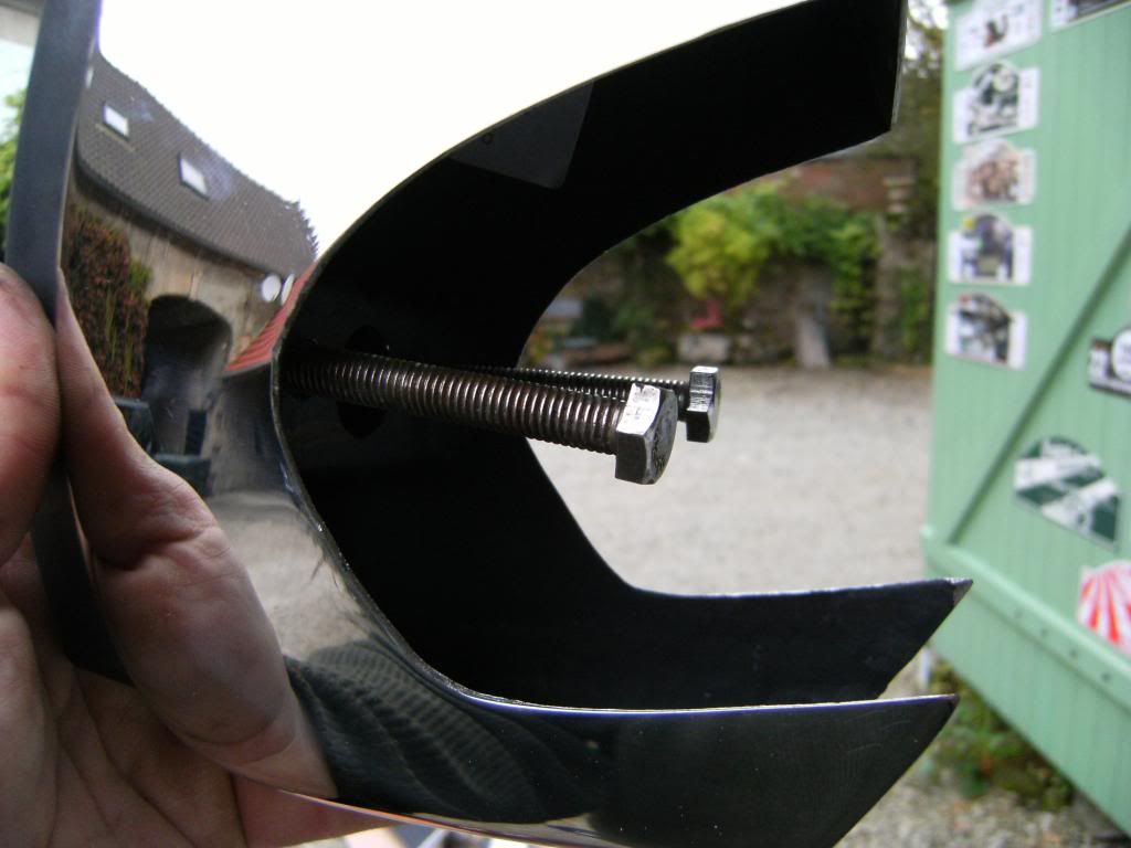

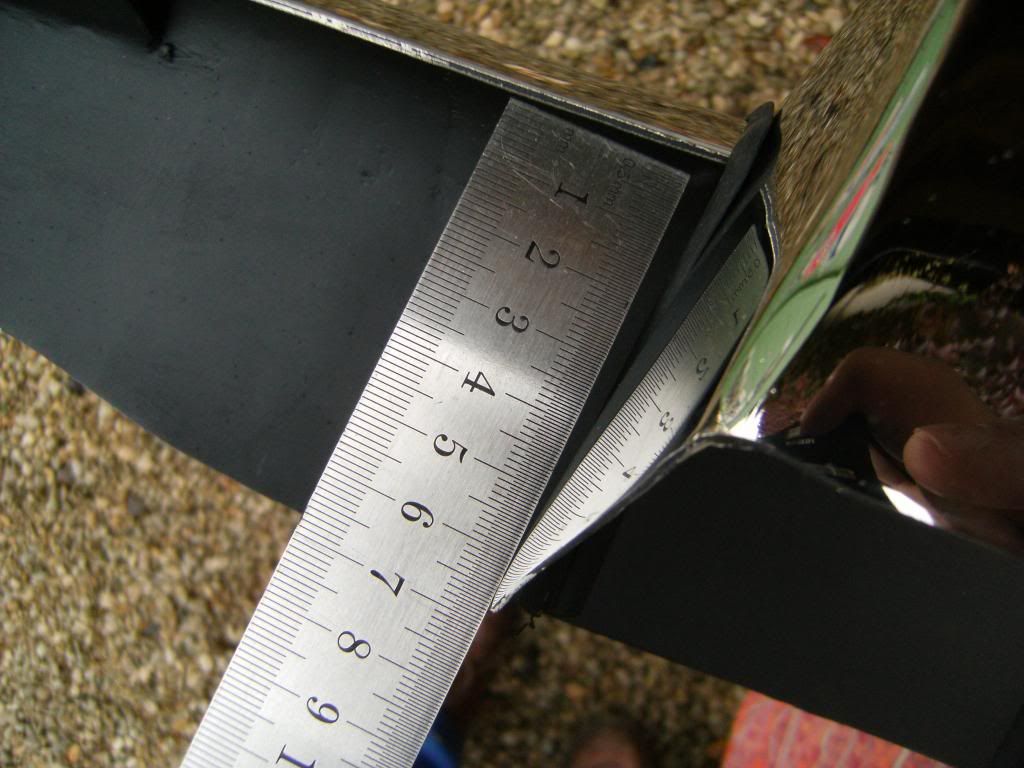

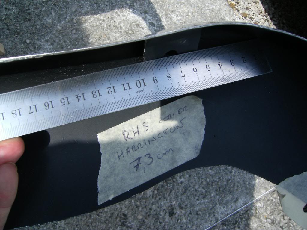

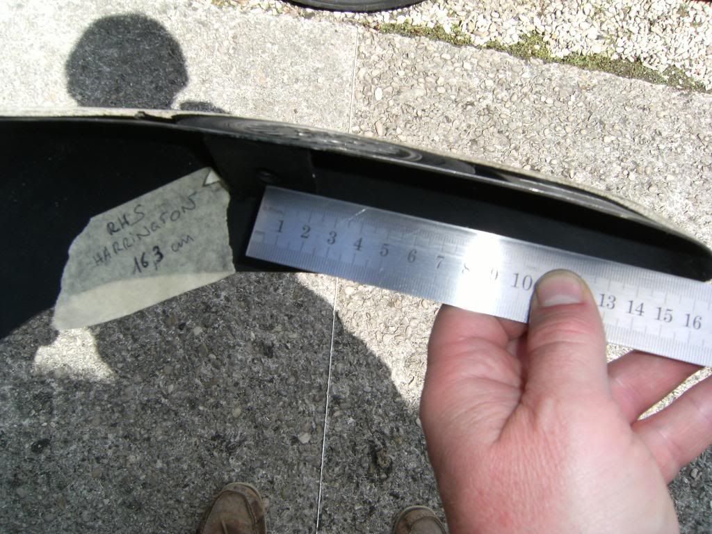

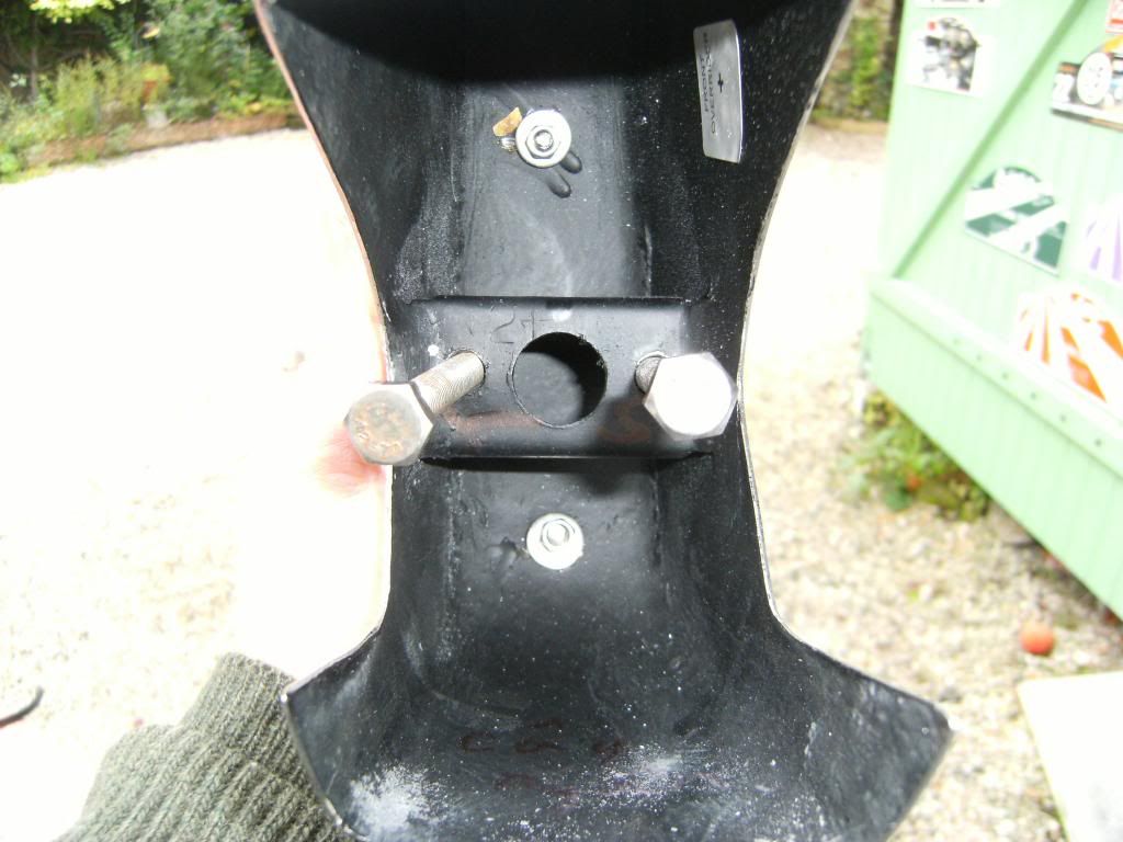

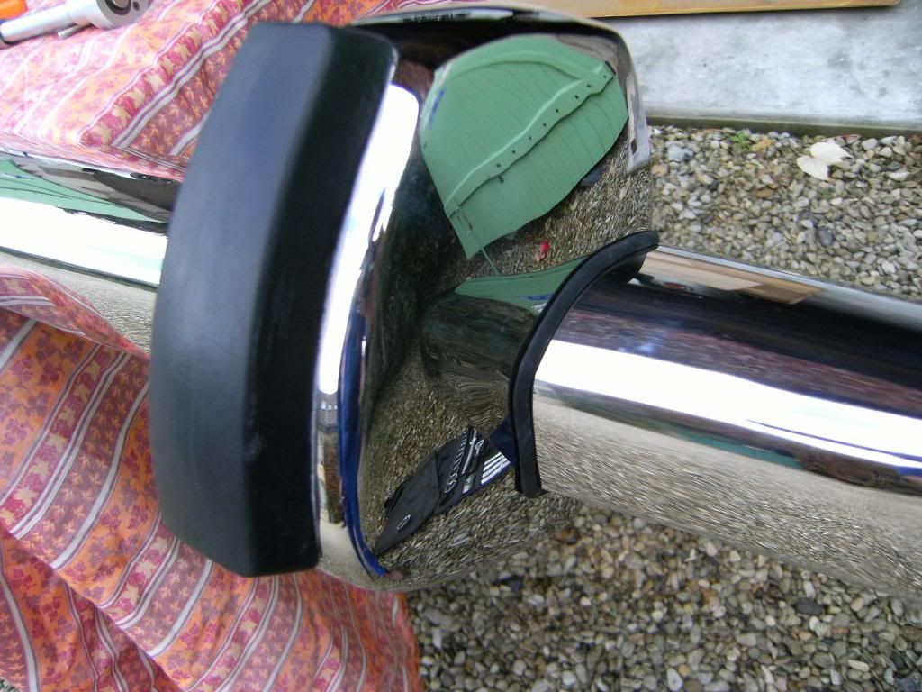

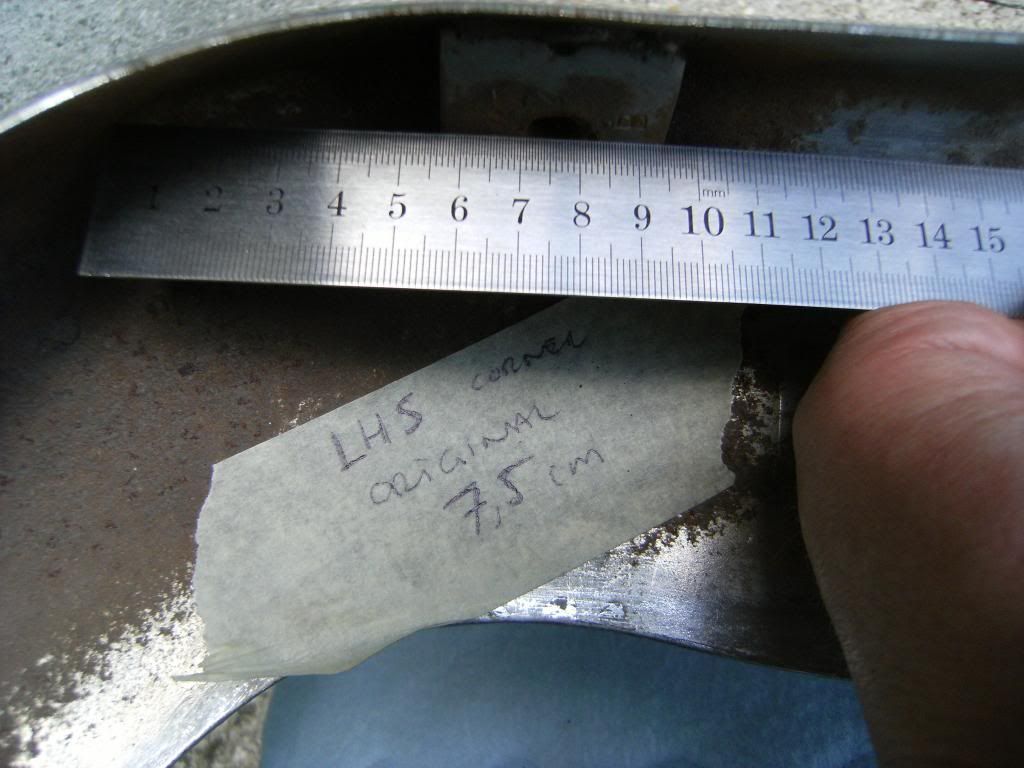

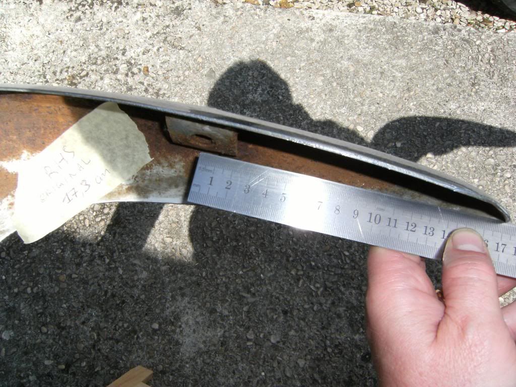

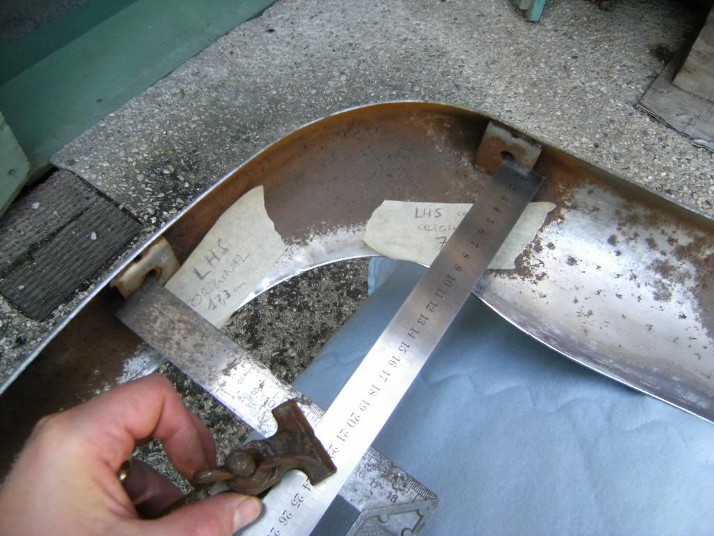

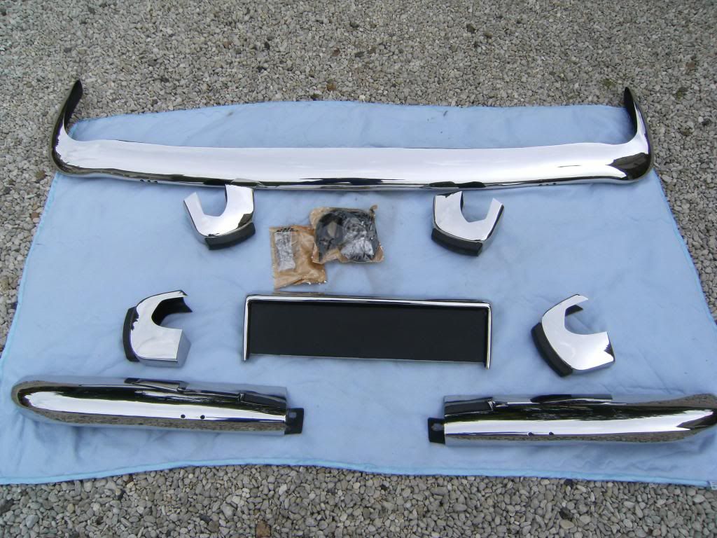

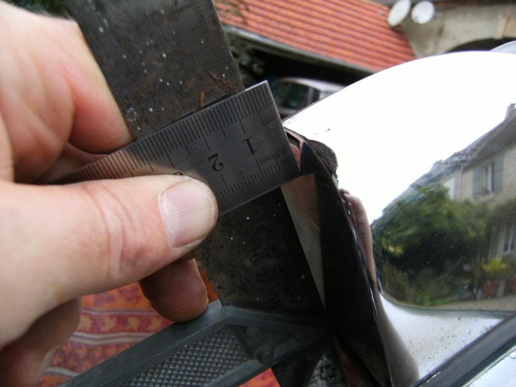

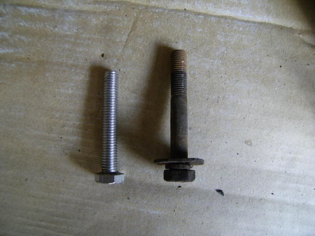

Hello everyone, Some of you may recall that I ordered a set of Stainless steel bumpers from Group Harrington last springtime. I wanted "new" bumpers and they are the only one who makes SS bumpers for our cars I said that I'll do a thread to tell the story, so here it is. Ordering a set was very easy: you get in touch with them via their site, they answer quickly, you pay via Paypal and it's done. The communication is good, they send you an E mail to tell you when your parcel is send and they give you a tracking number. Mine came one month and a half after ordering (they told me three weeks but they had somme problems) So, here's what you get when the big day comes: Everything is well protected with bubble wraps and cloths Here's the complete set unpacked: you have the parts of the bumpers, bolts and rubber bands There are some imperfection on the shine of the parts here and there but it's OK, it looks good The parts are painted black inside So, all the parts are here, it will be a piece of cake to fit them on the car and then go to the London to Brighton in June with brand new shiny bumpers. I began with the rear one and things didn't went as expected. The new bumper didn't fit. I take measurements and it appeared that the brackets were not fitted properly and even not symetrical When I E mailed to them to say that I was not happy, my case was took in charge by the sales and marketing director. In first, he said that their products are good quality, thy are made to fit and he is really surprised by my request. He also said that other customers are happy. I then took pictures (and time) to show him the problems He offered me to make the brackets welded at the good place butI ddn't want to as I paid for something right and I want it right. I must say that the communication was very good with him and he offered to make another rear bumper with welllocate brackets and I accepted because it was very professional. He also send me longer bolts as the one in the box were too short to fit the overriders The new parcel came at the end of august. I did'nt have the time to fit them sooner then in October The brackets were modified with captive nuts old ones New ones Alas, even if it's better it's not perfect. There's one centimeter missing between two brackets May be with a little bit of persuasion it will fit. So, I put the overiders in place They didn't fit the same They are also not the same shape as the genuine ones, they are longer underneath the bumper This makes the overrider touching the bracket of the car The angle with the top of the bumper is not the same too genuine one Harrington's one This make a strange look (the bumper is just hang on the bracket) Here's the rear bumper complete I then tried to fit it but I didn't succeed yet. For the front bumper, it's not better at the moment. Here the parts with the old one Fitting the overriders was a nightmare because the holes are not square and parallel Therefore, the fitting is not neat at some place Better at others The shape of the front overriders are different too The front bumper is not on the car yet, because I didn't find the good way to put it on. So, here are the facts and pictures.I'm may be too pernickety. Group Harrington send me pictures from happy customers. I'm still in touch with them. In a way or another the bumpers will go onto my car, but I expected that would have been straight.

Looking at the evidence in Cyf's pictures it would seem that they have got the main tooling correct(ish). To be fair they look like P5 bumpers and in that respect they are not far off the mark. The problems seem to be in the finer details like the out of place and mis-aligned bracketry and ill fitting overriders (which are almost certainly finished by hand from the initial pressings). The major investment in the tooling is being let down by poor manual finishing. As for 'pattern' parts in general most of us expect them to at least fit. How many of you buy non OEM ink cartridges for your printers or spurious batteries for you mobile phones? Would you be happy to have to cut, drill and file things to make them fit? I'm sure the Chinese make tyres, what if their 15" tyres were actually 15 1/2". Would you be happy to weld filling bands to your rims 'to make them fit'? And anybody who makes a pattern part boot lid that is 15mm too small simply should not be in business at all...

Interesting reading Cyf. Sorry to hear about your dilemma. I find it hard to understand that this company didn't mock-up a fitting jig from a good quality set of 'borrowed' P5 bumpers to check the quality and fit of the components they commissioned for manufacture...even to the point of drilling the attachment holes in the correct locations. It's also interesting to see that the fitting bolts provided look like cheap hardware bolts as evidenced by the full length thread. I'd rather stick with the original steel components as pieces can be easily welded, smoothed, linished to shape and then rechromed.
The stainless bumpers certainly look nice over the 'ether'. The contentious issue seems to be more with the placement of the fitting holes.

Does not excuse the fact that the overiders do not fit the bumper profile though. It would be almost impossible to get the bumpers EXACTLY the same profile in any case, but the overiders should at least fit the profile they have produced. Don't forget that when Rover made the originals, they would have created press tooling which was round about what was required with no requirement to match anything that had gone before ! Also, being that stainless is an incredibly difficult material to work, they would have to be made in several pieces then welded together. In fact, I wouldn't mind betting that these might even be hand rolled individually.

I think it is a shame they can not get it right because when I went to look at Glyn's they looked good but he had a lot of problems fitting them with the nuts being out of place so I still can not recommend them.
