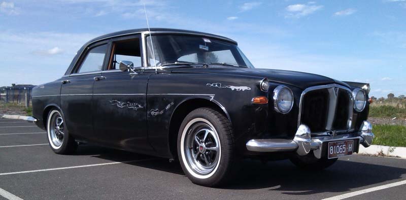

Any tyre over a '195' is really too big for 5" rims. Quite a few tyre retailers/fitters (where I live) will not mount a tyre more than a 195 to the standard 5" rims for legal reasons. The second number is the 'aspect ratio' (width in relation to tyre height). The higher the aspect ratio number the taller the tyre and vica versa. A 225/65r15 (a wide low profile tyre) would be a very 'squirmy' tyre (lots of side wall flex) to use on a standard P5 5" rim. My coupe is currently wearing 185/80r15s. (Front) and 225/60r15" on 6 1/2" rims on the rear.
Post by djm16 on Feb 22, 2018 22:52:32 GMT
Like Enigmas, I have 185/80R15s. On both P3 and P4.
