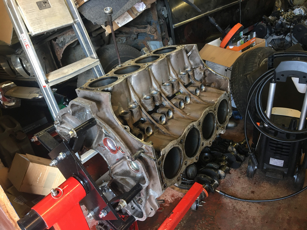

Well lockdown fever has caused me to barricade myself into my workshop, where I have finally removed the sick engine from the Rover. Many packages & boxes of shiny new bits keep turning upš so hopefully by the end of this week the āshortā engine will be rebuilt & back in the car, I have a pair of efi heads to go on but they still need fettling, which will have to wait for next pay day. Iāve had the sump off the auto box and replaced the kick down cable, obviously I need to wait until the carbs & throttle linkage has been refitted before I can adjust it, so Iāve popped the sump back on to keep the dirt out. I also need to pop the dipstick tube off as the little cork/rubber bung thing has made its way down the tube & is jamming the stick. Iāve also renewed all the front anti roll bar bushes as they were like a black jelly. Iāve also noticed a leaky wheel cylinder on the o/s/r as thereās a little pool of fluid on the floor

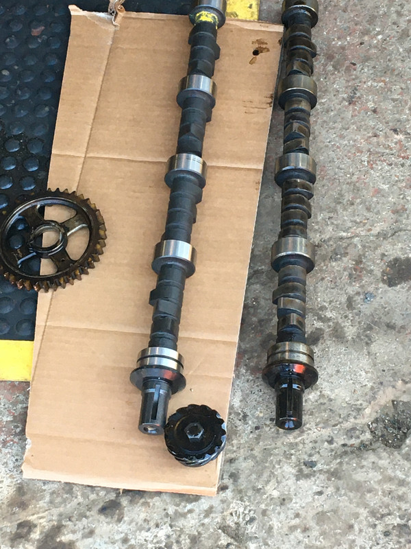

Hereās the main reason the engine came to bits, if you look at the 2 cams side by side and compare the lobes you will notice no.6 exhaust lobe (12the one along) is completely missing

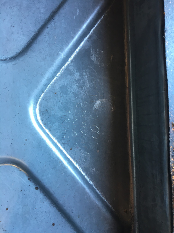

Also found an inscription inside the gearbox sump It would seem back in 1980 Graham serviced the box & renewed the filter & also overhauled the rear servo..........thanks Grahamš

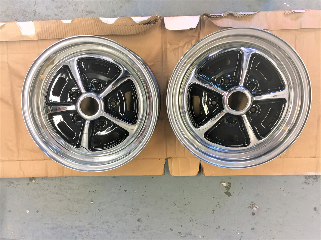

A long time in doing them my spare 2 re-chromed Rostyles finally had their Satin Black done it's only 9 years! got in the mood after spraying my sons Bandit Motorbike

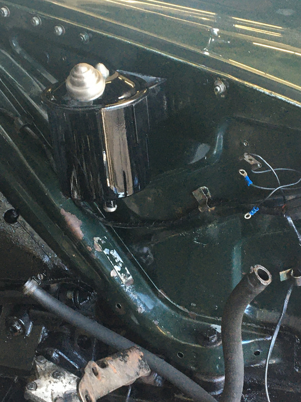

Not really today, more like last Sunday I removed the defunct alarm siren & badly fitted electric fuel pump from the n/s inner wing, gave it a polish up & gave the pas reservoir a fresh coat of black. Depending on the weather I might give the other side similar treatment this weekend. Iām at a standstill with my engine as I am struggling to find a piston.......plenty new ones out there but nobody will sell a single & I just canāt justify Ā£800
Post by stirlingmg on May 1, 2020 19:40:20 GMT
Seen one youāve seen them all but hereās a pic anyway Iām not aiming for John or Georgeās standards, just making it it nice
