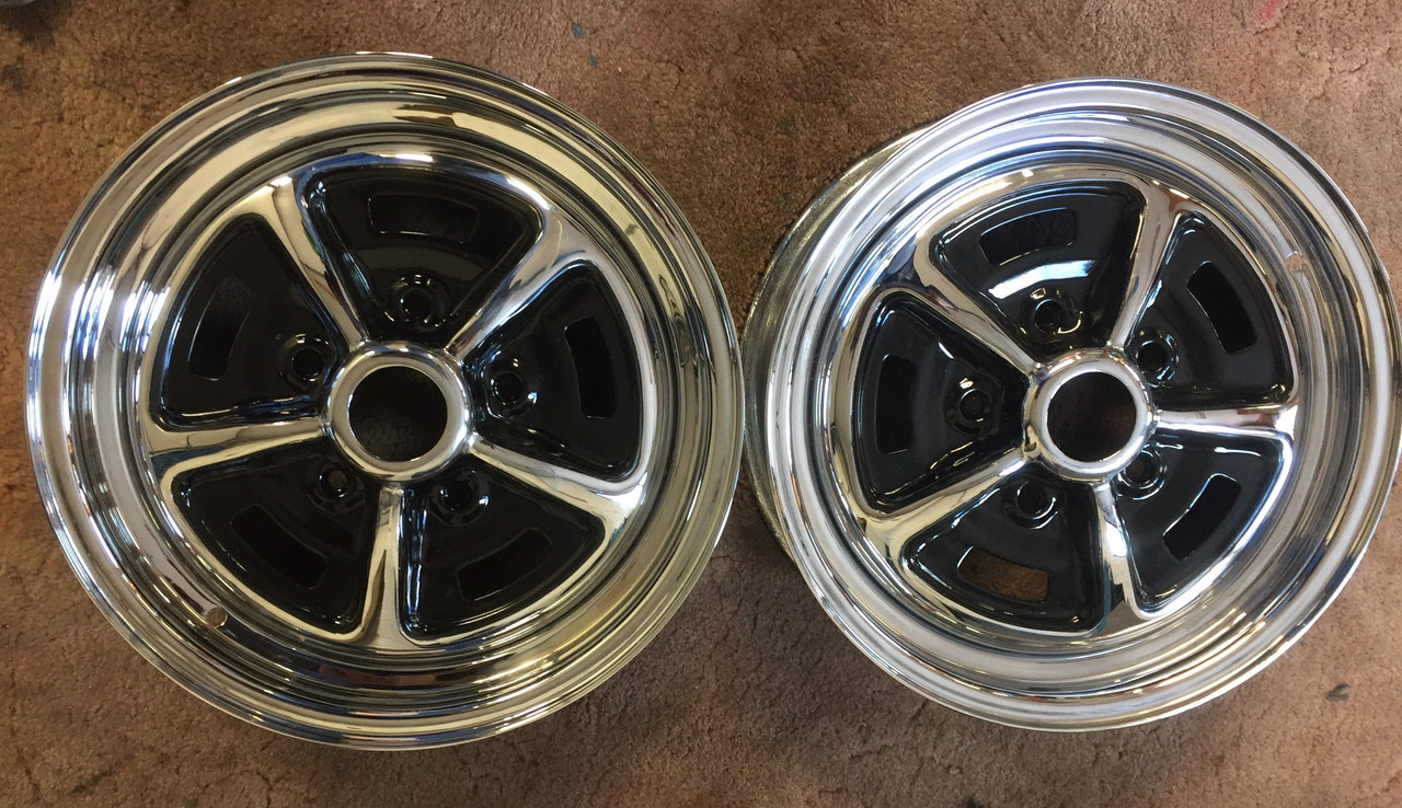

Exciting stuff, I love refitting a freshly painted car like that, cleaning everything before it goes back on....very satisfying

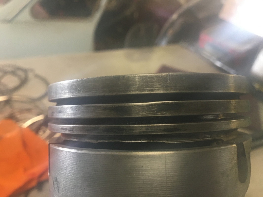

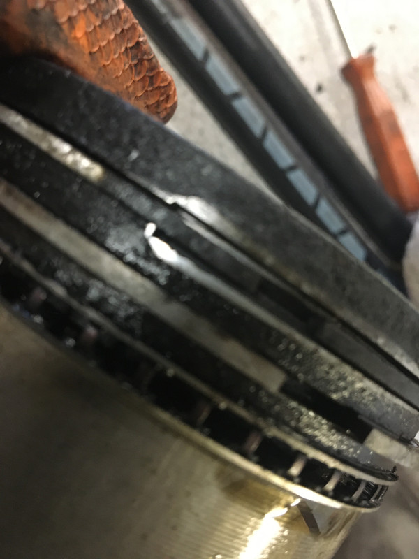

I’ve managed to get most of the engine built up but can go no further at the moment as I’m still stuck for a piston, possibly even 2 This is piston no1 This is piston no 6 No 6 would probably go again but if I can get a couple of good ones I’d rather replace it

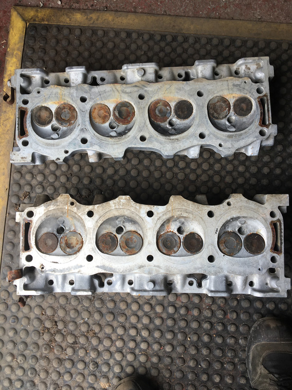

My attention turned to cylinder heads this weekend, so I stripped my pair of donated efi heads which were actually 3.5 carb Range Rover ones, not that it put me off. On closer inspection it was clear they had spent some time at the bottom of the pit pond & would need a full set of valves & guides & a skim. So I contacted someone else who told me he had a pair of 3.9 heads & he came up trumps, I now gave my sticky little hands on them & it turns out they are actually late type 10 bolt heads from a 4.0/4.6 They need a bit of a clean up as they have seen a bit of rain, but they seem to be in very good fettle, in fact I scotchbrited one this afternoon & it’s like new. The gasket faces look almost good enough to be able to plonk them straight on......obviously they will be checked & skimmed if required & I can’t fit them until I get my 2 pistons back in any way

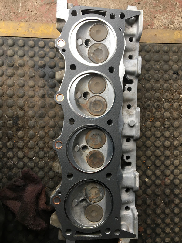

Might get another pair of gaskets just to be on the safe side as these have copper rings around the outer set of bolt holes not needed on these heads, just in case they don’t seal properly

Check the cyl head volumes if the heads are off a larger displacement engine.
