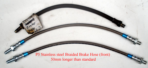

Braided hoses are the best thing you can put on any car when it comes to brakes. F1 cars have them so they are good enough for mine.
You will normally find those who knock em have never even tried em before.

I was reading about brake hoses recently, and some people believe braided hoses are a bad idea as the braiding hides any cracking or ageing from being spotted. Each to their own as always, but I went with a standard set when I replaced mine this year. The most important thing is to change them. I assumed that the Goodridge braided hoses were braided metal with no rubber - similar to the flexible hose on my shower, am I wrong ? is there rubber inside ?

As far as I'm aware braided hoses aren't actually rubber hoses internally but another, more resilient material, wrapped in braided stainless steel, which itself is generally, but not always, covered for further protection.
I've heard the argument that any internal degradation can't be seen and, technically, that's true, however, the material isn't rubber and is far less likely to degrade. Having said that, I haven't sliced one open to have a look. Another advantage of braided hoses is their ability to withstand higher pressures than rubber without bulging etc etc..
It's not a dissimilar situation to silicon coolant hoses v. the original rubber hoses. Personal choice.
Post by enigmas on Dec 20, 2018 22:51:00 GMT
My coupe is fitted with a full set of 'legal' (in OZ, Victoria) braided brake lines. They were custom fabricated at a brake shop to match the original brake line fittings. They comprise a synthetic inner liner, outer braided stainless sheath, encapsulated within a clear synthetic weather protection cover. Both ends are swaged. Rally/race car versions do not have swaged end fittings and can be disassembled. This type are illegal in Victoria on road registered cars. These flexible lines will not balloon under heavy braking and provide a firmer pedal than the OEM versions. NB. Never use brake hose clamps on this type of line. Front brake hoses. Rear brake hoses.

... I assumed that the Goodridge braided hoses were braided metal with no rubber - similar to the flexible hose on my shower, am I wrong ? is there rubber inside ? Yes and no George. No, they aren't just braided metal, as explained by the others, and yes, they are similar to the hose on your shower in so far as that also has a flexible synthetic tube inside it.
