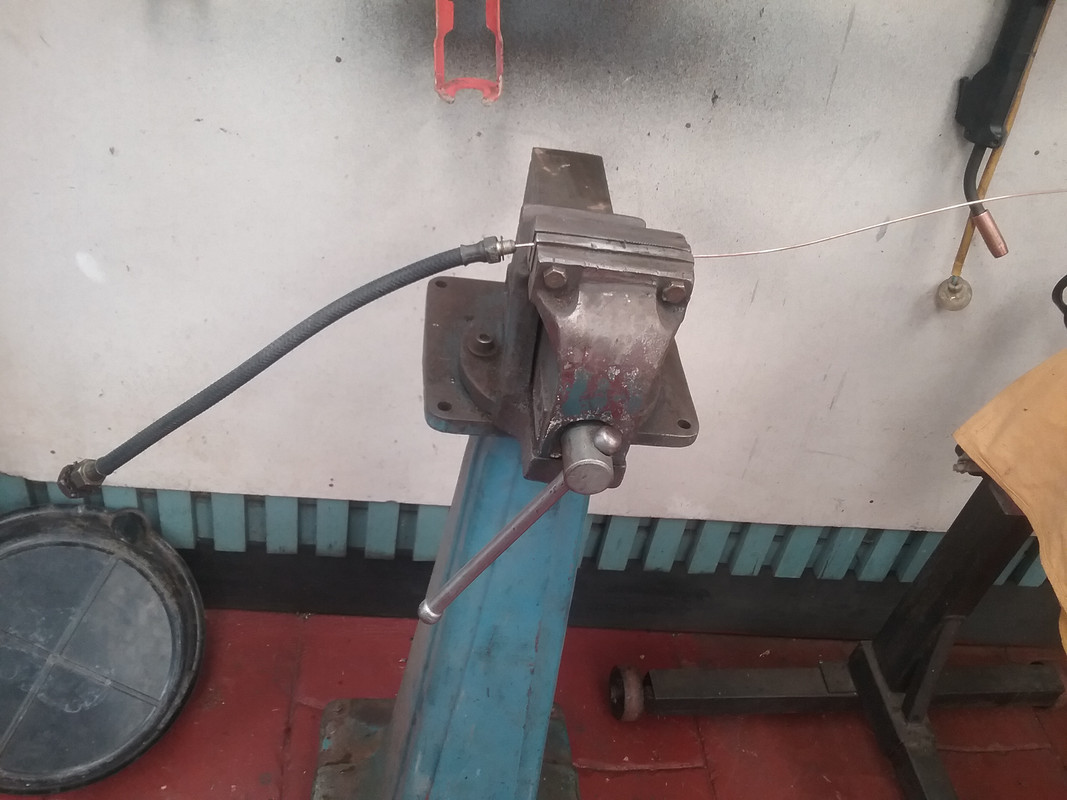

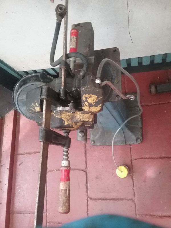

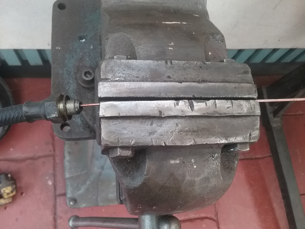

Faulty Brake Hoses(Allows fluid to flow forward under brake pedal pressure but not to return.) The above comment explains one reason brakes may either 'stick -on', drag or worst case scenario, lock! The caliper in the photos is for an MGB but fitted to my ZB Magnette. Both front hoses illustrate blockage and failure to return fluid to the master cyl. Method: The caliper was held in a vice and 2 small sash clamps used to retract the pistons. Exposed piston edges were cleaned and lubricated with brake assembly lube (gel) before being retracted. With both pistons clamped and pressure applied to the clamps fluid would not exit the open end of the brake hose. With one clamp removed and the other tightened progressively the free piston would move out from its housing. This was then reversed for the other piston. No fluid exited from the open ended hose. A clamp was placed on each piston again. Pressure applied. No movement occurred. No fluid exited the open end of the brake hose. The same process was repeated (as above) but this time the bleeder valve was opened. Fluid exited and the pistons moved inside their respective housings. * Note the TIG wire inserted into the brake hose...I was unable to pass it fully through! * Both front hoses were faulty yet appear perfectly fine externally. This is PS side refurbished and fitted with stainless braided lines.
