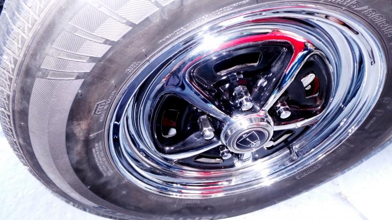

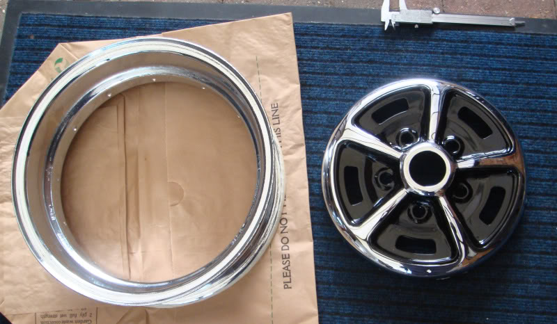

Newway wheels in Victoria can adapt rims to your centres. If you want them properly restored in the traditional manner expect to part out huge amounts of the folding stuff as these wheels were original riveted together! Its a long process on the wheels Vince I wanted a good job and it took 18 months to get the chrome done, no two centres are the same so you cant mix and match, I would never heat up the wheels for whatever purpose, I heard very recently some one was welding the holes up instead of riveting!! cracks come to mind never mind making sure the wheels are true! if anyone has wheels done by a company make sure you have a safety test certificate for every wheel

Very nice wheels John...the quality certainly is apparent.
