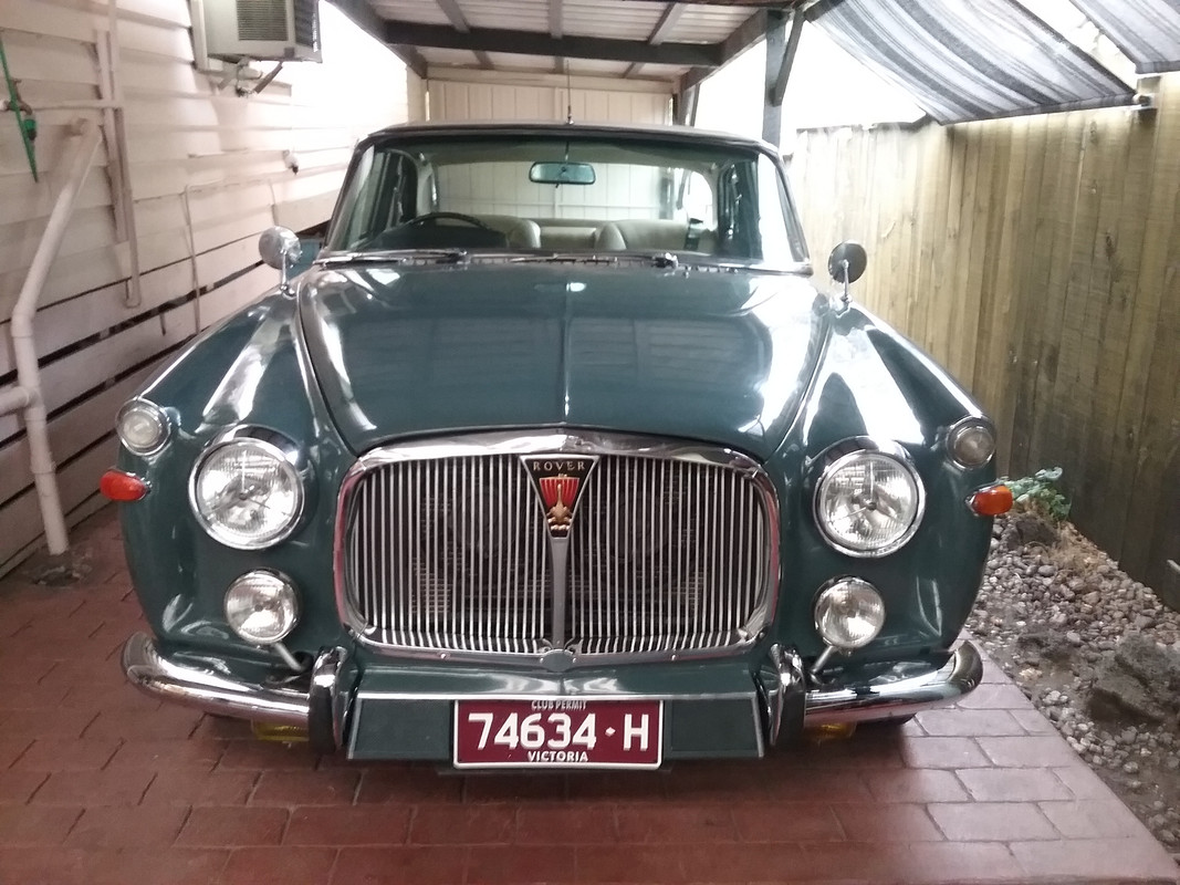

-1963-Rover-3-Litre-Mk2-pdf.pdf (46.27 KB) Hello all, well I've done the dirty deed and purchased this beautiful Stone grey with red interior Mk11 coupe. Although I have had numerous P6's I've always wanted a P5 coupe. I trust my photo will come out. I had other pics but although I have reduced the file size the site says the file size is still too large so I will work on that. It was purchased new in Sydney by the previous owner. It has spent its life variously in Sydney, Melbourne and Brisbane. To be specific it has 217,180 miles on the clock. Full maintenance records. A engine rebuild, new OEM materials interior and repaint at 177,000, and a DG transmission rebuild at 195,000 miles. The owner has kept a log of maintenance costs and over 57 years it has cost him $105,000. $1842 pa. It has zero rust and has only two problems that I can see. First, the right hand turn indicator has to be held down to allow the turn indicator to remain on, second the central Kenziel clock no longer works. David Green has sourced a central unvarnished locker for me install driving lights, sympathetic to the car. Ant so I can replace the central radio panel. I have to make one change to get a RWC ( MOT ) that is to replace the wing mirrors. Are Tex door mirrors the way to go. ? I would like to make one change and that is to install driving lights sympathetic to the car. Any suggestions. I receive the car in about three weeks, as the bushfires have made interstate travelling difficult Vince, there is a guy in Ballarat, Ash Barlow, that works on P6 and P5's only. Thanks to the P6 and P5 owners club.com.au for that information. .
Post by enigmas on Jan 18, 2020 13:16:51 GMT
Well that's good news that you've found a P5 specialist in Ballarat Lewis. These are the driving lights on my Mk3...French Ducelliers that I found at an auto jumble by chance and restored. PS. Post your images here postimage.org/ it's a free archive and there's no limit to how many you store. Then link the images directly to this forum. * Take a look where my side mounted external mirrors are mounted. I had no issues with these when it was transfered onto club registration (CPS) requiring a RWC...neither should you. The mirrors have been in place for over 25 years. Quiz the RWC guy...if he baulks go somewhere else.

Post by tonys on Jan 18, 2020 14:23:59 GMT
Lewis Congratulations. When you first see the total expenditure by the previous owner it looks fairly horrendous, until you realise the length of time and then it doesn't seem quite so bad. All relative, of course Unfortunately, I can't open the picture file but I dont know if that's a problem at my end or not - eta. ignore that, I've done it now, probably a bit slow coming up from 'down under' . It looks lovely.

Post by tonys on Jan 18, 2020 15:12:21 GMT
Looking at the photo, the mirrors appear to be fitted in a fairly standard position for those P5s that I've seen with wing mirrors, accepting that they were generally dealer fitted or diy fitment as, IIRC, they weren't available from the factory with mirrors.

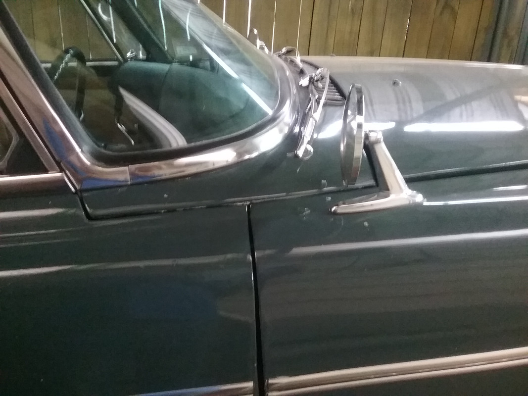

Post by enigmas on Feb 10, 2020 9:22:32 GMT
Here are the side mirror pix as promised Martin. They are fitted 10cm or 4" forward from the rear edge of the front mudguard/wing/fender. Note the fixing screws through the top of the mount. Both are easily viewed through the windscreen

Post by 3litrekiwi on Feb 12, 2020 8:14:47 GMT
Thanks Vince, the position looks like it is exactly where mine would be if the drivers side one covers the current aerial hole. I've found some that screw on with a base that is large enough to cover the hole however I would like to get the aerial out without taking the guard off if possible.

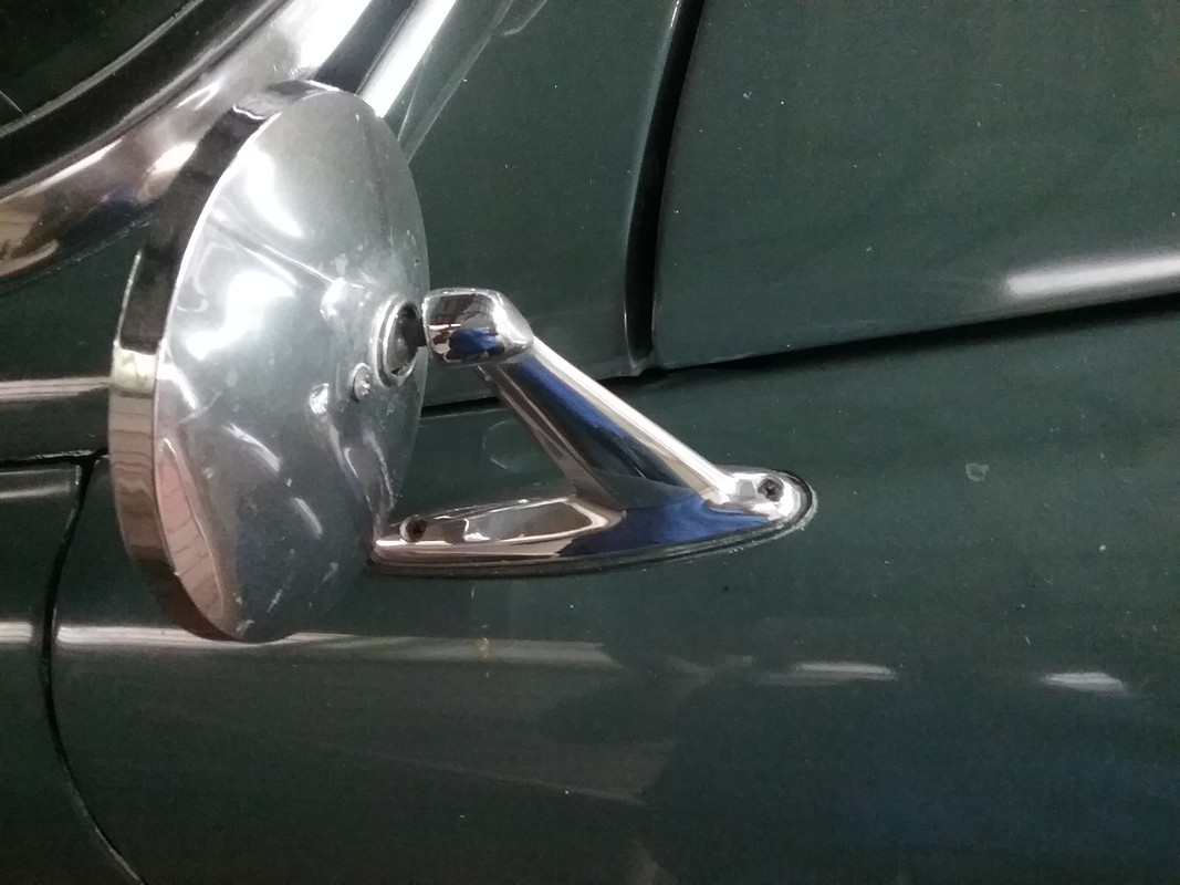

Post by 3litrekiwi on Nov 29, 2020 9:13:18 GMT
Post by 3litrekiwi on Nov 29, 2020 9:31:05 GMT
And the passengers side. I did need to machine the lock nut on the mirror to get enough travel so that I was not looking at the scenery beside the car rather than behind.
