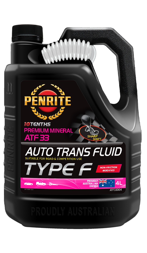

Post by enigmas on Apr 20, 2020 21:32:01 GMT
If you have a Penrite stockist they will have a suitable ATF for an older UK built BW35 (not Dexron) * Not very scientific but if the trans case is layers deep with grime (it's probably been there forever so probably needs a type F fluid) if on the odd chance it has been rebuilt with upgraded friction materials and requires a Dexron type fluid then using a type F will only firm up the shifts...it certainly won't slip and all the 'hard' pieces ( geartrain, torringtons, thrust washers) won't know the difference. If you were going racing with a BW35/40 you'd use the type F product. Either way If still uncertain talk or email the techs at Penrite they're very helpful and will steer you in the right direction. Here www.penriteoil.com.au/products/atf-33-type-f-mineral
Post by johnwp5bcoupe on Apr 21, 2020 8:11:42 GMT
I use Penrite Vince but in the UK they closed their depot/office and stockists are few where I used to get it from stopped selling the range of engine oils (in my case) and sell other classic oils which have no where near the ZDDP, I have never seen their Trans Fluid!!
Post by enigmas on Apr 21, 2020 13:01:31 GMT
Truly John, I don't understand the logic in that....there's obviously a very large classic car market in the UK (considering the population size) and certainly no shortage of flat tappet engines in these cars. Penrite as a business formulates lubrication for vintage, veteran, classic cars, motorbikes and related machines. I really don't get! Has your club or a confederation of clubs ever tried approaching the company (formal letter to their head office in OZ) and coordinatining some type of deal. If a an outlet can't be setup then surely the Club at the very minimum should be able to organise a bulk purchase of specific lubricants and have it (literally) shipped over. The last option would obviously mean carefully costing the product to ensure expenses are covered and financial members get it at a reasonable price. Perhaps something like this would be worth putting to the membership. My commiserations John on the lubricant situation...anyway that's my 2 cents worth!
