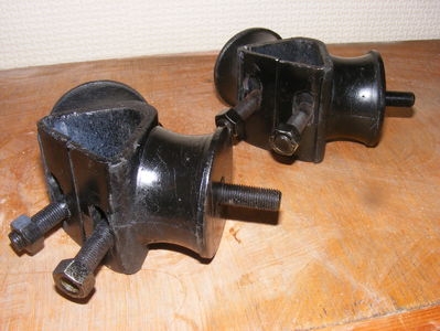

Although the springs on my rover had only flattened slightly I was concerned they would put new Y mounts under strain from shear. I made the position of the new high tensile bolts adjustable and added a sliding 4mm plate inside the mount to make it stronger. Even with the boot full and passengers in the seats the mount is now only under compression and when I do get new springs etc it can be adjusted to suit.

Although the springs on my rover had only flattened slightly I was concerned they would put new Y mounts under strain from shear. I made the position of the new high tensile bolts adjustable and added a sliding 4mm plate inside the mount to make it stronger. Even with the boot full and passengers in the seats the mount is now only under compression and when I do get new springs etc it can be adjusted to suit.  Kev, I'm always interested in any mods to the "Y" mounts but I can't make out what you've done from the image you've posted. Can you point out how the sliding plate is working and what high tensile bolts you're referring to? Sorry if I'm a bit thick but I can't see how it's working from that image. Thanks.

The bolts in the bottom of the mount were removed and the holes turned into slots. A steel plate was placed inside the mount laying flat on the base and two holes were drilled in that to allow the bolts to drop through. You can see the underside of the plate through the holes in the top picture.The bolts are high tensile they fit very close to the sides of the mount and the heads were ground on one flat to allow them to slide backwards and forwards. The picture shows the bolts pushed through the holes,after this they were welded to the plate to stop them trying to turn as the nuts were fitted.

The bolts in the bottom of the mount were removed and the holes turned into slots. A steel plate was placed inside the mount laying flat on the base and two holes were drilled in that to allow the bolts to drop through. You can see the underside of the plate through the holes in the top picture.The bolts are high tensile they fit very close to the sides of the mount and the heads were ground on one flat to allow them to slide backwards and forwards. The picture shows the bolts pushed through the holes,after this they were welded to the plate to stop them trying to turn as the nuts were fitted.  Thanks for clarifying. A neat solution to reduce the shearing force. For even flatter springs the elongation could be increased considerably.

The old Y mounts were in a bit of a state.

The old Y mounts were in a bit of a state.  I can see that the modified bracket is about 1/4" inwards of the spring compared to this old image. That should take a good part of the shearing force away. Good solution. My old mountings looked very similar to yours but were still very sound and holding well to the metal. The rubber was still serviceable and there was less cracking than the new ones I fitted a couple of years ago have now. A testament to the quality of the original metalastic rubber formulation which has now been lost to us due to various regulations. In fairness to the new stuff, the rear springs on the majority of P5's have lost their camber to some degree so the new "Y" mountings have more shearing to contend with. Interestingly, your original mountings have the extra large washer inside as did mine but the new "Y" bush leaves no room inside the mounting bracket. I reused the large washers on the outside of the mounting bracket where you have used the original small washer. I don't suppose it matters.

The old mounts looked worse than they were as they had been covered with underseal which had gone hard and cracked,one was coming away from the metal. I had tried making mounts from engine mountings and had found some machinery mounts that were strong enough. In the finish I bought the Y mounts from Wadhams and they do seem to be very well made.
