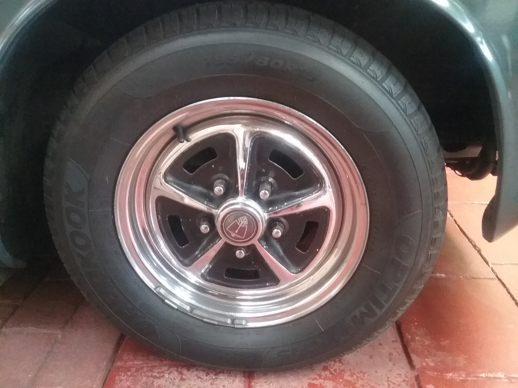

No criticisms guys...but 205s are illegal on 5" inch width rims in OZ but perhaps not the UK. Tyre fitters generally won't fit them to rims that are not of the appropriate size. They may look good (to some) but on a 5" width rim there would be considerable side wall flex and squirm when turning into corners and bends especially with a modicum of speed. This is even more pronounced if 205 tyres with an even higher Aspect ratio is used. (Aspect ratio = Tyre height in relation to width) The best handling/steering/braking performance is usually with tyres of the lowest Aspect ratio...there's little to no squirm or sidewall flex to compromise steering input. Try it...if you have access to a set...the steering especially (even with the factory PS) is transformed. This is to say nothing of aesthetics which is personal taste and subjective. I have a range of rostyles and tyres to choose from some at 185/80/15, 225/60/15 (fitted to widened rostyles) and 185/60/15 shown below on the front of my coupe. The lowest aspect ratio tyre fitted to the front provides the best steering input and handling. I swap these with 185/80s as is my mood....a bit like shoes These are usually fitted to the front and sometimes the rear. and these are on the rear currently.

Great advice and thanks for the detail and pictures which show your points off great.
