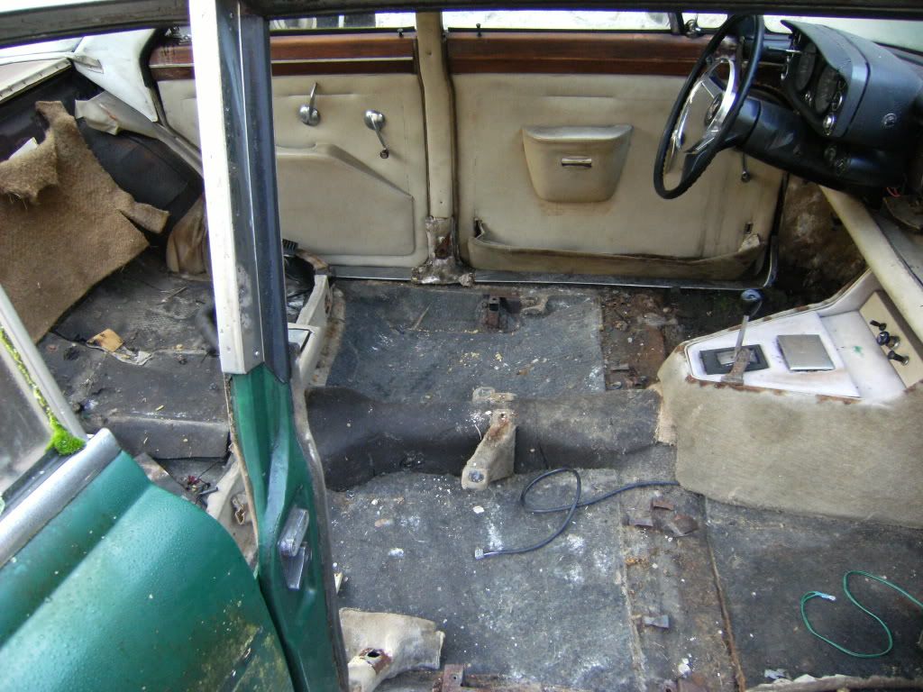

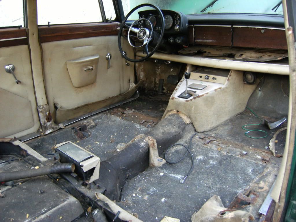

Hi, I open this thread to show what's under or behind what we see in our cars when we drive them. I dismantled a P5B Coupé three years ago for parts and I made pictures during the process. I don't know exactly how to do: either I post pictures on a regular basis or I do it "on request" if you want to see a particular area of the car. Let me Kow, any advice welcome. Of course, your own pictures are welcome in order to create a big pictures data bank Let's start by what the interior looks like without the seats and carpets

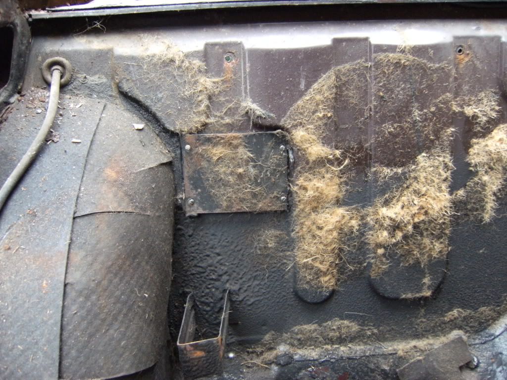

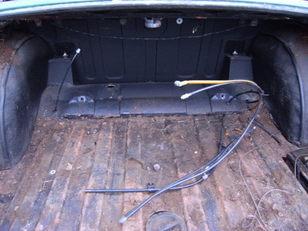

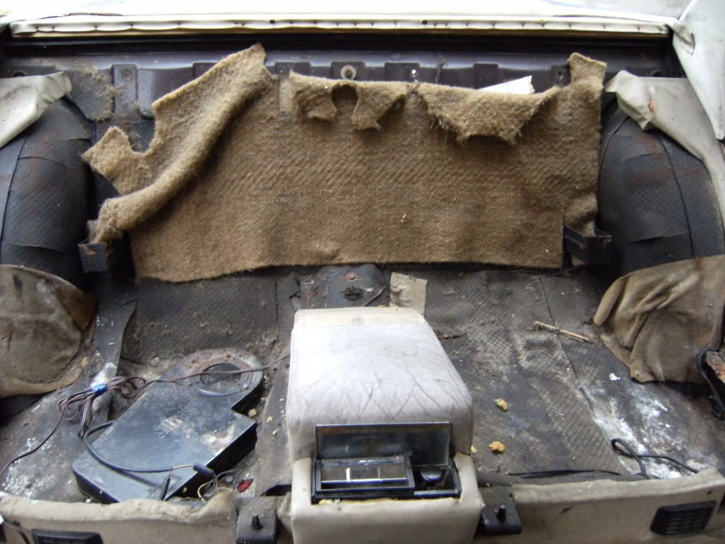

Well tonys, I'm a Rover nut and I collect the David Bache's work: he designed all the cars we own. we have Classics RR, a SD1 2600 VDP, a P6 2200TC (my daily driver) , a series III Land Rover and two P5B Coupé (both are RHD silver Birch, one has an engine problem so doesn't drive) All the cars drive once a week at least. Let's see what's in the boot:

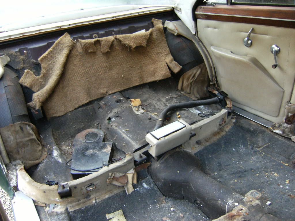

Post by cyf on Sept 27, 2011 11:00:24 GMT

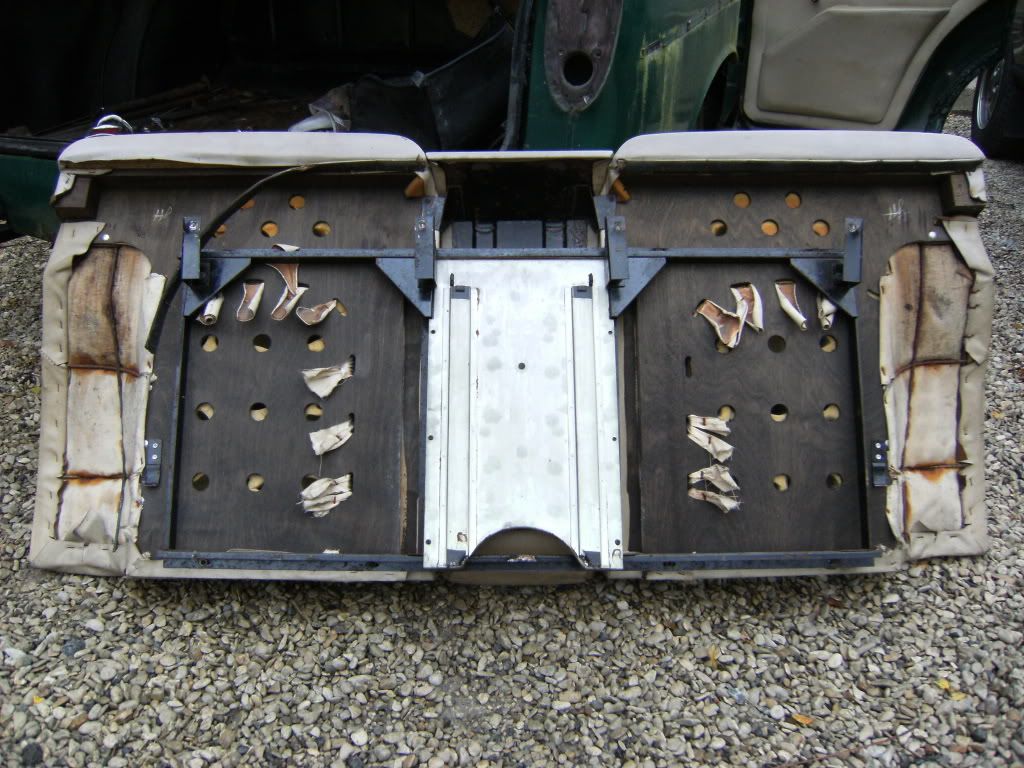

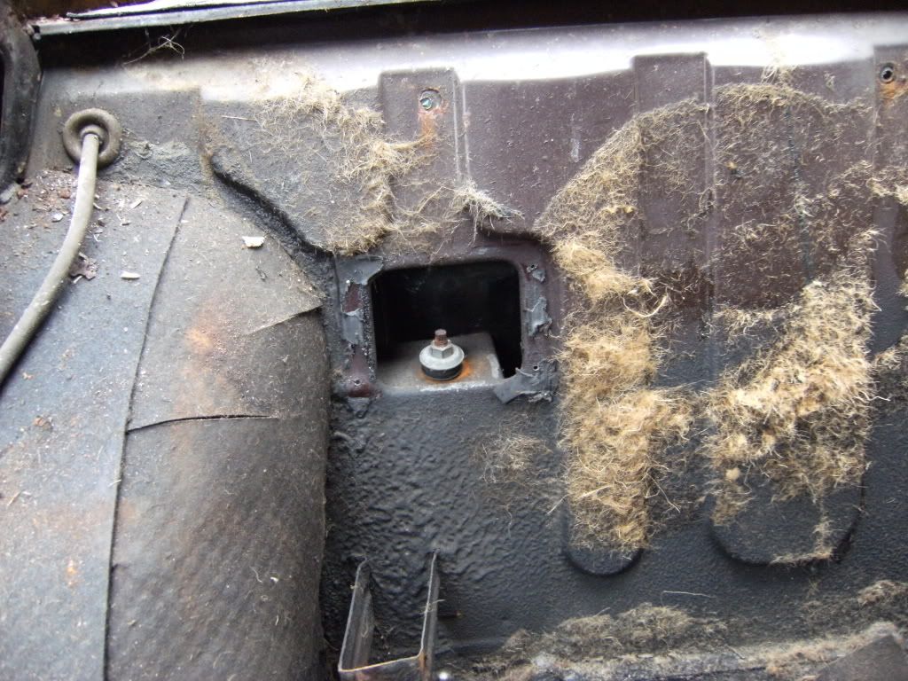

When the fuel tank is removed, you can see the upper mount of the rear shock absorbers. An other acces to them i behind the rear seats: And the back of the rear seat

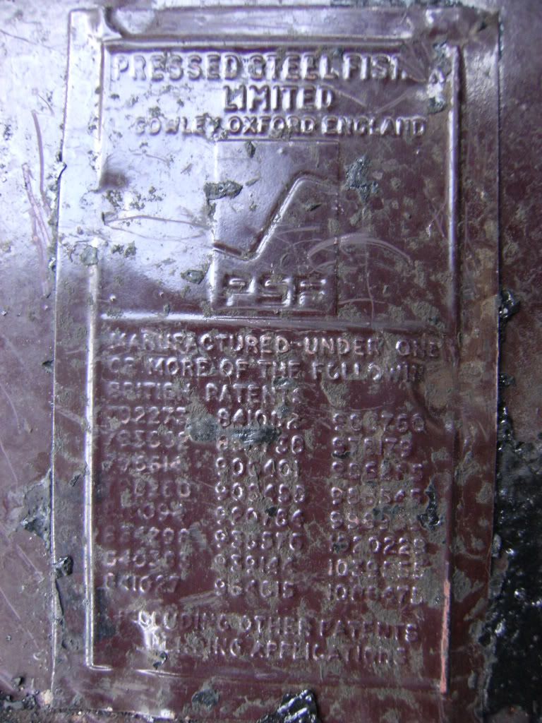

That's right,, they are well made cars There was this plate on the bodywork from Pressed Steel Fisher
Post by Dean Hovland on Sept 28, 2011 1:54:20 GMT
Cut it out and it spray a nice admiralty blue and then put into a picture frame. "Rover art "

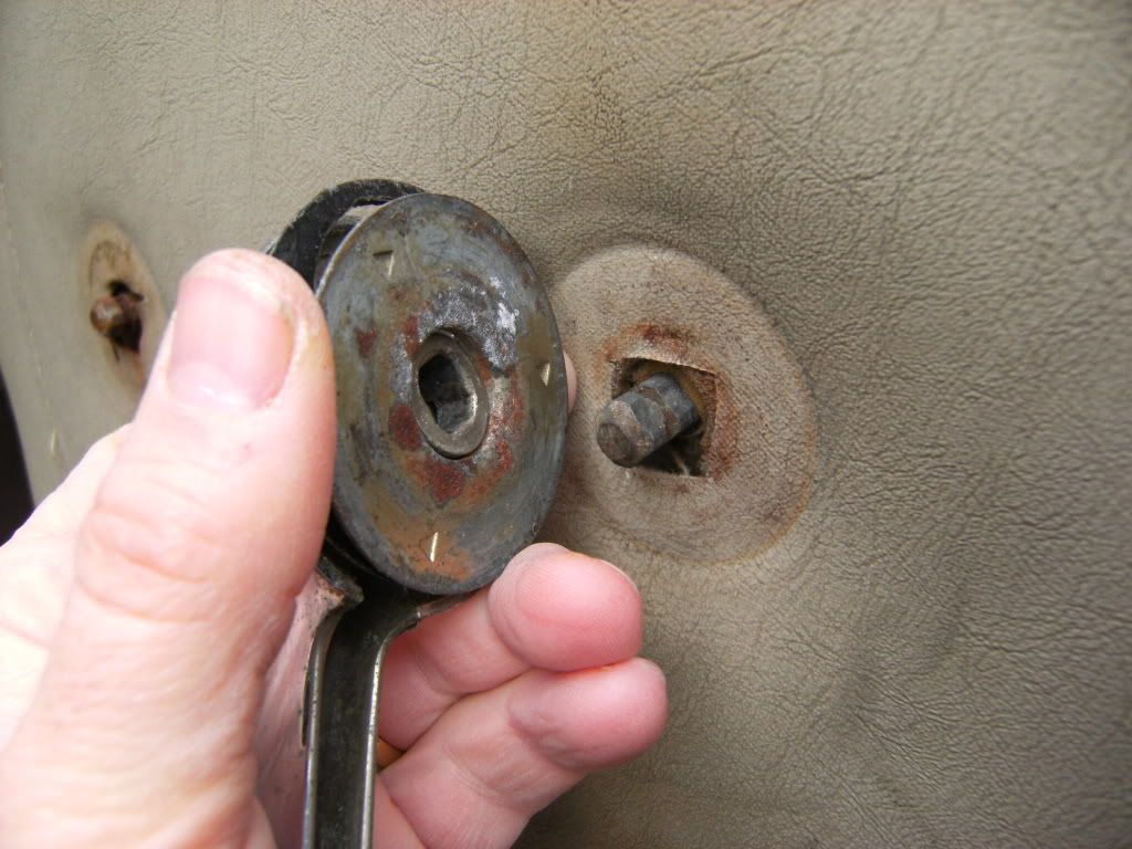

Post by cyf on Oct 2, 2011 8:31:06 GMT

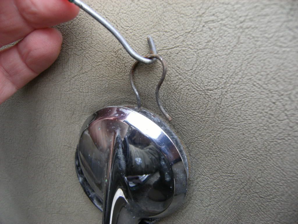

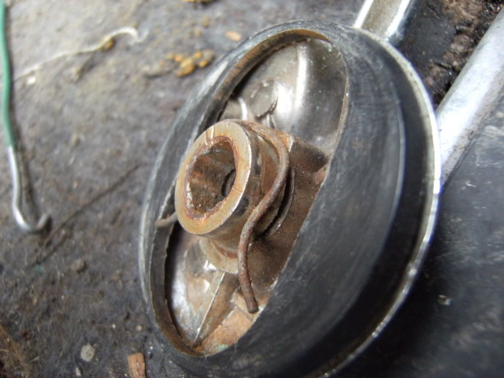

Thank you Glenn. That was my first dismantling and I had no WSM so i made lot of pictures to remember how the car is made. For instance, how to remove the handle If you want to see something in particular, just ask, may be I have a picture of it.

When I was first fiddling with cars, people in the trade down here referred to those as Jesus clips. This was because people often tried to remove them by lifting one side with the end of a screwdriver. It was named after the exclamation that was often made when it flew off and disappeared.

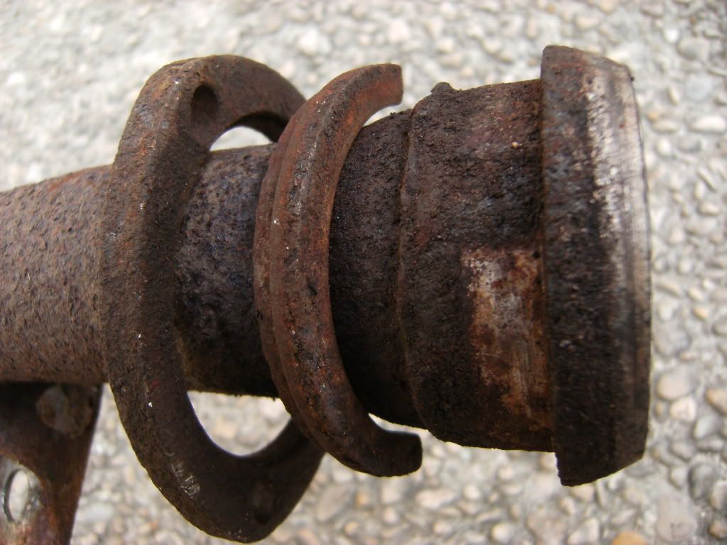

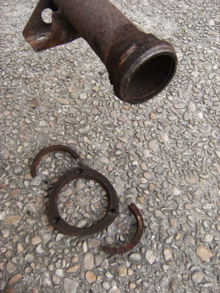

The flange and collar assembly on the exhaust system

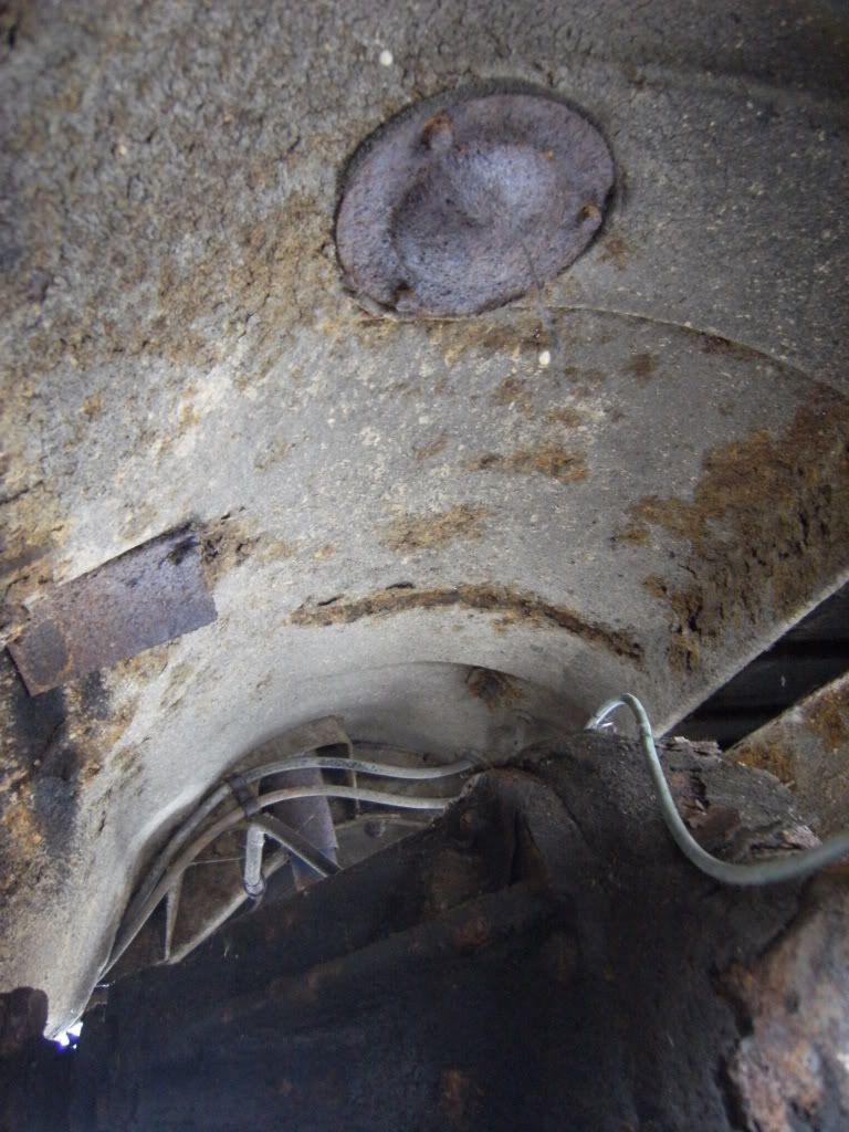

Post by cyf on Oct 4, 2011 20:10:21 GMT

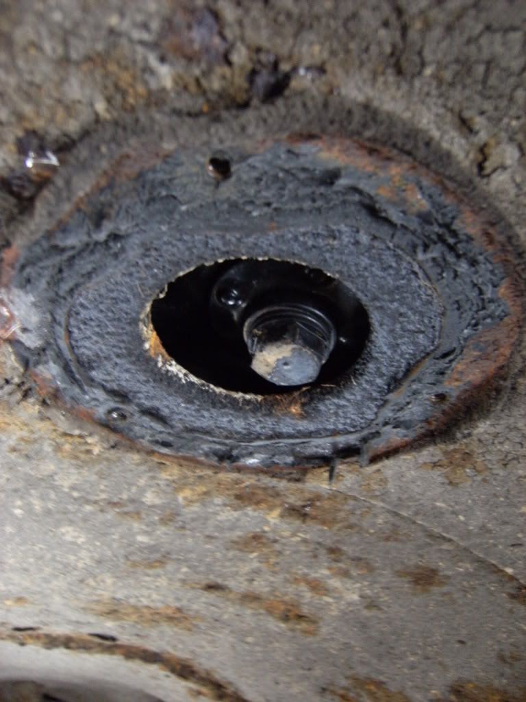

You need to drain your fuel tank? Remove the round plate above the rear axle and behind you'll find the drain plug

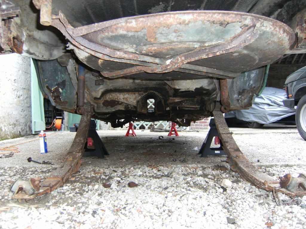

Brilliant photos, any chance of seeing the chassis legs and how the rear suspension fits to shell? Thanks

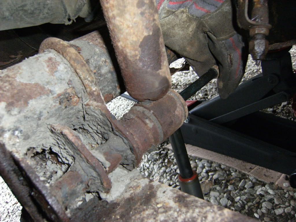

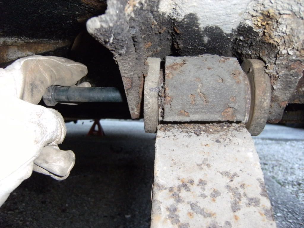

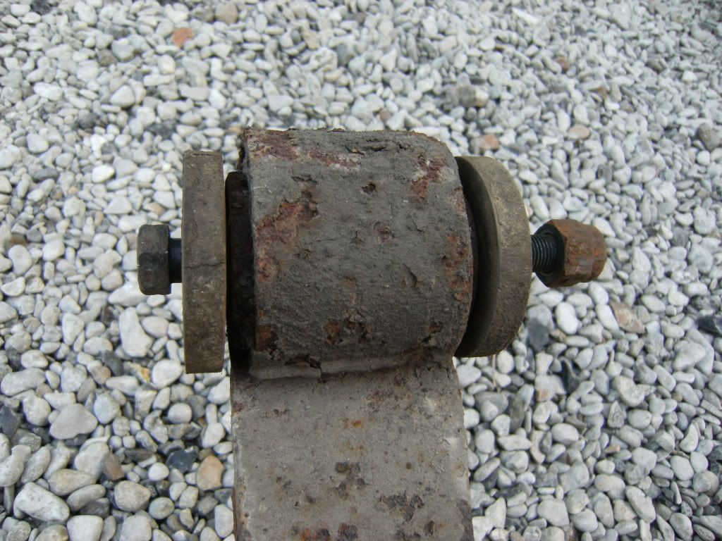

Post by cyf on Oct 26, 2011 20:13:45 GMT

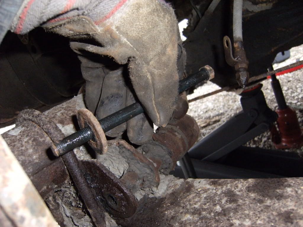

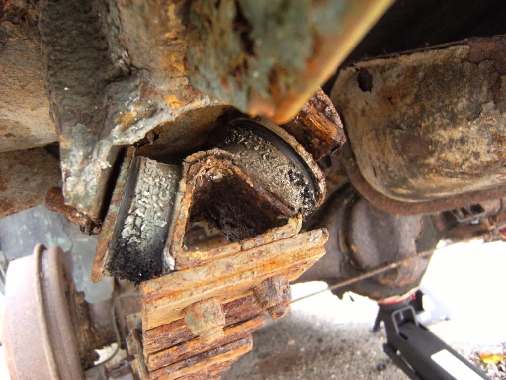

Thanks fortnum 1977. What do you mean by chassis legs? For the rear suspension, I have this: The leafs front fixing The leafs rear fixing, Y bush The rear shock absorbers lower fixing The body without the axle
