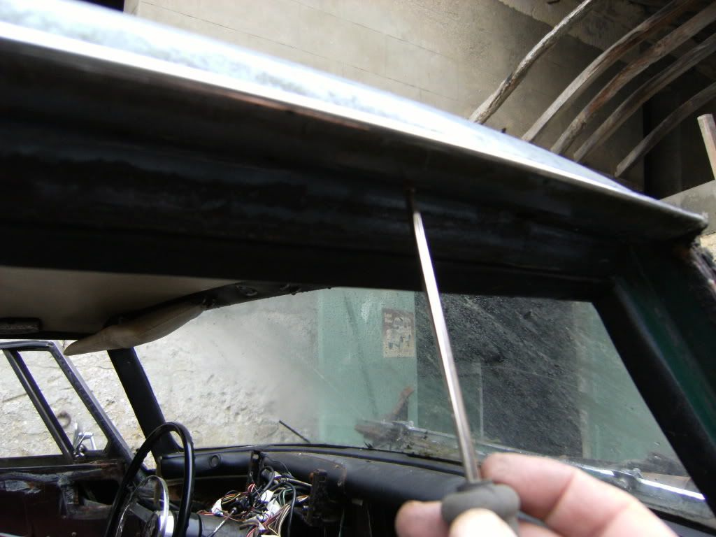

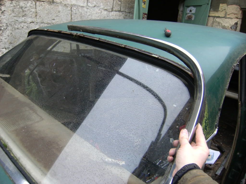

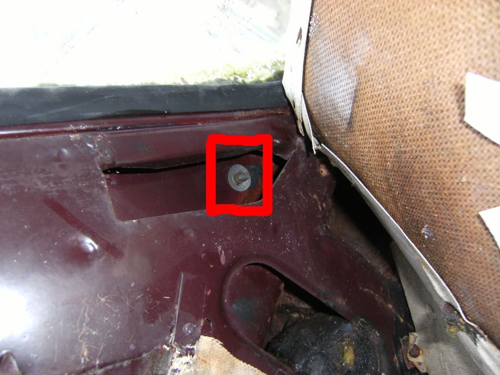

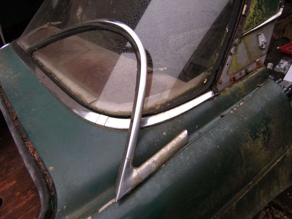

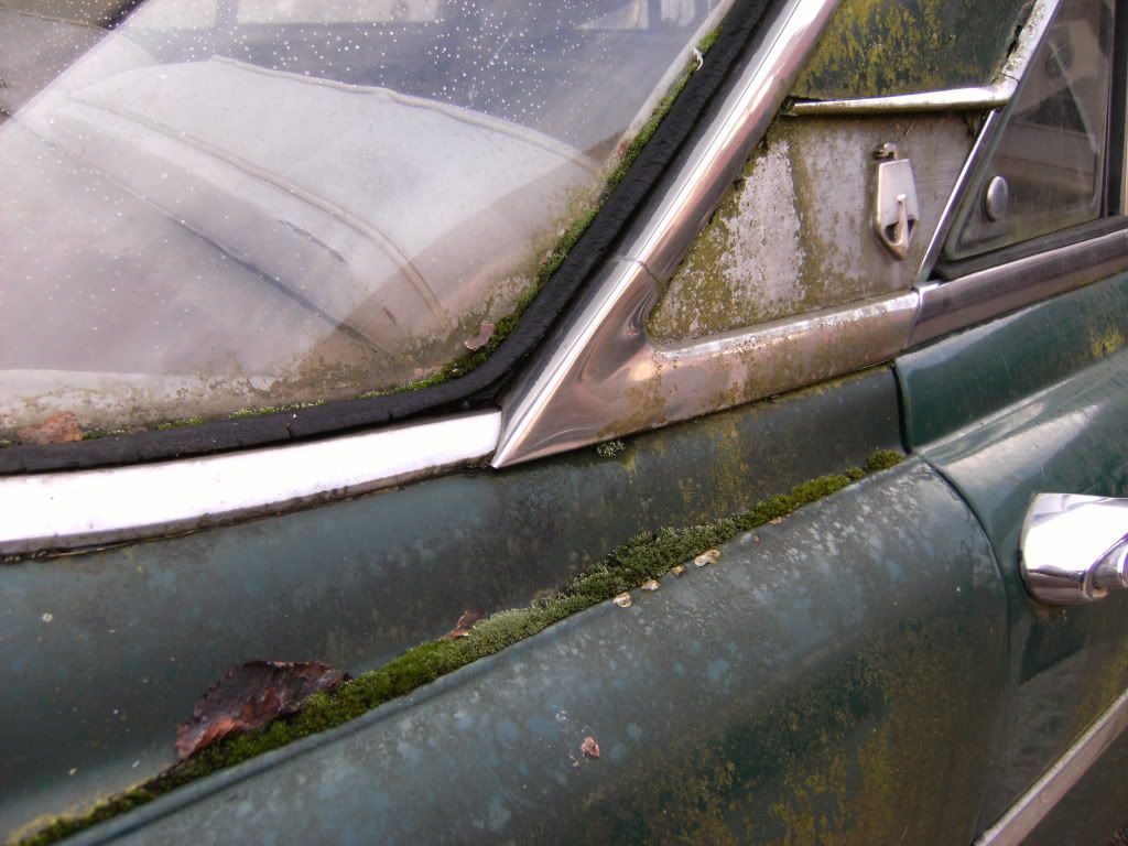

Let's go on with the chrome work removal. The parts of the rear window The clips, different than the front ones upper ones lower ones There's a trick to remove this part There's hidden screws and bolt/nut in this picture In order to remove the chrome surround of the rear window, you must remove the trim of the C post to undo the nut Then you can remove the plate Under the plate there's a black sticky material And under the material there's the screws for the end of the roof chrome edge The chrome roof edge is removed by undoing the screws

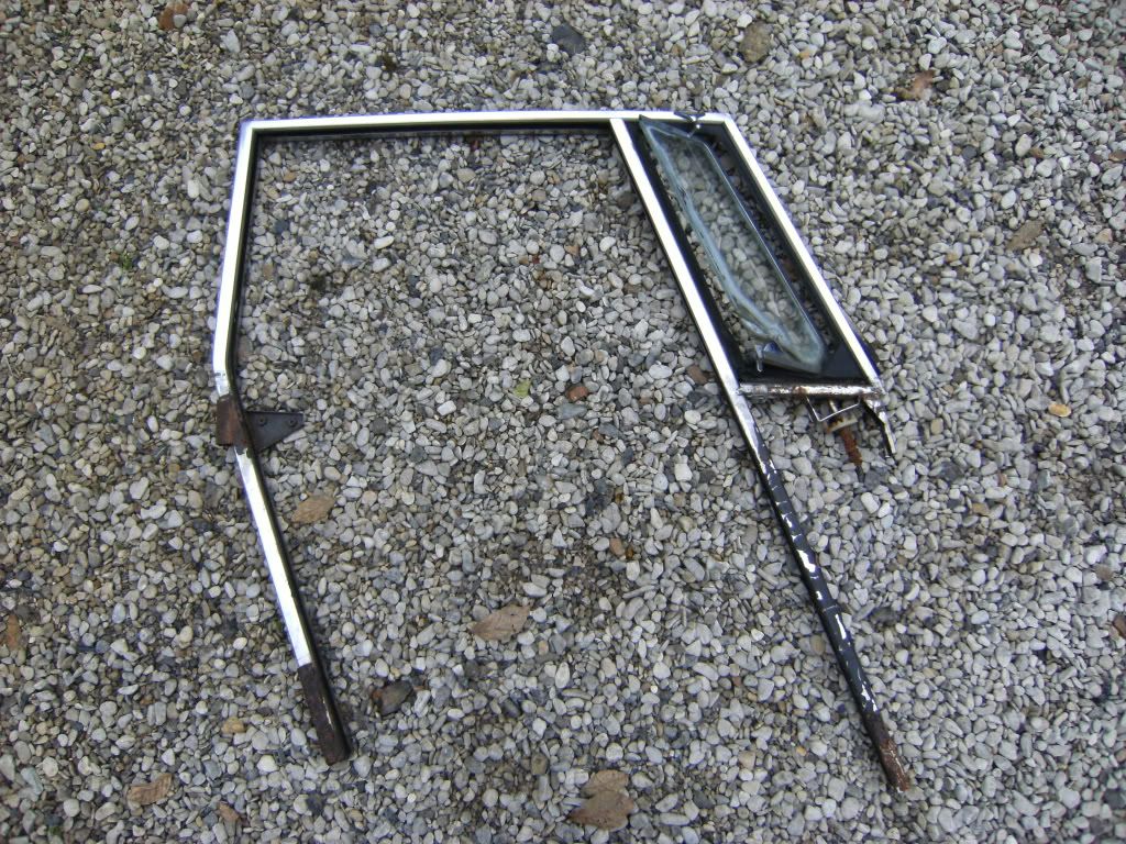

Post by cyf on Dec 21, 2011 18:25:43 GMT

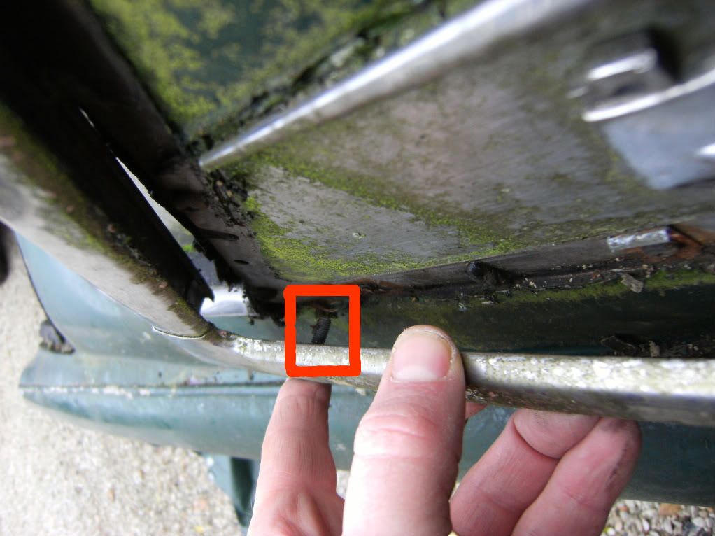

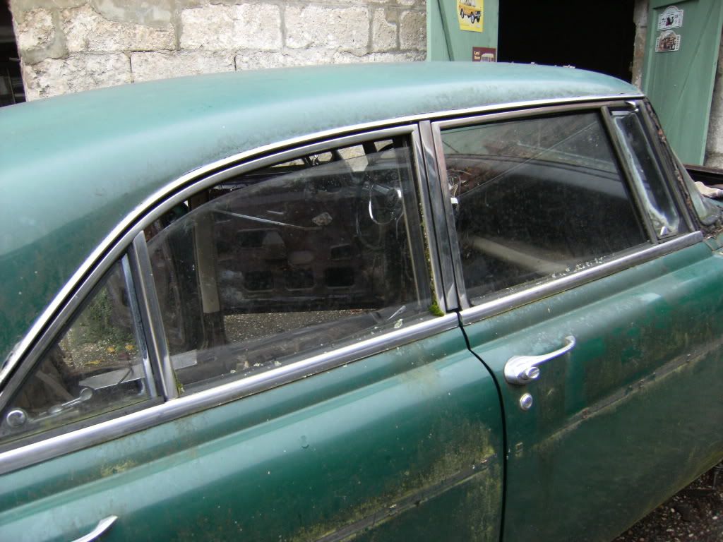

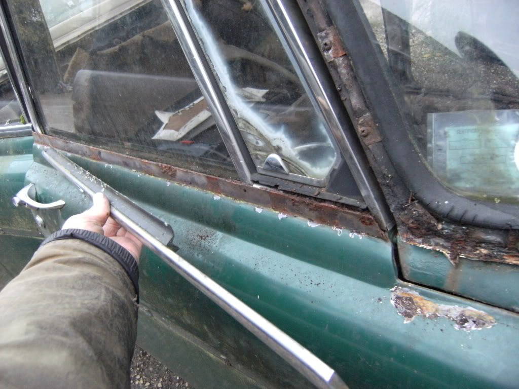

The end with the windows frame Front and rear The door top chrome And at last before/after

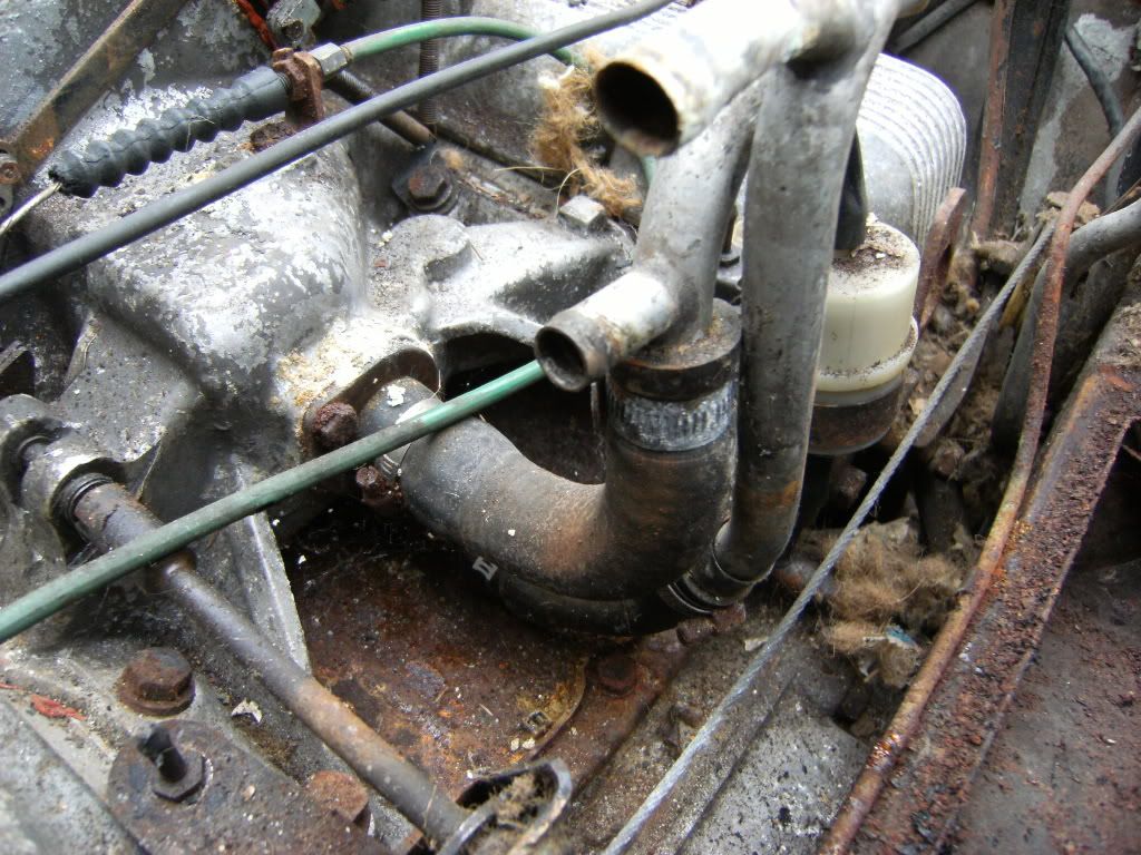

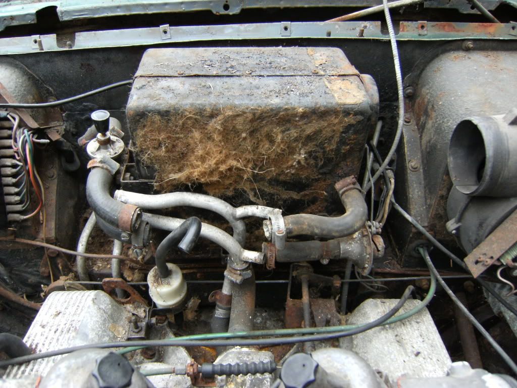

As it's winter time (well, not for you Warwick), let's see the heater The heater and blower removed the rear side of the heater matrix the inlet and outlet hoses and pipes The pipes on the inlet maifold The rear heater

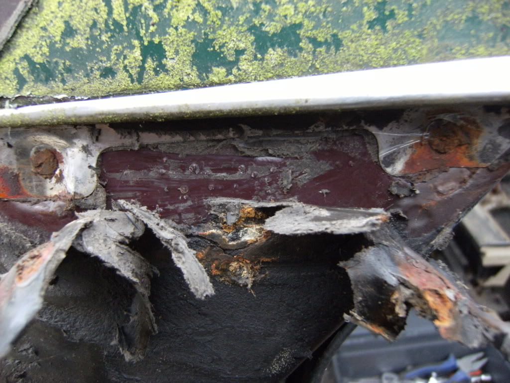

Post by Phil Nottingham on Jan 3, 2012 23:02:37 GMT
This is my Coupe I am rewelding again at the moment
Post by johnwp5bcoupe on Jan 4, 2012 7:17:39 GMT
You will have to stop feeding those Tin Worms Phil and get another pet I thought you had your new D posts in
Post by Phil Nottingham on Jan 4, 2012 17:36:54 GMT
Only part - I am rebuilding the sill on this side first
Post by cyf on Jan 4, 2012 20:19:54 GMT
Now I understand your point of view. The Coupé I dismantled looked as new compare to the one on the picture.... But I'm absolutely not able to deal with that amount of rust

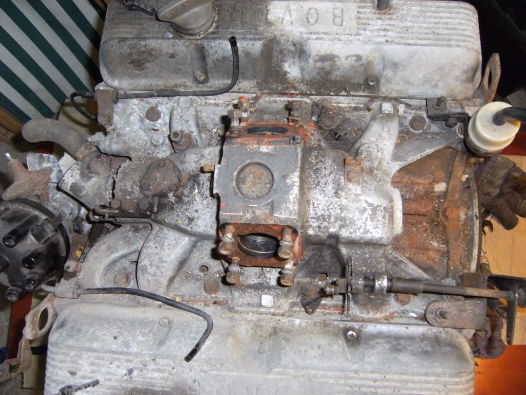

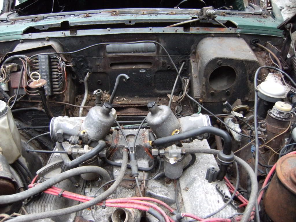

Post by cyf on Jan 4, 2012 21:15:14 GMT

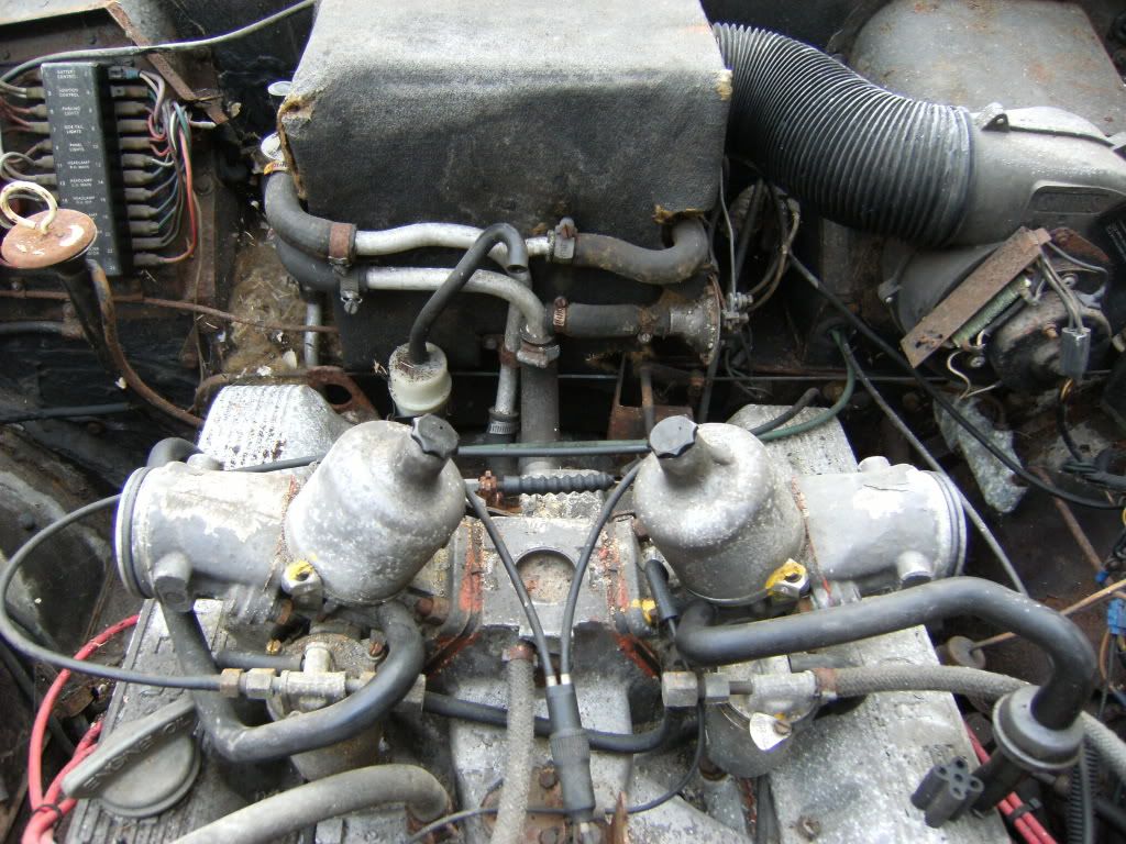

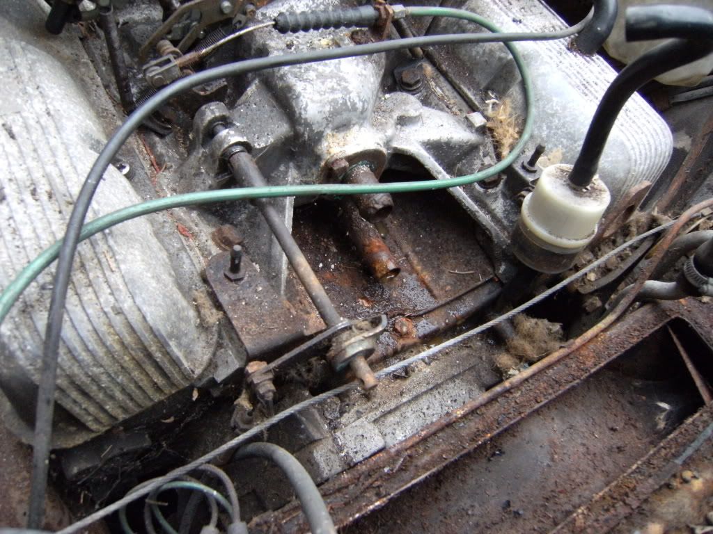

The inlet manifold With carbs without carbs The engine without the manifold the hidden face of the manifold

That pipe is a menace - its not the outside which is problem its the inside which corrodes unseen and blows under the 15lb pressure and leaks away unseen as it runs away and dries up
Post by cyf on Jan 9, 2012 20:10:38 GMT
That's interesting. It's a place to check when there's a loss of coolant and you see no leaks
