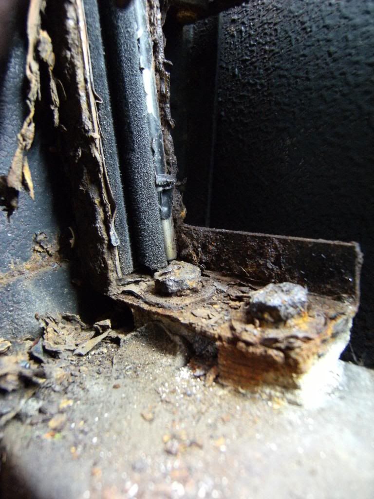

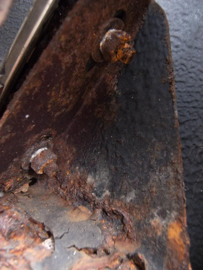

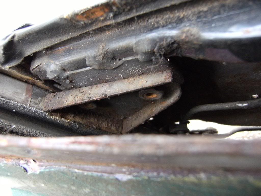

Many thanks for the door lock photo's, great help. Would you have a simple 'how to' set of removing the window frame from the door ? I seem to have undone every bolt and screw I can see and it still won't move. I'm obviously missing something, I just hope it's not too many brain cells

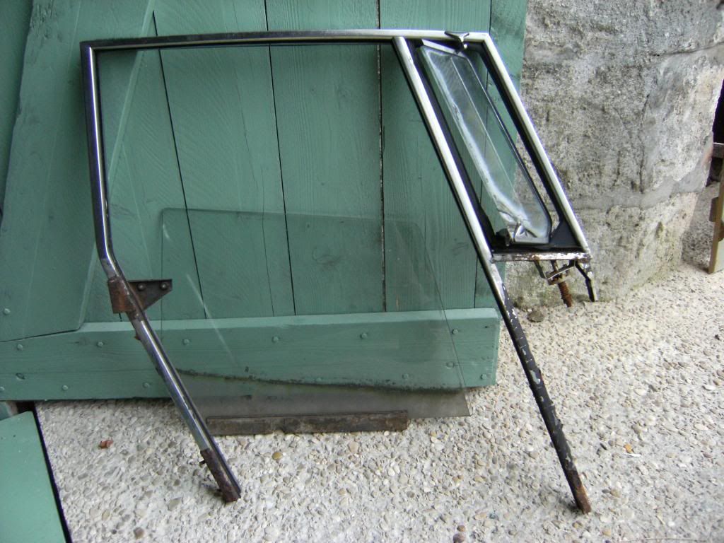

Hi Adrian, I'll see if I have pictures of the frames removing. At least I have this one at the moment but not very helpfull Kev, the correct spell is "aide mémoire" it was very close

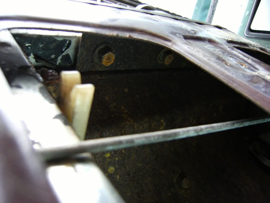

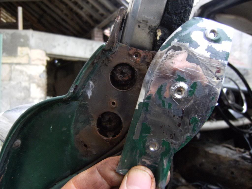

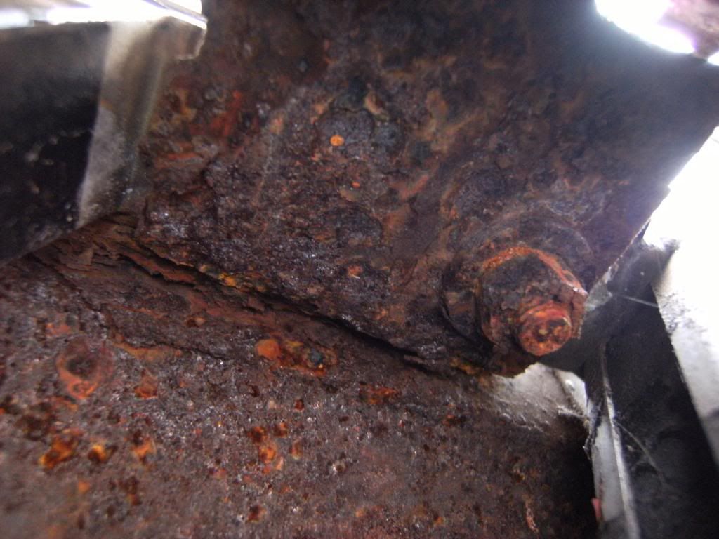

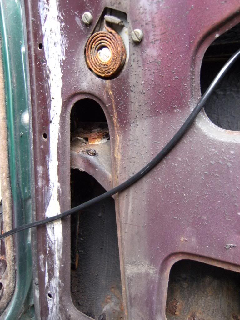

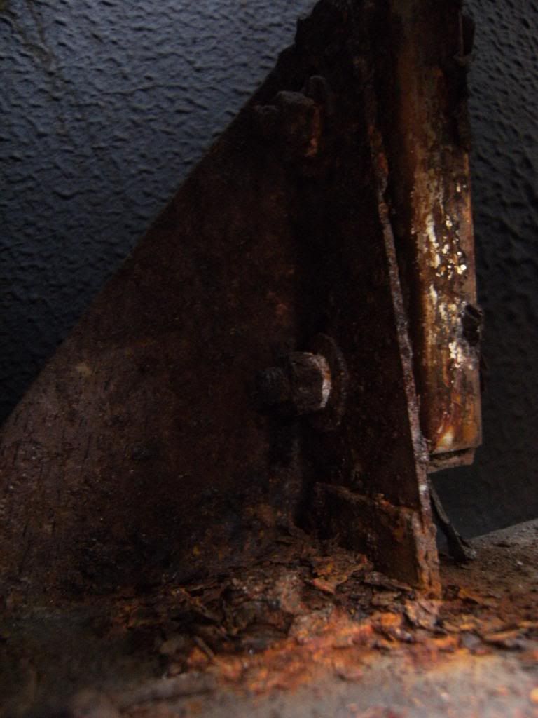

Post by cyf on Jul 24, 2014 10:40:20 GMT

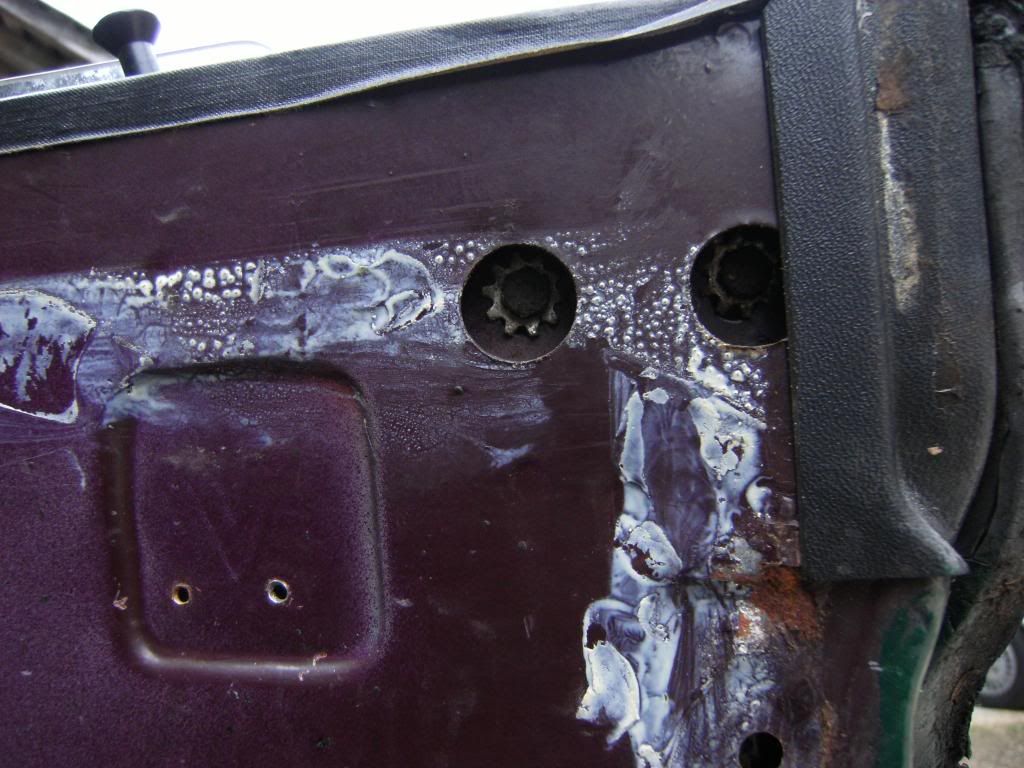

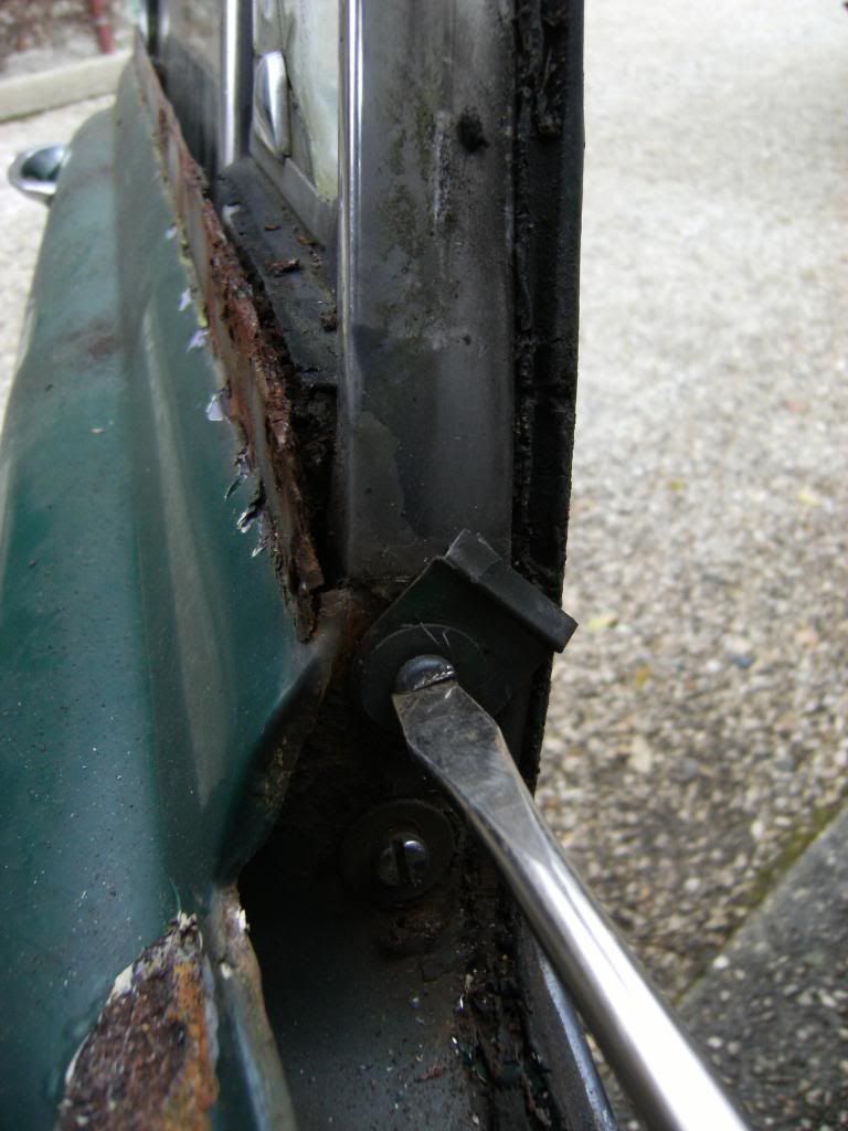

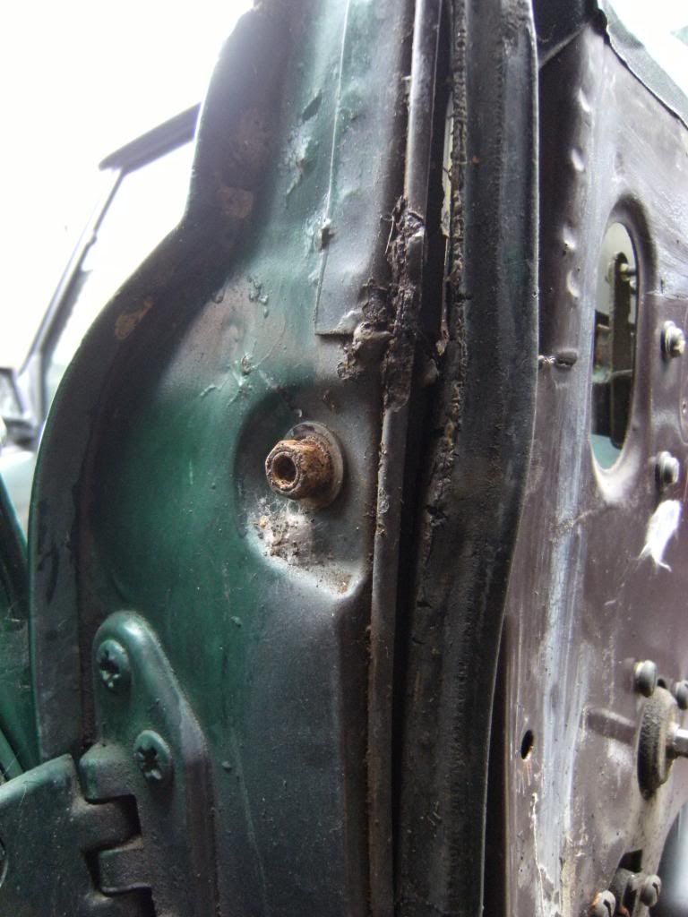

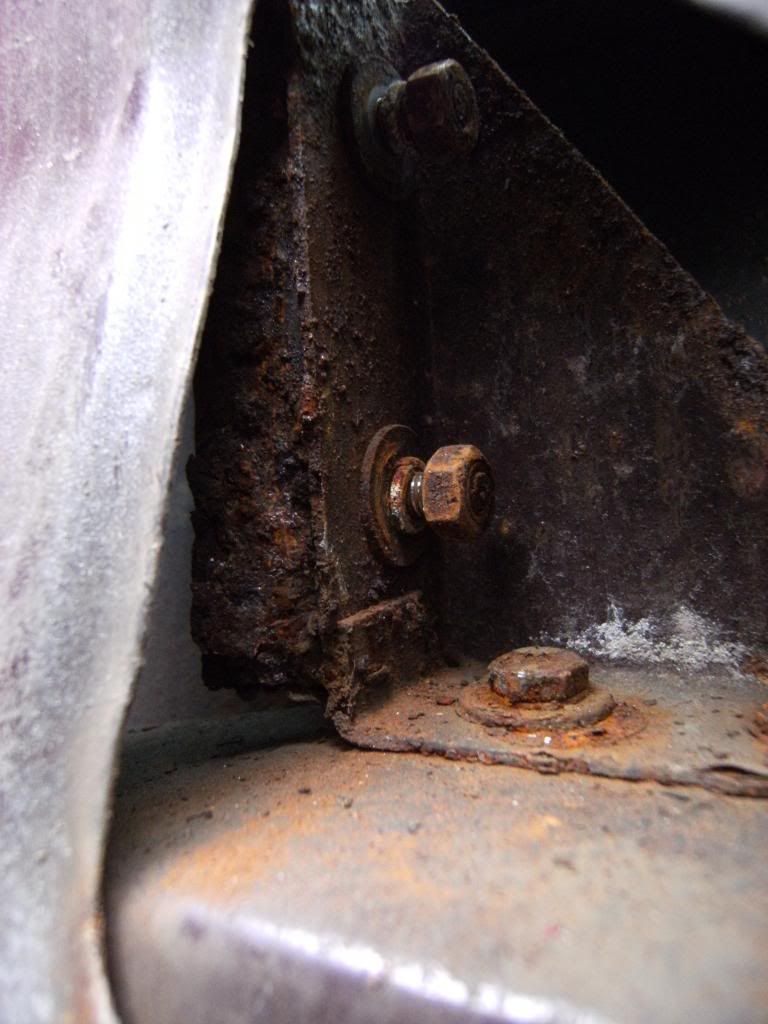

I found pictures for you FRONT DOOR (note that pictures are not always the same side) The Frame. You can see where it's bolted to the door THe nut under the quater light The screws on the front of the door The screws at the rear of the door, hidden behind the plate (may be those ones you missed?) Two bolts at the rear of the door on the side Inside view Nuts at the rear and front, inside the door

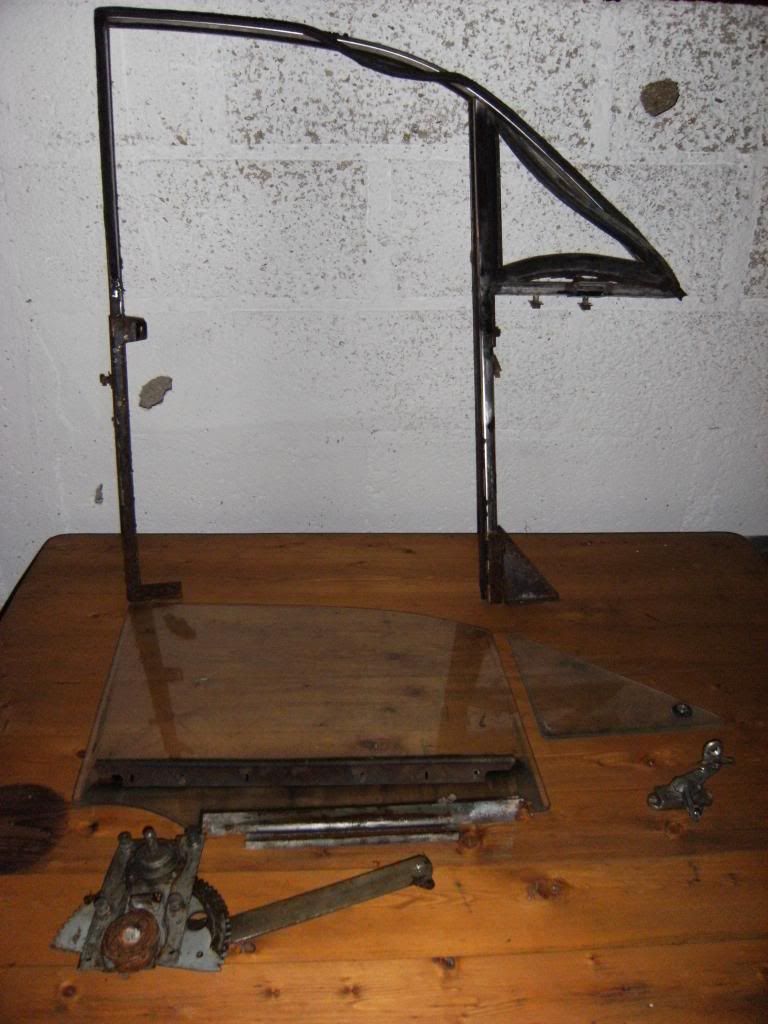

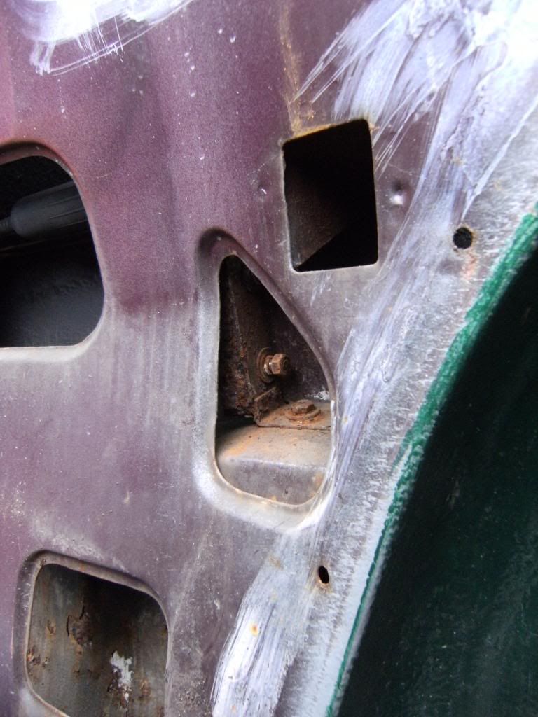

Post by cyf on Jul 24, 2014 10:59:16 GMT
THE REAR DOOR The frame Bolt on the front Nuts under the quarter light Nut at the front Fixings at the bottom Rear Front

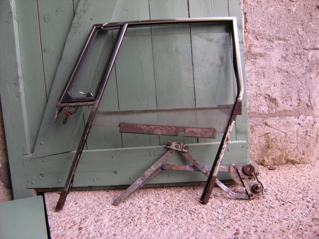

Hi there do you have any pics for removal of window winders plse
Post by johnwp5bcoupe on Jul 1, 2019 7:55:49 GMT
Hi there do you have any pics for removal of window winders plse Window winders do you mean the handles? if so they have a spring clip which you have to remove with a piece of stiff wire bent over at the end to form a hook, if you push the large washer/protector into the vinyl you should see the clip! If you mean the winder mechanism it's a case of winding the window down removing the screws holding the mechanism, then sliding the window out of the channel and the best way you can remove the mechanism out through the opening in the door "MIND YOUR FINGERS" there can be sharp pieces particularly around the quadrant!!
