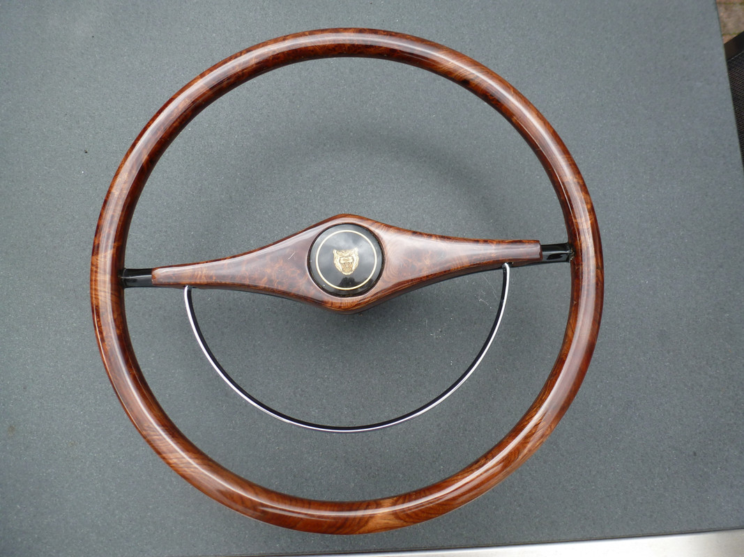

I can supply a modified Rover steering wheel. The steering wheel diameter can be reduced with approx 4 inch. All the bakelite is being removed and replaced by epoxy and the outside rim can be replaced by mahogony, burl walnut light or dark. The LH one is reduced 4 inch in diameter and with a high gloss mahogony rim and the RH one is finished in mahogony in matt finish and with a 30mm thick rim as specified by the customer
Above the LH one in mahogony and 4 inches reduced in diameter, the RH one also 4 inch reduced and in dark burl walnut Underneath a Jag MK2 steering wheel in light burl which also can be done to the Rover steering wheel There is a pretty good match with the original mahogony wood Peter

Hi Peter these look very impressive indeed. Can you give any indication of the likely cost for the different options you have shown?

I still have my laced after market leather Steering Wheel cover from the 70's for me the original wheel is part of the character of the P5 classic interior, why try to make it look like a Jaguar? but it's not my car
Post by Brendan69 on Feb 5, 2020 10:30:13 GMT
I have to say they look lovely albeit i agree with John and would not do this on my P5B. However i did use a company in the UK called Mertyl Prod who did my steering wheels on my Daimler and Bentley of which both were awesome and blended perfectly with the rest of the cars interior wood packs.
Post by Ken Nelson on Feb 5, 2020 15:44:05 GMT
Those are certainly beautiful wheels, although the original wheel on my 1966 P5 Rover is certainly in keeping with the style of the 60's, especially over her in the USA. The original is very typical of the General Motors cars of the 60's and I will keep it. But I wouldn't condemn anyone for putting one of those gorgeous wheels on their car.

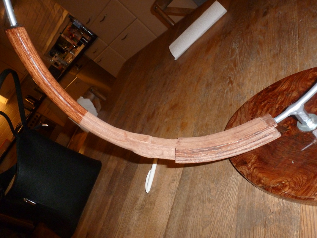

Hi Owen, Price for an exchange steering wheel where all the bakelite is replaced by epoxy is Euro 375,- excluding shipping. This looks identical to the original P5 steering wheel. Currently i do not offer a reduced diameter for these. but if there is enough interest, i can make a jig for one. The steering wheels with the wood rims are all Euro 525,- excluding shipping on an exchange base. The mahogony ones are made out of mahogony strips circular wound so that the grain pattern is circular and have the finger grips on the back side. The proces is shown in steps on the picture underneath Peter
