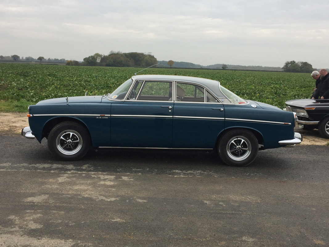

Hi there, I just rebuilding a Rover P5/B Coupe, LHD, build in 1973. I want to assemble the original wing mirrors, but I do not find something about the original position on the wings. Who can help me and send me the measures. Thank you for your help. Best regards Lutz from Hamburg
Post by johnwp5bcoupe on Dec 30, 2019 21:46:25 GMT
Hi Lutz welcome to the forum There is no fixed position for the wing mirrors as long as they are on top of the wing bulge! mine are just forward of the wheel centre see pic and give good coverage
Post by Phil Nottingham on Dec 31, 2019 17:10:56 GMT
They need to be approx over the centre of the front wheels as it makes them more useful in reversing

Thank you for your help. I have retrofitted JDM Fender Mirrors at my Datsun 280Z. For this one, I took the original dimensions from Datsun. I like to drive with them and took the same dimensions for my Rover Coupe. The Fender Mirror Position at the rover is approxymately 1/3 of the Fender from ahead. Attachment Deleted
Post by davewright on Mar 25, 2020 14:22:13 GMT
Lutz My understanding is that Rover never fitted wing mirrors and they are all dealer fitted items. Unfortunately dealers put them in different places. I have two replacement wings of different cars both of which came with holes for mirrors. One is on the top of the bulge and the other in the dip. The first is better because it will fold all the way around whilst the other hits the bonnet. They both give a good view and cover blind spots nicely and I find them a useful addition to the door mounted mirrors I have.

If you want the image of a truck on your tail to look larger than 1/16", then you should have the wing mirror as close as possible to your eyes. When I used to ride a motorcycle in London, I found two sets of mirrors to be optimal. The first set were mounted on the handle bars, around 18" from my eyes. They were ideal for close work - London traffic. The second set were mounted on the fairing at approximately 36" from my eyes (outstretched arm). They were more useful than the close ones for motorway traffic. I have found where the mirror was mounted on the replacement wing I used on my coupe: Wing undergoing a trial fit. You can see where I welded up the hole for the wing mirror: just in front of the trailing edge of the bonnet (although it could I suppose have been an aerial). None are fitted on my coupe. Caution though that the mirror is not obscured by the A pillar.

FWIW, mine are right underneath the quarter windows (see the profile pic!) and that's exactly how I want them as it makes it so much easier to adjust them. I do ask myself though as to whether the wing mounted ones provide a better view, particularly as everything seems to be sort of too close resp. "zoomed" ...
