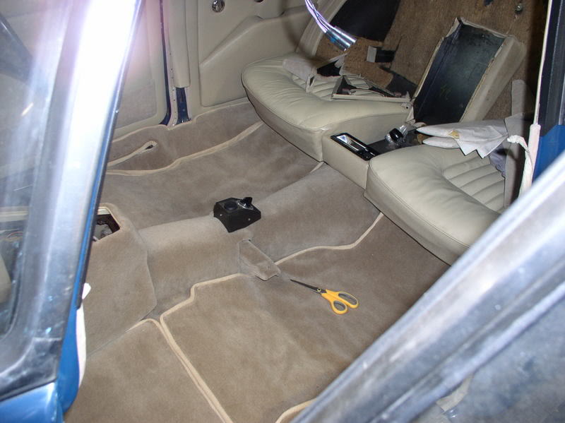

Post by johnwp5bcoupe on Feb 21, 2019 21:14:57 GMT

Post by johnwp5bcoupe on Feb 22, 2019 8:43:59 GMT
It's a shame to cover that up, John. There is a lot of hard work that is covered up Richard, my carpet came from Woolies as did all the stuff I used The binding was a pain to get the correct colour lots of washing and dying but I wanted to match the original carpets which I used as patterns, it was a thick old sandwich the carpet plus the 1/2" backing plus the edging, the picture is of the first fitting, I also made over mats to match ![;)](//storage.proboards.com/forum/images/smiley/wink.png) I learnt a lot doing the complete interior and I can understand why done correctly it takes time and money! ![](https://i.postimg.cc/QCchgtQp/P1010253.jpg)

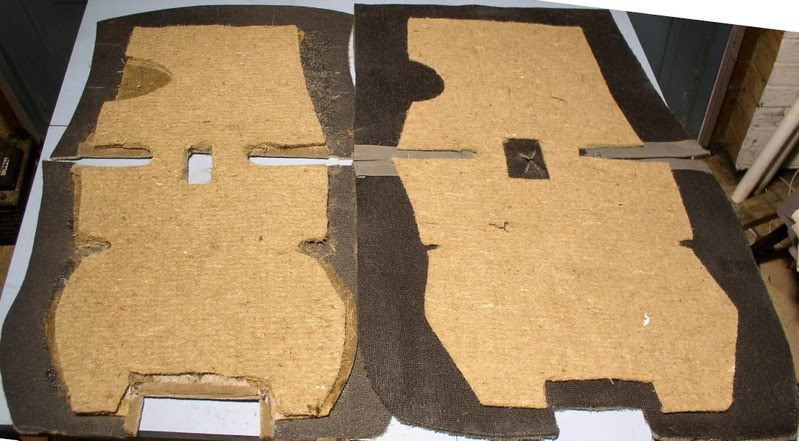

Post by johnwp5bcoupe on Feb 23, 2019 10:12:09 GMT
Original tunnel carpet on the left I think you can see the difference! ![](https://i.postimg.cc/HnbHL7rq/Tunnel-Under.jpg)
Post by velvet on Feb 23, 2019 11:23:04 GMT
. i use an original P5 tunnel felt section John which is expanding foam filled (for stability) and i use it as a template and shaping block, so i place the new felt and carpet on it and shape and form and adhere the new carpet to the new felt then remove the new felt and carpet section as one piece and fit it in the car and apart from making life easier you more importantly get a 'crease free' job. Attachment Deleted
