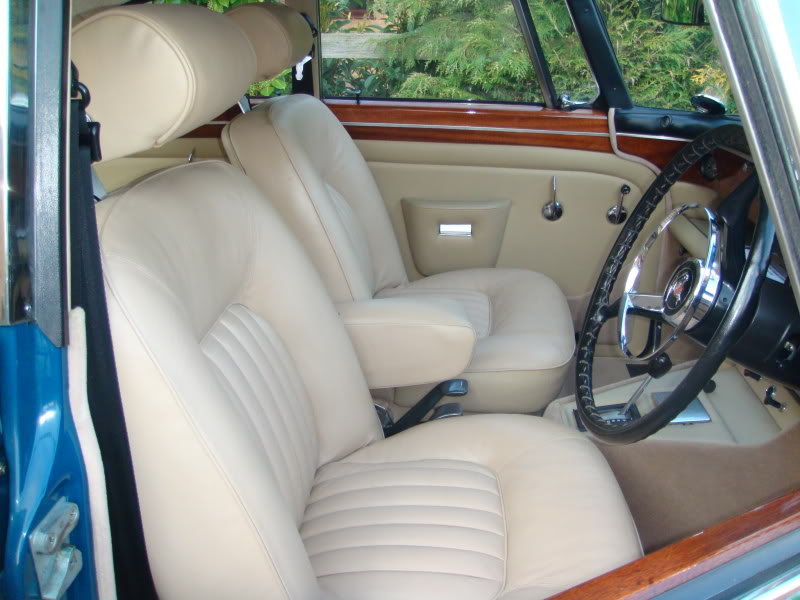

Finished a full re-trim on this beauty yesterday, No expense spared on this one, full restoration and all running gear powdercoated including seat frames and other ancilleries. & stainless nuts and bolts where possible with buffed-up carb elbows & pots etc... She looks stunning ! Screens to go in next week by somebody who's done them before, (fingers crossed on that one, hope he does a good job) and all new and rechromed and polished brightwork to follow after that including wheels, she really is superb! . Attachment DeletedAttachment DeletedAttachment Deleted

Finished a full re-trim on this beauty yesterday, No expense spared on this one, full restoration and all running gear powdercoated including seat frames and other ancilleries. & stainless nuts and bolts where possible with buffed-up carb elbows & pots etc... She looks stunning ! Screens to go in next week by somebody who's done them before, (fingers crossed on that one, hope he does a good job) and all new and rechromed and polished brightwork to follow after that including wheels, she really is superb! . Wow, she really does look fantastic!👍 A really lovely job Mick.
