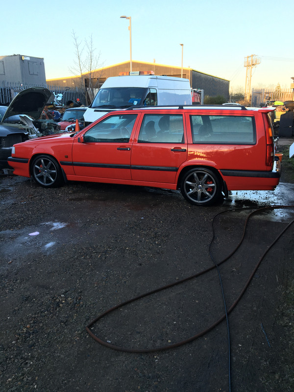

Well this weekend I decided to unearth the red rocket from my garage, the poor thing has been sat in there since it’s last MOT expired in 2019, also when my house flooded last February I loaded it with all my possessions & shoved it back in the garage. Last weekend I finally moved everything back into my house. Thick with dust, the poor old thing was looking like a barn find. So yesterday I popped a battery on it & took it to my workshop where it is receiving medication. After a well earned bath

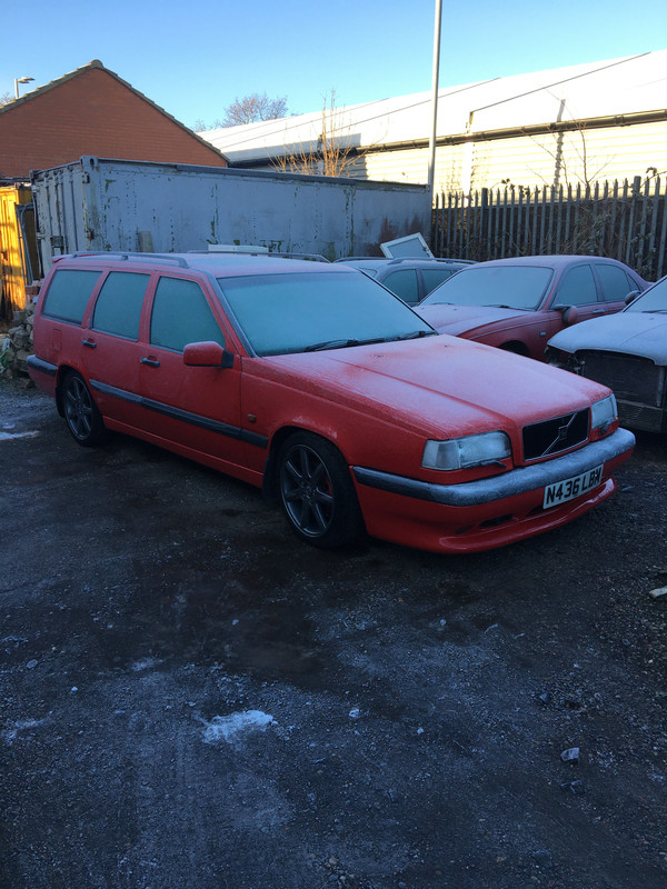

It was cool a bit this morning, but it’s a Volvo, it can handle it
